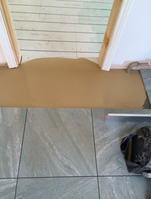

had another polypipe customer ask again a few weeks ago.
what we came up with was TM Rapid Level 30 over polypipe, TM Ulimtate
Credit Craig Powell for image.
