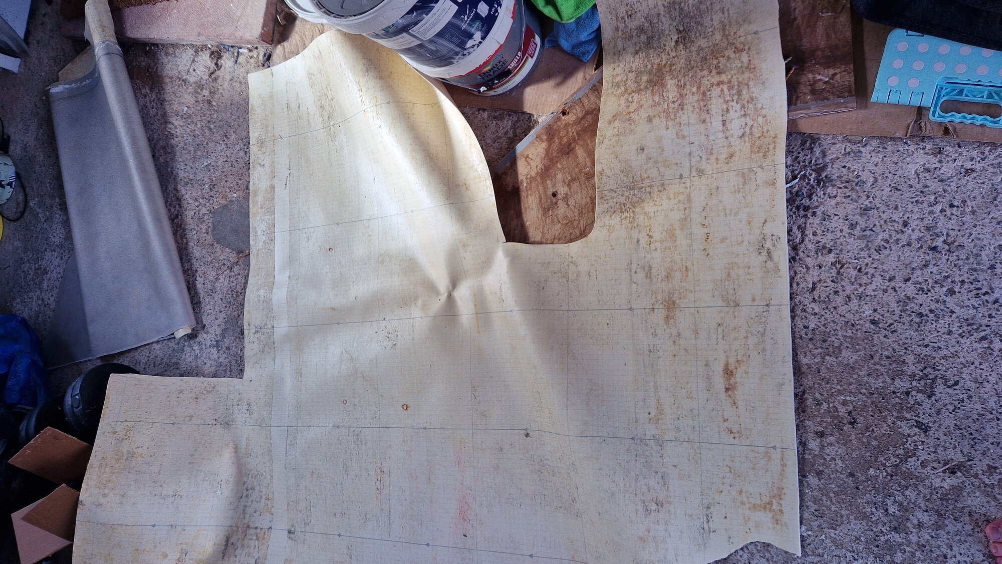

Fast fwd 12 months, pinky stains through vinyl. Took it up, mould on underside of vinyl.

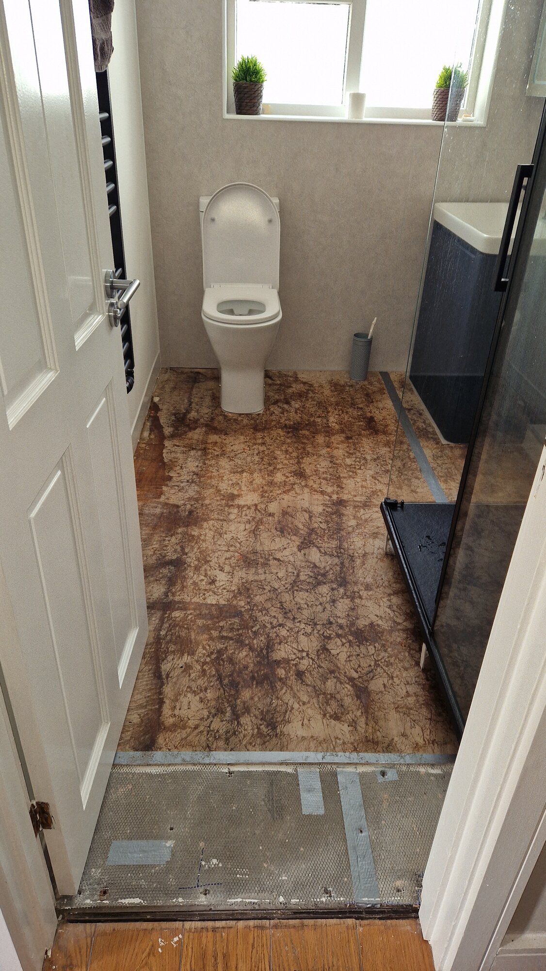

Took 6mm marine ply up, seems a bit brittle like it has moisture but nothing too bad. Bought floor hygrometer placed on backer boards and after 24 hours it's showing 75% (and it's been dry here for weeks).
So quite high.

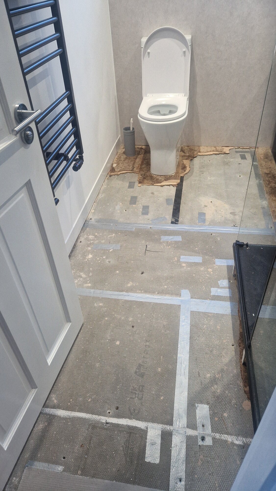

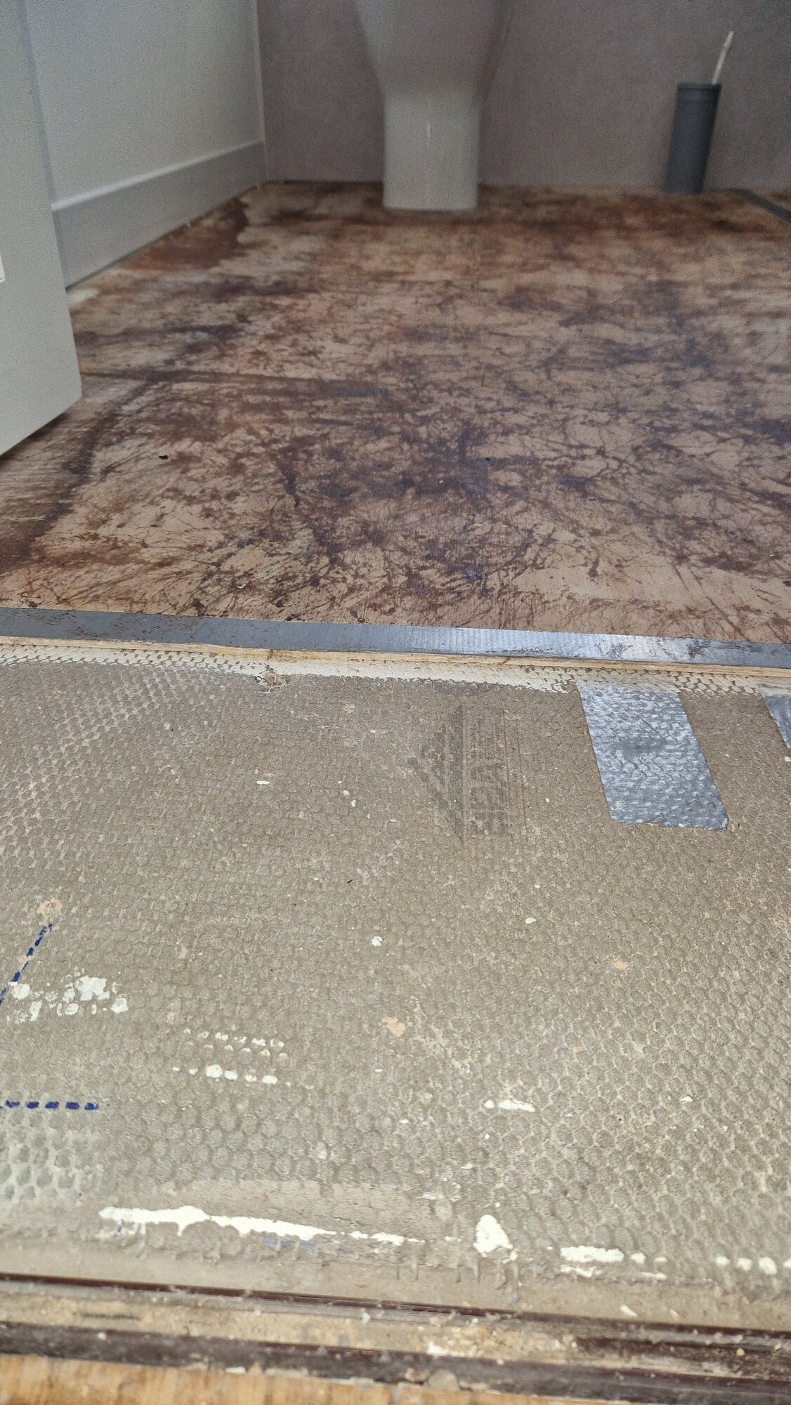

I know everyone will say take the tile backer boards up , lay dpm and put new tile backer then electric ufh then tile. But just checking if I can do anything else on top of existing backer boards....... 🙏 picture to show type of backer board as i was taking marine ply up. The stains on the top side of ply are just the old vinyl glue not water as such.

I've just removed the marine ply a minute ago. Ditra mat on top of those tile backer board still OK and will that stop the moisture coming up?
send picture
make sure the tile backer boards are well secured to the floor. Apply SBR then Ditra. Using Ditra mat will stop the moisture migration

Measured the floor with a floor hygrometer, rained yesterday and the RH on top of the boards was up to 82%. Seems to sit about 70% without rain.
Tile and vinyl say 75% RH maximum permissible level So I definitely need some sort of moisture barrier.
Tiler is recommending using some self levelling then epoxy resin on top to stop moisture.
Confused as to whether to do that or the ditra mat. Obviously the mat is easier.....
Thoughts anyone?
