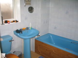

Only 3 walls to tile and for the first time I'm using 6mm ceramics (1st time since tiler school anyway) Only ever had porc + natural stone jobs. Can't believe how fast they are to work with.
Nice Pacific Blue suite:

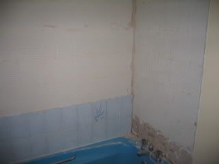

After scraping the worst of the old addy off the walls I skimmed the bathwall with rapid and over-boarded window wall. Also did left reveal to equalise the window frame a bit nicer:
