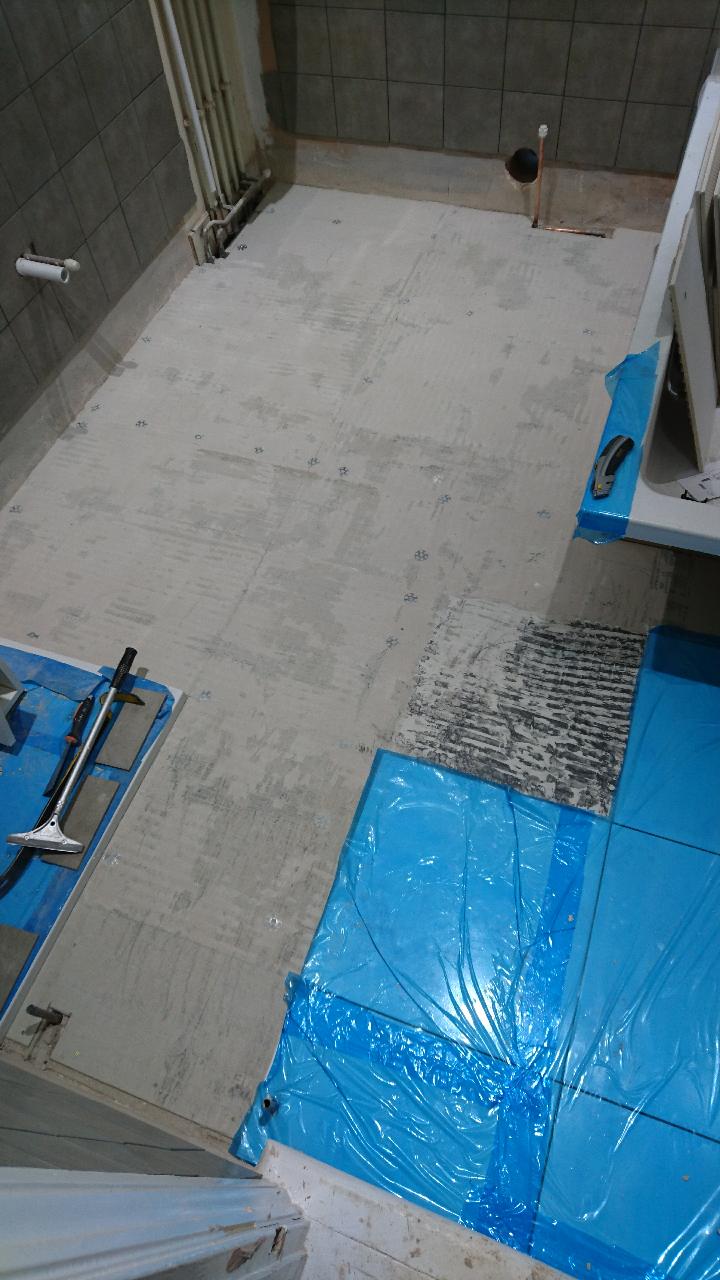

Came in to the room this afternoon to finish the wall to floor cuts and break off the lash clips on the floor tiles. As i was walking on the tiles I noticed that one of them sounded "hollow" like it hadn't stuck properly.
So I tried to lift it...
TO my horror it came up with just getting my fingers in the grout line!! Then the next one,,,, then the next one,,,, then the next one.... you get the picture.
I pulled up all the tiles, ONLY THE LAST COUPLE OF TILES SOUNDED SOLID, and wouldnt come up. These were laid with a different adhesive as I ran out of LARSONS so used BAL MAX FLEX standard set that I had a bit of. To be fair I thought I should have a go at getting one of the BAL laid tiles up so used a crowbar, which managed to lift the tile without breaking but a lot more pressure was required, so I left the last couple BAL laid tiles down (and covered them, they didnt turn blue).
Interestingly the cut tile that I laid, which I applied adhesive to the back of the tile only and not the floor also came up easily but all the adhesive had bonded to the tile, and not the floor? The opposite to all the other tiles?

So after spending the afternoon scraping all the tile adhesive off the floor (the 1 tile laid with BAL adhesive was much harder to remove off the floor), tomorrow I will go back to re-lay the tiles as the backs of them are clean as you like, with no adhesive stuck to them.

Doesn't look like you've pressed on the tiles much at all for the adhesive to key. Those ribs of adhesive still look incredibly straight.
You're meant to push down and twist the tile into place so you squish the adhesive I to a solid rather than leaving the tile resting on ribs of adhesive. You need 100% coverage. I'd perhaps leave the lash clips out, they will give you the impression the tile is fixed well when in fact it may need more adhesive under it.
Somebody skilled would be able to work it out as they drop the tile but somebody not so would leave ribs like that.
12mm trowel, no less, if you mix right and you prime the floor and back skim, you shouldn't have any problems. Not too stiff a mixture, lift a tile once you have stuck it to see what's happening and if it's doing what you think it's doing!

It's a perfect example of why you need to 'burn' the adhesive into both surfaces.
Where you've troweled the floor, the tile has come up clean, and where you've troweled the tile, the floor is clean.
So if you'd have troweled both, then there'd of been less chance of a failure.
Still no guarantee tho, as your adhesive mix is clearly too dry.
Twisting tiles is never going to achieve a solid bed, and frankly it's impractical, you need to move the tile perpendicular to the ribs of the adhesive on the floor, and the wider the notch, the more you need to move it. And when you start using larger formats this can prove difficult.
