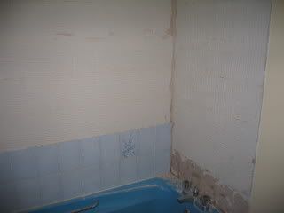

Nice Pacific Blue suite:

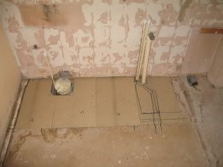

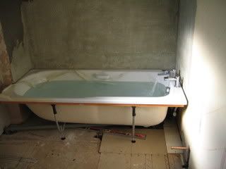

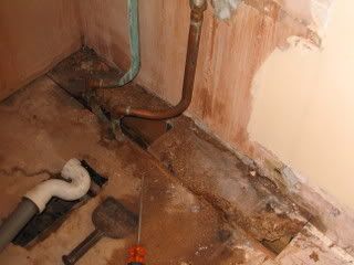

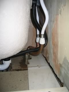

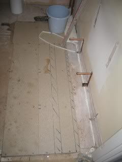

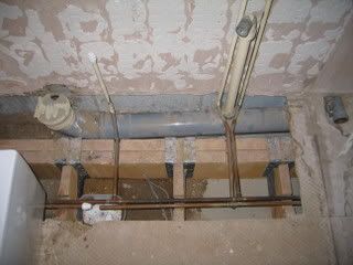

Lot of water damage from old bath pipes, floor was rotten:
Old Rad was microbore and had been weeping under the floor for a while.

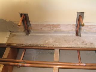

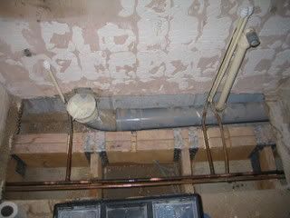

Didn't use reducers as I wanted rid so swapped the T's and routed 15mm out of wall ready for towel rad:

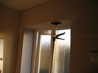

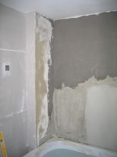

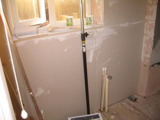

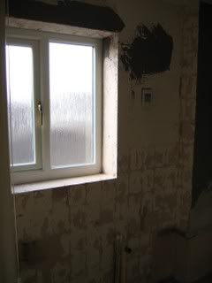

After scraping the worst of the old addy off the walls I skimmed the bathwall with rapid and over-boarded window wall. Also did left reveal to equalise the window frame a bit nicer:
The hot water feed had to be cut back under floor and resoldered to new position as there was no straight piece of pipe for the push-fits
(If Ram or Wivers read this - THAT was the The pipe :lol🙂

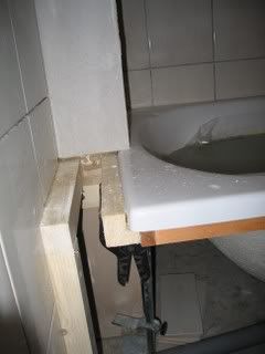

Bath screwed and blobbed in place, then tanked:
NMP down and made a start on framework for bath panel:

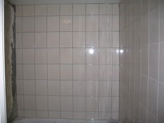

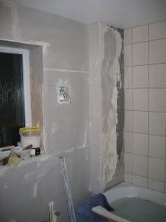

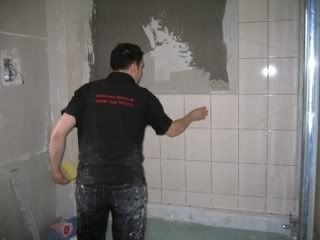

My usual motto for tiling is 1 day 1 wall but I did 2! :hurray:
Look at me go, I'm smoking :lol:

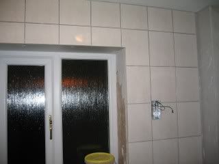

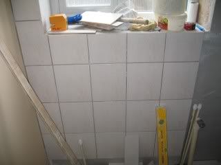

The boxing in was 'twisted' and needed quite a bit of skimming.

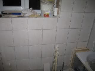

I'd set out all nice to balance all 3 walls and avoid the slither cuts in this area like before but that meant me knocking the window out of center by an inch but the customer was adamant the window should be centered and he did not mind slither cuts at all.
After a bit of a debate I suggested I add a couple of more pieces of plasterboard to the side of the boxing in and he could have it centered.
I did this and also moved the shaver socket over to the left so he still had room for the mirrored cabinet he had bought.
This was at my time and expense - Should I have just set out like he wanted or is it best to do what you know is right?
Finished the day making new framework for shelf:
Wish all baths had such deep wooden frames - makes a tilers job a lot easier!

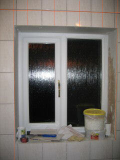

Hi, Here is an alternative way to centre a window. I personaly hate L-cuts on Doors and Windows.I hope you don`t mind.Centre the tile to the middle of the window, and cut 2 tiles ,to the sides(Big cuts).Easy to keep symetric.But at the end of the day the customer was happy with slithers.Just another alternative to offer.Enjoy your break:8:2Balls

Indeed 2balls, always 2 centres, 1 down edge, 1 down middle.

Not sure I like the shortened tiles - may center window but loose symmetry in the field tiles. Also don't like the idea of cut against rectified edge but thanks for all the input guys it's much appreciated.

Aflemi,Maybe you miss understood me, the main feature is the Window,by taking the right hand edge of the Window,leaves you with cutting about 2 to 2,5cm off a whole tile in the right hand corner. You then centre the Window,not the wall.Or have I missunderstood you.Maybe I`ve been here to long!
:8:2Balls
Ah right, I think I see what you mean now (red lines overwritten not 100% clear to me). Ok so you would have 2 cut tiles in the middle of a run, at each end of the window?
Hi aflemi, Your right the red lines are not that clear, so here`s another
Fair enough mate,the other alternative would be to board out the sides and have no cutting ,as long as you can open the Window!!. Anyway the customer was happy with slithers so it does`nt matter :smilewinkgrin:2Balls
Re windows..... I was in germany for 3yrs they have a rule which you must follow goes like this
No cut tile may less than 50% of the tile size.
In a window or door situation
full tile from edge window both sides working in towards centre then a cut tile up through centre, if the cut is less than 75% of tile size, you reduce the size of the 2 centre tiles that make sense

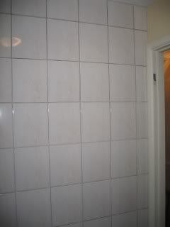

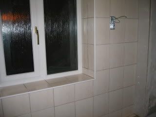

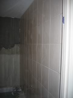

Well this is how I did it to center window and not have slithers at wall edges:
Looks okay mate,if the inside of the window is under 26cm (trim+ grout+silicon) could of saved your self a lot of cutting. Main thing is, your customer is Happy and so are you! :smilewinkgrin:2Balls
