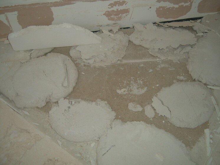

Odds 026.jpg Odds 027.jpg One I looked at in Collingdale
Sorry, but this whole **** up is down to the builder and his total lack of experience. No wonder he's saying its a no no to rip the lot out and start again, but we all know, as I suspect you do, that, that is wot is needed, and you won't be happy Until that happens.

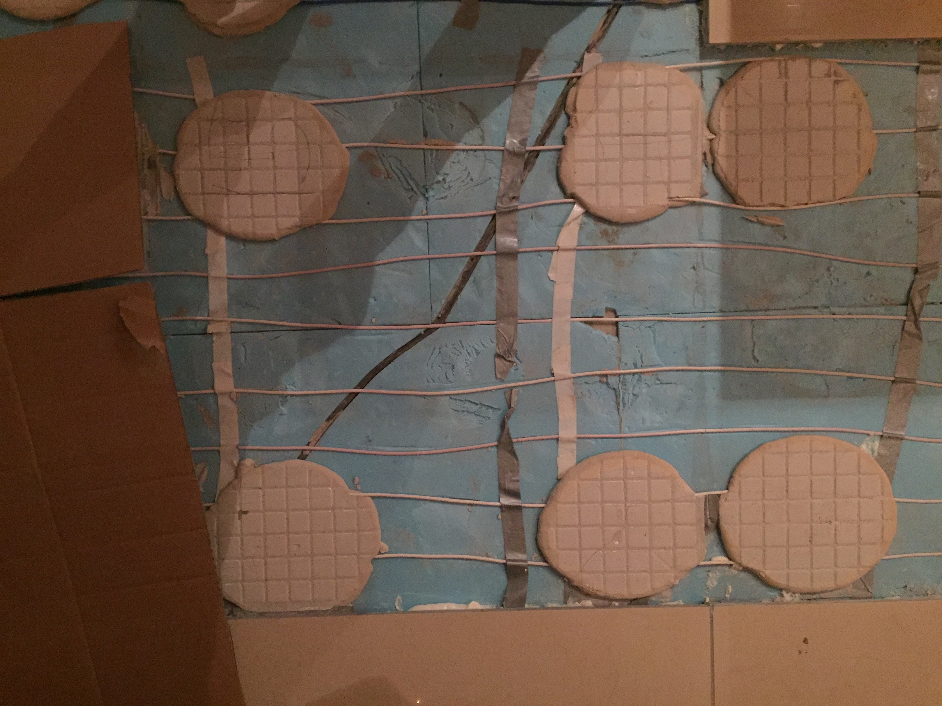

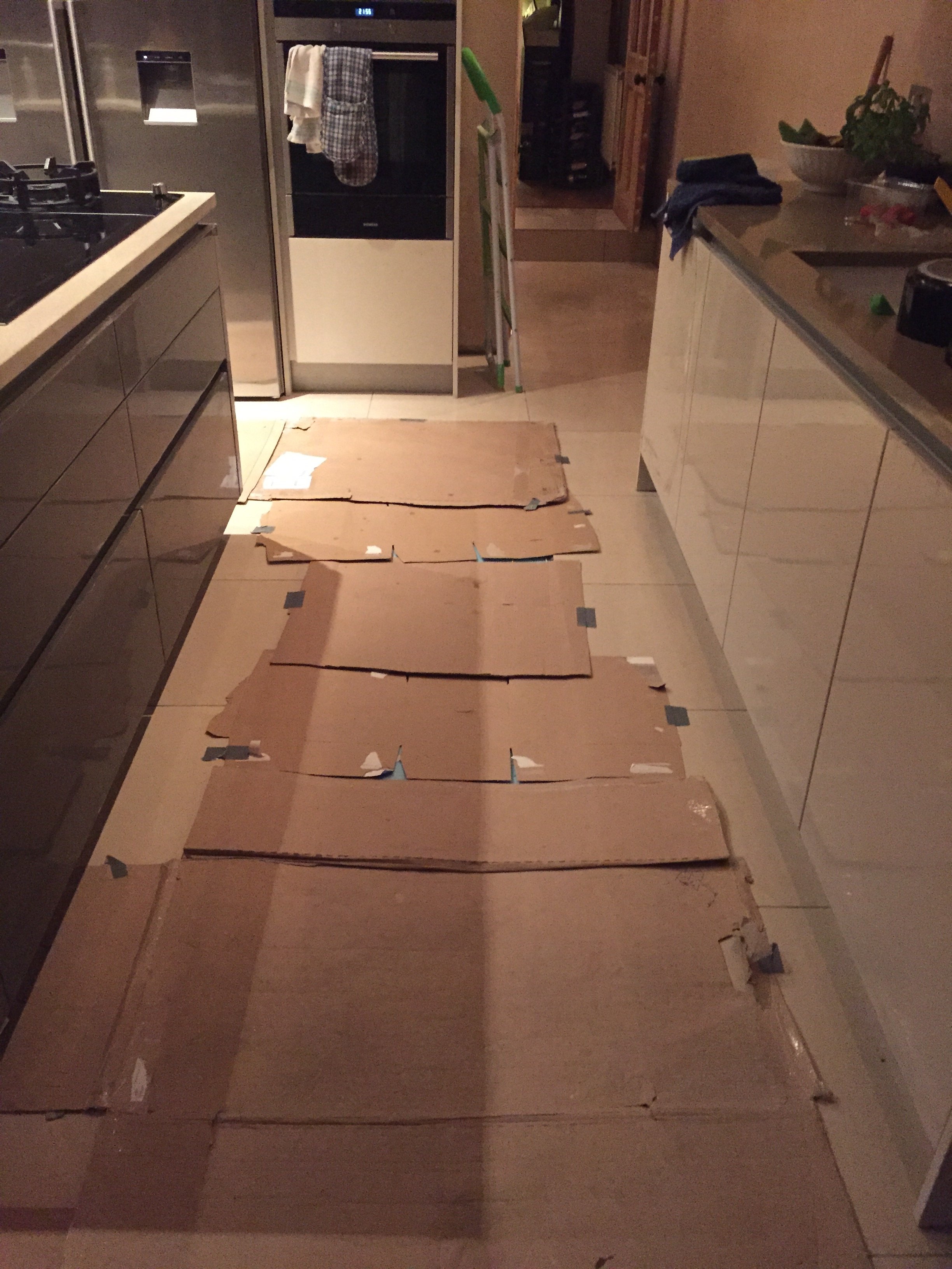

As promised some pics - so embarrassed, no-one's tidied up!
First is the dot and dab and UFH cable for everyone's entertainment. Next two are really just cardboard over where the tiles are up. Just shows the extent of the job really - it's a 5m x 5m square with a passageway of one end. 4th is what I'm worried about with end panels which probably have stone stuck to them 5th is the end of the island. Last is showing a tile space with all but the corner dots lifted off the cable and insulation. The genius idea is tile adhesive in the larger space between the corner dots, ridged a bit then Gripfill on the dots. Adjacent tiles not lifted to have foam injected under then as much adhesive pushed under the edge as possible. You probably gathered I'm not crazy about this idea.
Enough said really

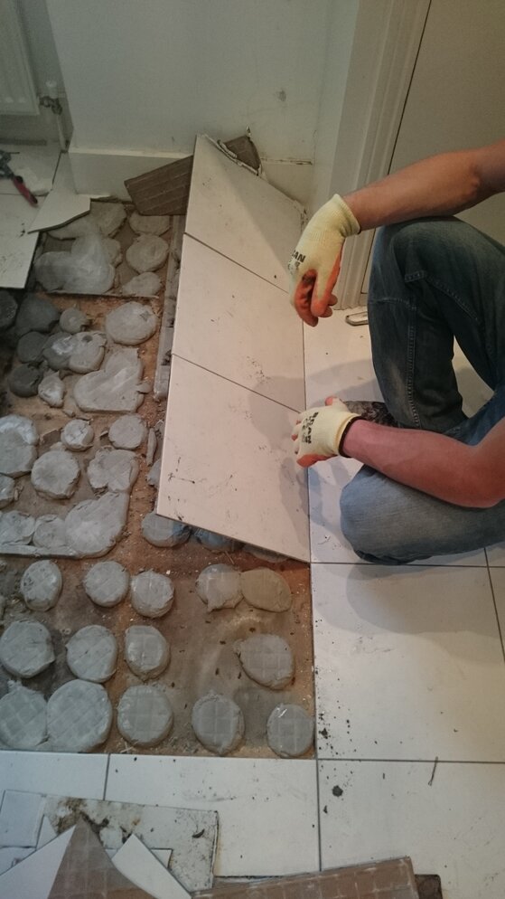

not the best pics but this was tiled with the island and kitchen in, granite work tops ect, and these were 1200x600 🙂

not the best pics but this was tiled with the island and kitchen in, granite work tops ect, and these were 1200x600 🙂View attachment 73128View attachment 73129
