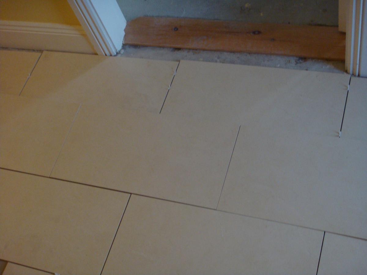

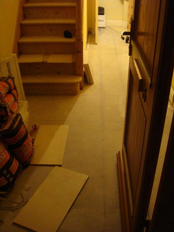

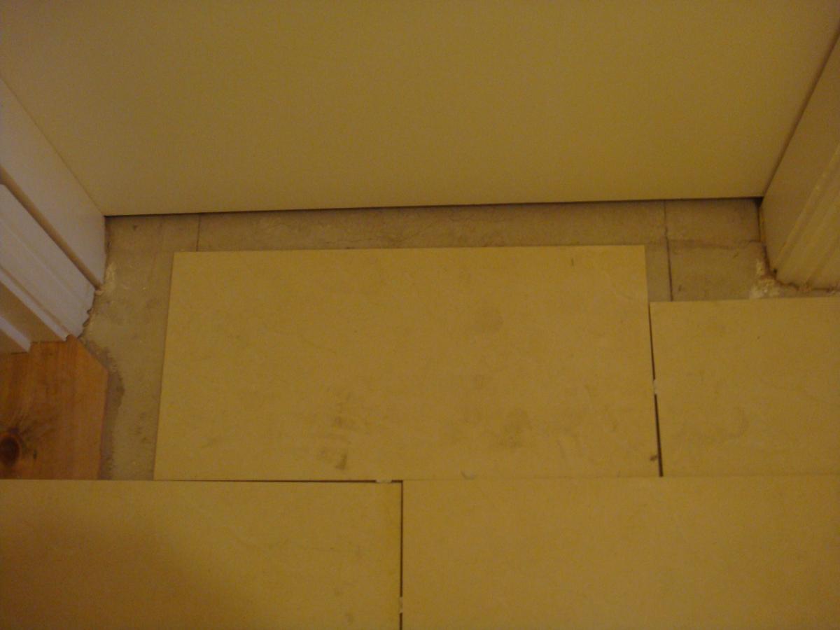

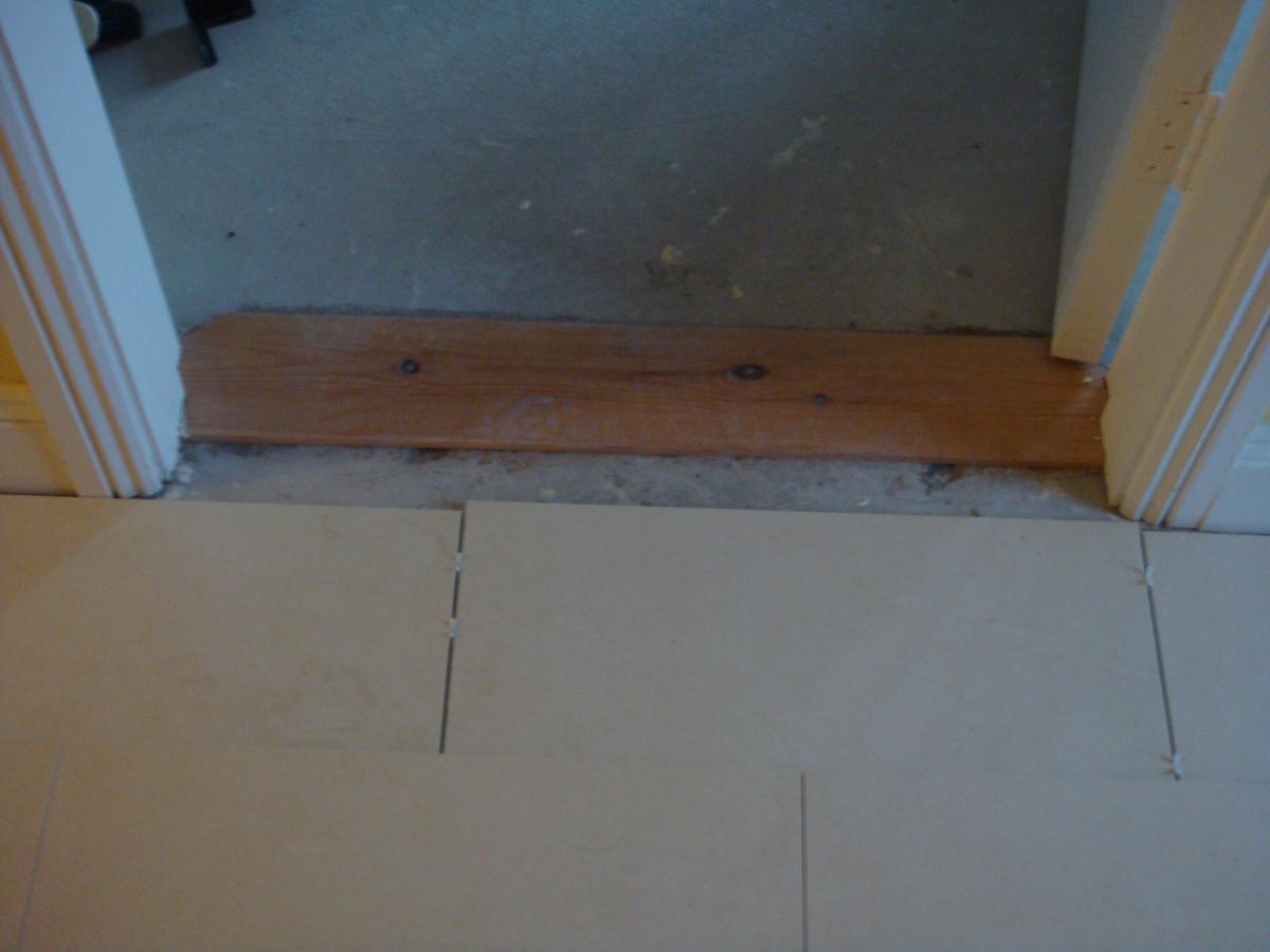

Here are some pics some pics were to big to upload.
inside front door 21-30-30-30-30-30-25
just inside front door room to right full tile finishes at saddle of door way im thinking i will leave this as wood floor going in that room??
narrow part of hall 24-30-30-30-25 as you can see in pic doorway with no saddle is kitchen which will be tiled
i wanted to have tile centre of doorway but full tiles fit perfectly to the stairs.
inside the kitchen the tile along the wall parallel is 20 and last on far kitchen wall is 22

first pic is run into kitchen saddle on left is bathroom will be coming up.
2nd an 3rd are livingroom skirting kept tiles out from saddle skirting is off now
straight ahead is small toilet , first door to right is living room and the second door end of hall to right is kitchen
