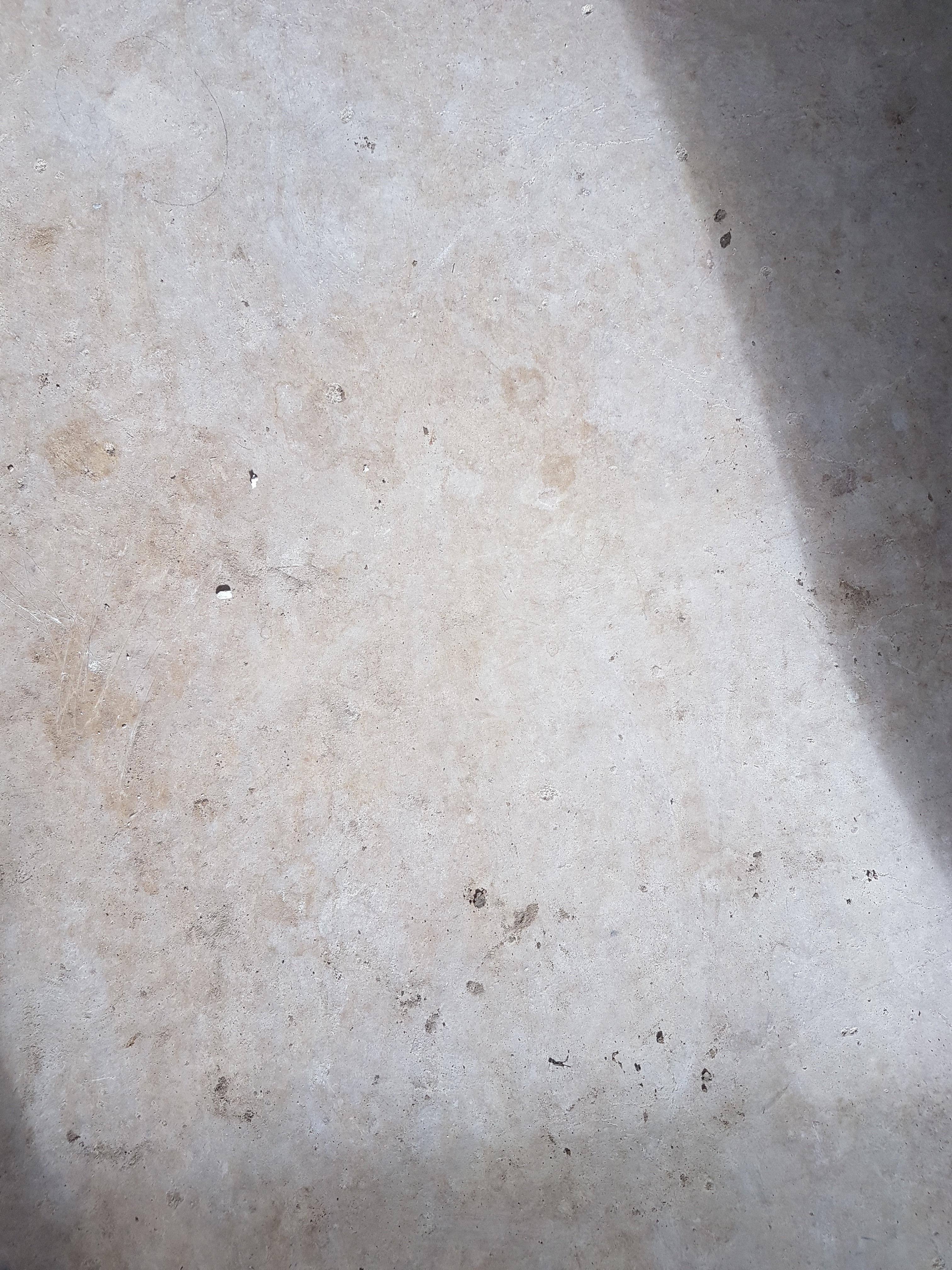

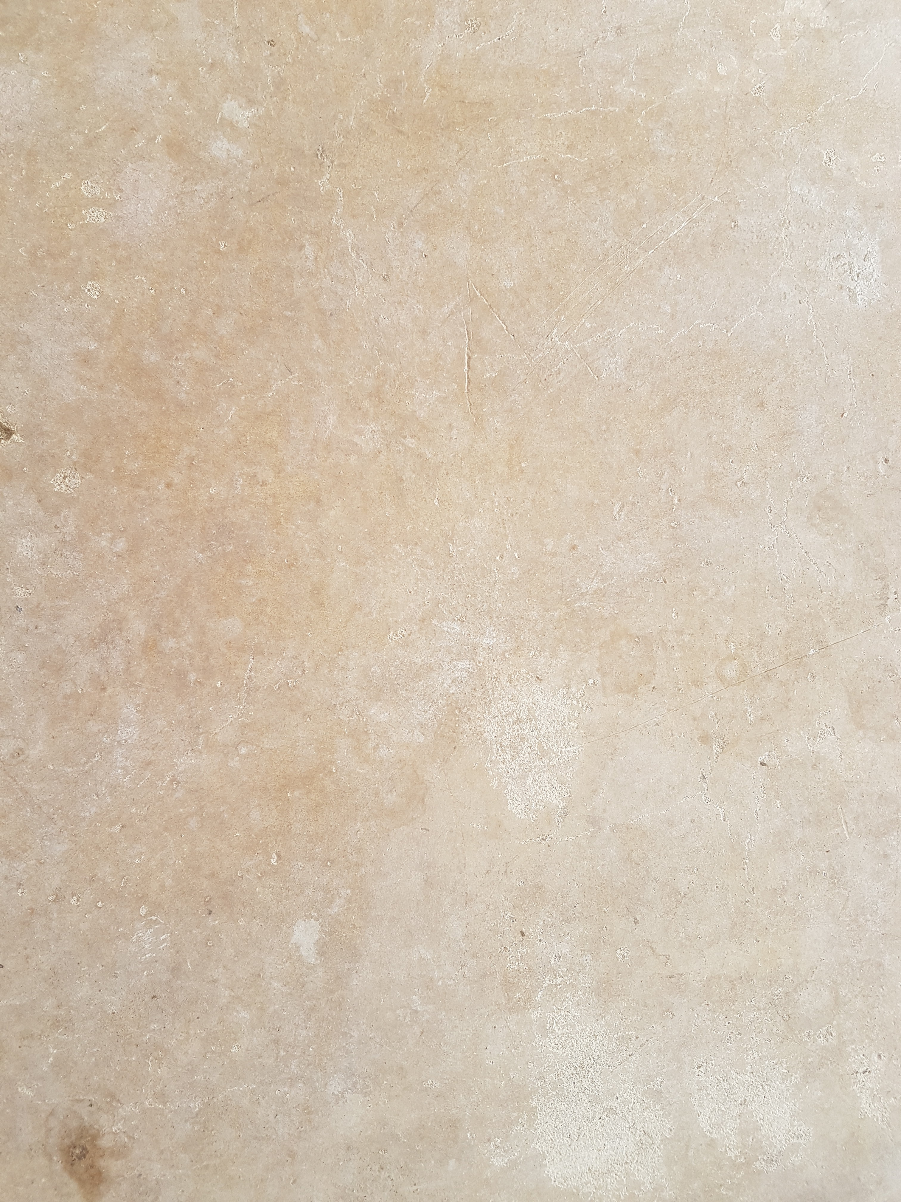

The builder assured me it's been sanded & laitence removed all bar one room. I'm on site today and they've got a guy using an electric hand sander with 80 grit paper. I don't think that's manly enough, how can I tell if the laitence has been taken down sufficiently?

You will struggle to get the laitance off with a hand sander after this amount of time. Laitance should really be removed much sooner...... around a week or so after pouring depending in drying conditions, thickness etc. Any pics?
In the shadowed one is how the majority ofnthe floor looks, in the other you can see a small lighter patch where i had scratch at it with a key.

You really need a floor grinder ! I bought an errut PRM twin disc grinder that takes 6 no carburundom blocks you will need to go over whole floor up to edge as close as you can ! Basically it looks like it's power floated and when you get laitance off it looks more like screed ! You can hire grinders at hire centres mine is quite easy to use and fairly gentle some of the single disc ones are a bit aggressive and can dig divots in the screed ! Also may be an idea to get the screed company to send the rep out to do a carbon bomb test to check RH is low enough ! I've spent a lot of times exploring this animal lol worth the time though ! Good luck Dave
That to me looks like it needs sanding, and I don't think anything other than diamond disk will do it
Thanks for the replies, I've had someone out to inspect it, an old school friend in the flooring industry, who confirmed it needs sanding properly with a heavy duty copper teeth wheel or suchlike!
