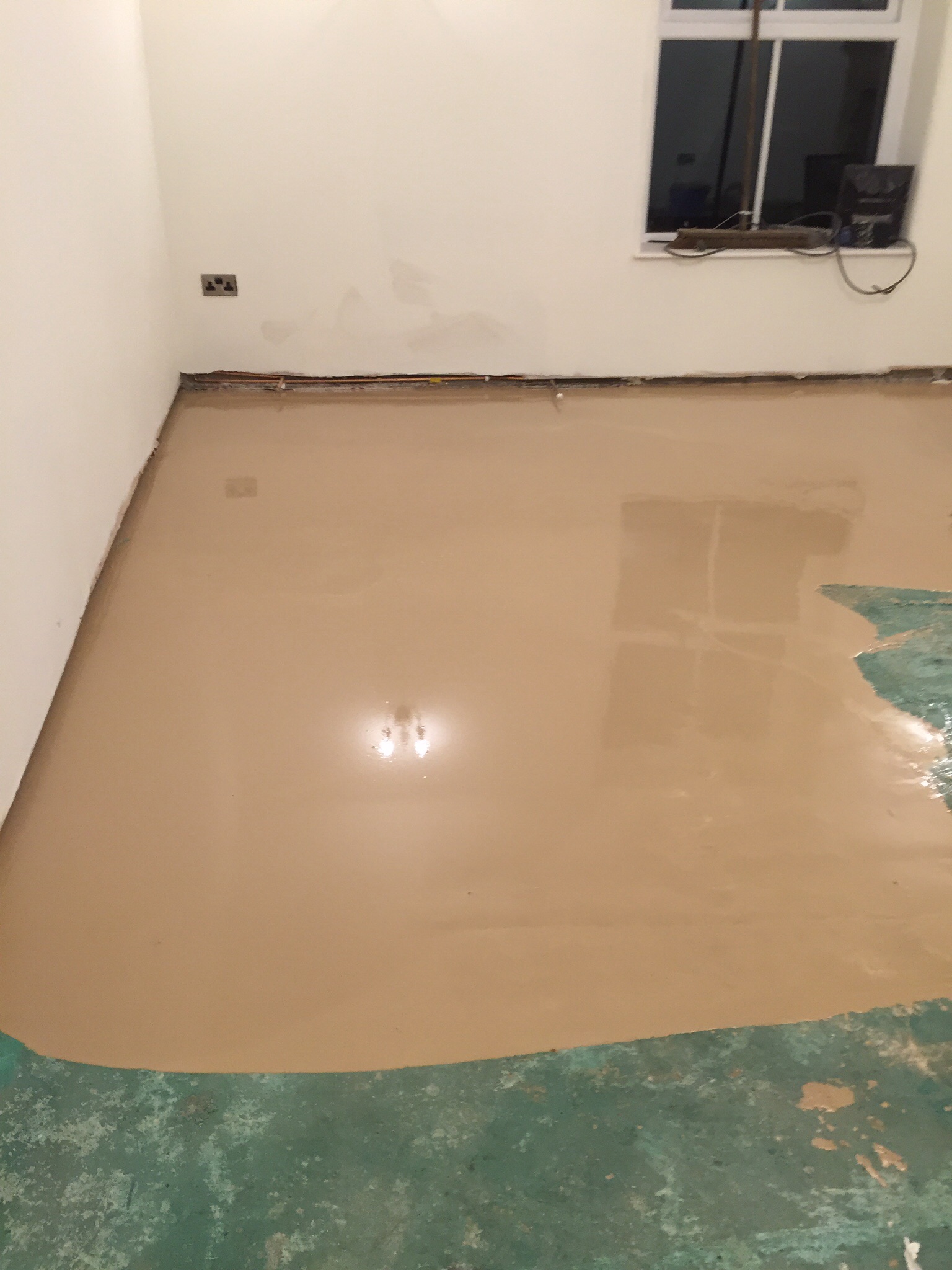

Can't see how you get full coverage in picture no. 2 looks like a dogs took loads of poo's on the floor..lol

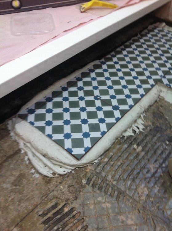

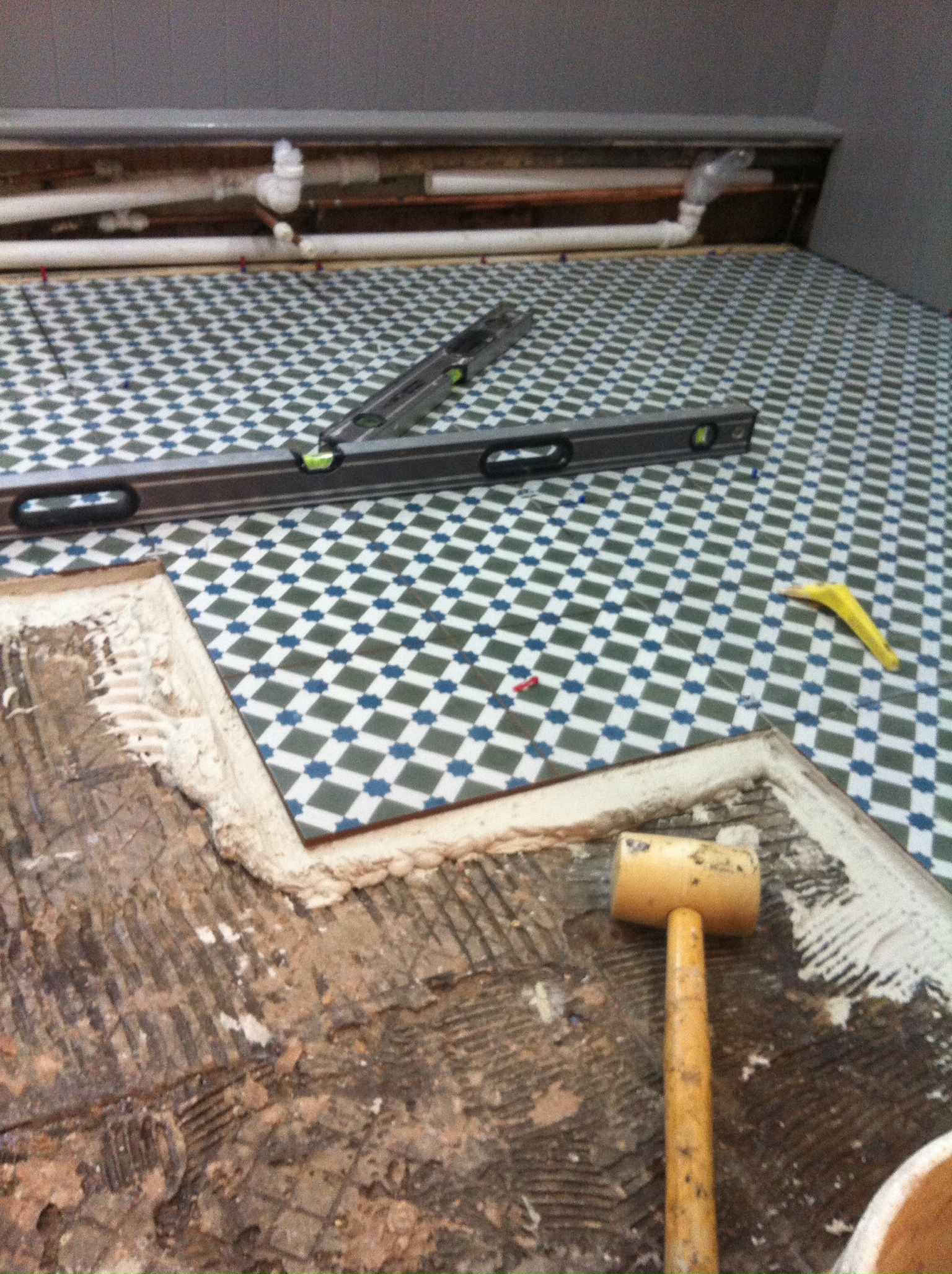

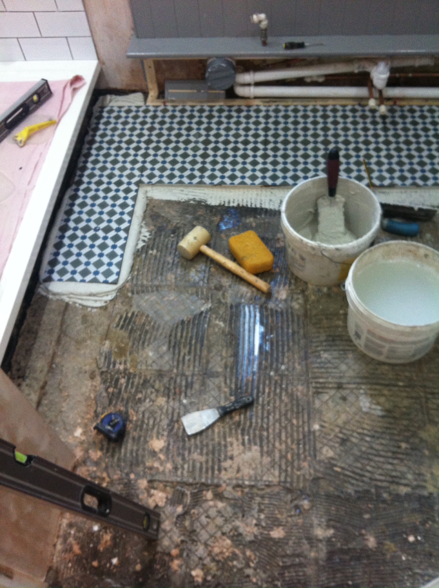

Here you go Andy, is this all right for you? 😛
Tiled in 3 hrs in lovely slow set adhesive, as I never use rapid as you know.
Incidentally that would have proved fatal, as I had to slightly adjust the position of some of them after each row progressed, which you would never have done with rapid set.
Just got to grout up on Monday.
So there you go.

Do you use a lot more adhesive @steveboy using your cowpat way? I guess savings on slc offset it though.
View attachment 78583 View attachment 78584 View attachment 78585 View attachment 78586 View attachment 78587
So there you go.
As I said earlier, you can self level if you like 😉
Is your adhesive manufacturer happy for you use their tile adhesive up to that depth?
Dose it take longer to go off at that depth @steveboy
Oh yes, definately.
I tiled it today, but no-one will be going on it until Monday.
Even then, I'll check it and if not dried I'll give it another day etc.
Joking aside, and I have been having a bit of a laugh here, but with these tiles they have like a fake grout joint running through the centre.
Now, I set them using 2.5mm spacers which was fine on the first row, but on the second row to get the fake joints lined up was fine, but one or two tiles were actually smaller in size, so needed tweaking to position as best as poss.
With rapid set, you wouldn't be able to have done this as by the time you'd laid the first row, gone back started the second you wouldn't have been able to move any in the previous row.
So yes, I always use slow set on floors no matter what anyone else says.
How can you guarantee your work when you exceed the manufacturer recommended thickness of adhesive?
Right ok, so another change of topic then - no probs.
With this addy, I have done loads, and I mean loads of jobs this way - but for sure no more than 20mm in depth, and never had any issues whatso ever.
If that was the case, I'd lay some off cuts in first. Or use some cheap B & Q tiles etc.
So far I've stopped myself getting into this with you but the fact is the way you lay floor tiles is wrong...
The recommended way is to lay a rib of adhesive using a notched trowel and fixing the tile using a twisting motion back buttering the tile will unsure an even better bond, any uneven floors should be leveled using a suitable slc so the recommended thickness is adhered too.
Any adhesive manafactures pdf will say exactly that and if you can show me one that recommends packing b&q tiles under them to build up the floor or blobbing down cow pats of adhesive to lay tiles then I would love to see it..

You can't argue with the pictures I have provided, all tiles are laid on a solid bed of adhesive, just thicker than the norm.
