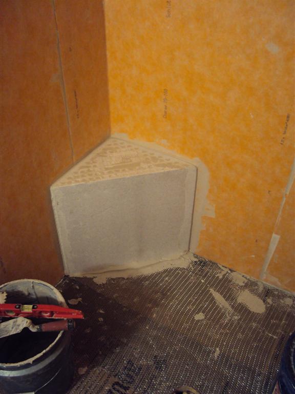

FYI, if you use Schluter Kerdi to waterproof showers, they now have a corner bench. It's made of the same material as the Kerdi curb.
I'll have a picture on Monday of the bench covered in Kerdi and ready for tile.:thumbsup:
I had this bench installed in about 5 minutes. I then spent about 30 minutes covering it in Kerdi. Compared to the "old way" of building benches (block and mud), this thing is a bargain at ~$100.

Jay, it's the same stuff as the curb...some sort of foam.
Believe, I was a hold out for years about the curb, and then finally stated using them and now I think they are great. I'm sure I'll be the same about the bench.

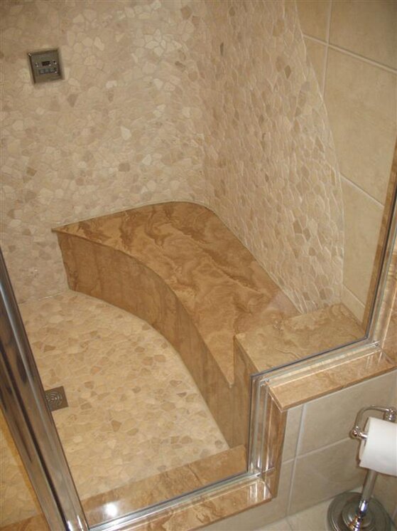

I think I posted this one before...this was a bench and shower that was all mud and block. This bench WAS built for two, at the request of the client. LOL.
lovely looking job Rob:thumbsup:

Haha....that one's not big enough for those activities. :lol:
Nice looking shower, bespoke work. Good on you Rob:thumbsup:
