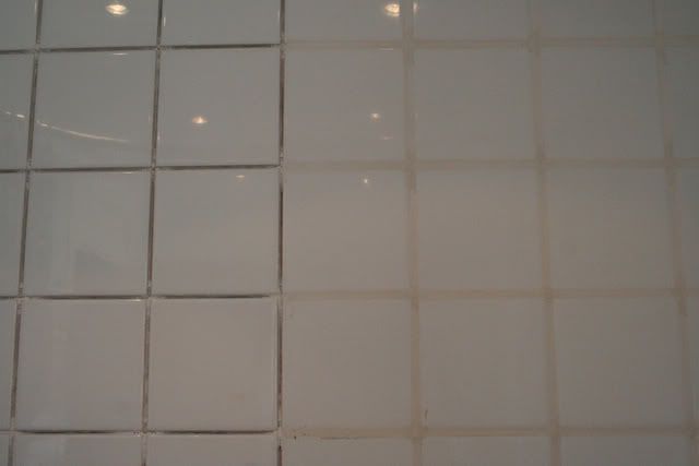

FYI - this is how bad the grouting was and some of the bit I've dug out (does that look ok to regrout?
I know!!!! I have hated it since it was done!! :whatchutalkingabout what a stupid idea in the first place and it made it so hard to clean, as grout looks cr4p anyway IMO!

That will look fine i think , once you grout up....and as for you never thought you would find your self on a tile forum...then thats wot they are for....and you came to the best one........good luck and look forward to the photo's of completed job.......
