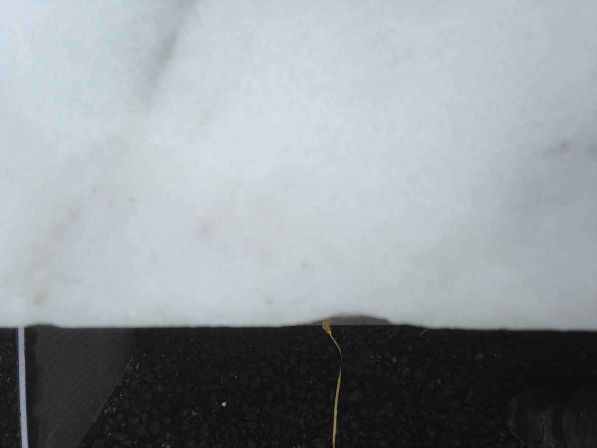

problem is that the edges have alot of chips.
I advised the supplier as soon as we started taking out .
we spent two man days sorting the crates in to what i deemed acceptable or not for first 100 sq mts and came out with 70% being ok to lay as whole good tiles.
we subsequently laid 100 sq mts in kitchen but when grouted the joints have a general ragged nail tear for want of better word.
just looks very poor
what happened when grouting even though we did double swiss grout and got joints flush is that the nail tear in marble was far more evident after grouting than before.
i believe the nail tear is caused by the mica popping out of marble when it is cut and indeed this is apparent on face as well.

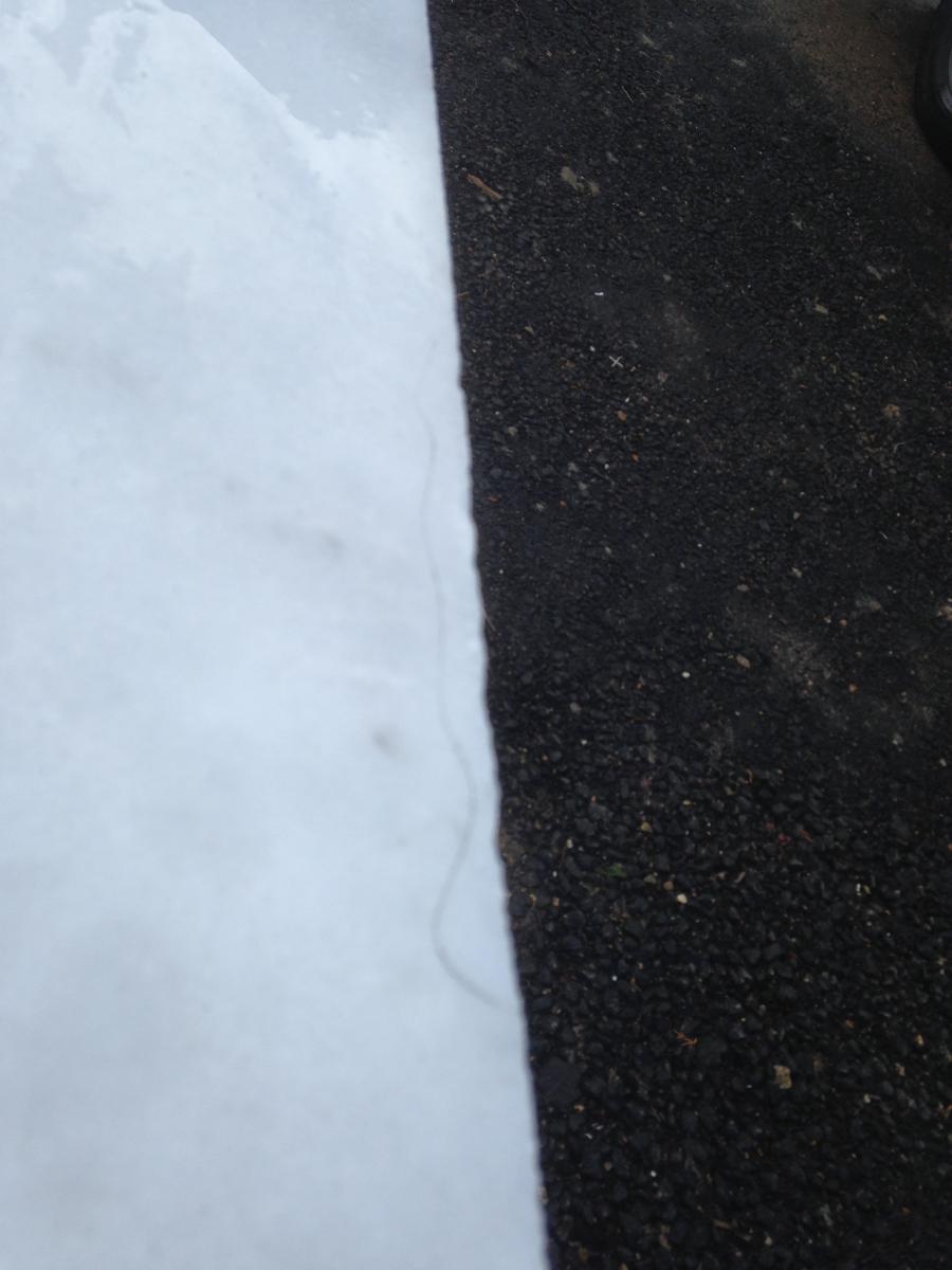

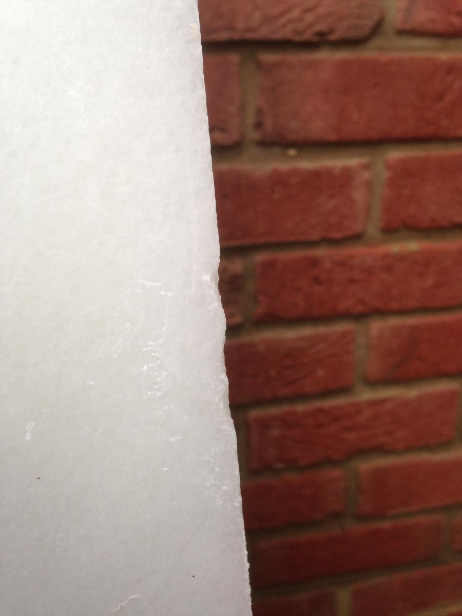

i post a couple of pictures below that show the bigger chips but i think it is in the nature of this marble that even with a straight cut the mica just falls out. is this accpetable or not. it does not look good to me

Client does not really know what is acceptable or not.
but I laid out 40 tiles for inspection and showed the spectrum of colour and edge detail supplied.
Not sure if I am being too picky about chips .
would be to big chips for me. Did tiles came to site like this? sharp edge should be taken off, when cut. (before delivery)
Photos show the chips I deem unacceptable .
i will show you more pics of marble that looked good when laid but pretty naff when grouted.
I did same stone 2 years ago, from turkey- same problem. And some of them was up to 7mm out of square (600x600x20 tiles) :mad2:
That's poor!
I wouldn't accept it.
Personally if its micro-chipping and you need to be closer than 1 foot away to notice I'd maybe accept it on a floor, but that looks like you'd see it clearly from 4 or 5 foot away.
Put it this way, if you were doing a cut and the edge ended up like that, would you fix it or do it again? I'm fairly sure I know what your answer would be!
