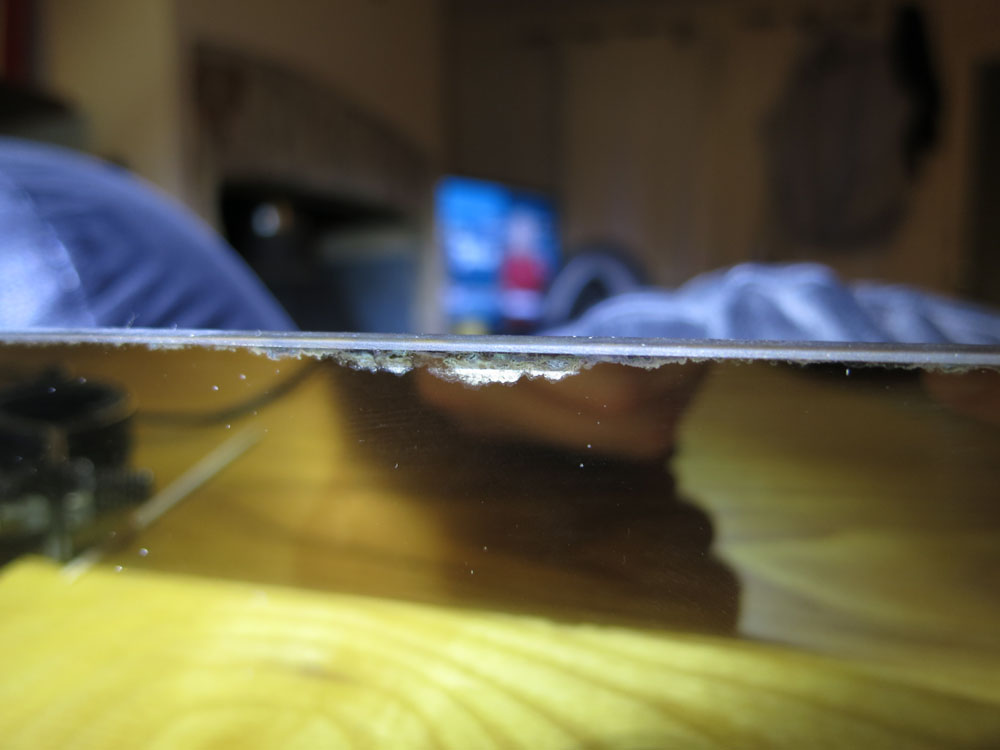

I'm about to tile my bathroom wall and I want to fix a large (roughly 3' x 4') mirror to the wall and tile around it. I have the mirror (just a plain sheet of glass with silvered backing - no frame) and the tiles. What I can't figure out is how to trim it around the edge. I'm reluctant to just butt the tiles up against the mirror partly because I don't think it will look right and partly because the mirror is old and although in otherwise good condition the silver backing is a little tatty at the edges.

It's a good thought. I don't think it will hide the dodgy silver backing at the edge though.

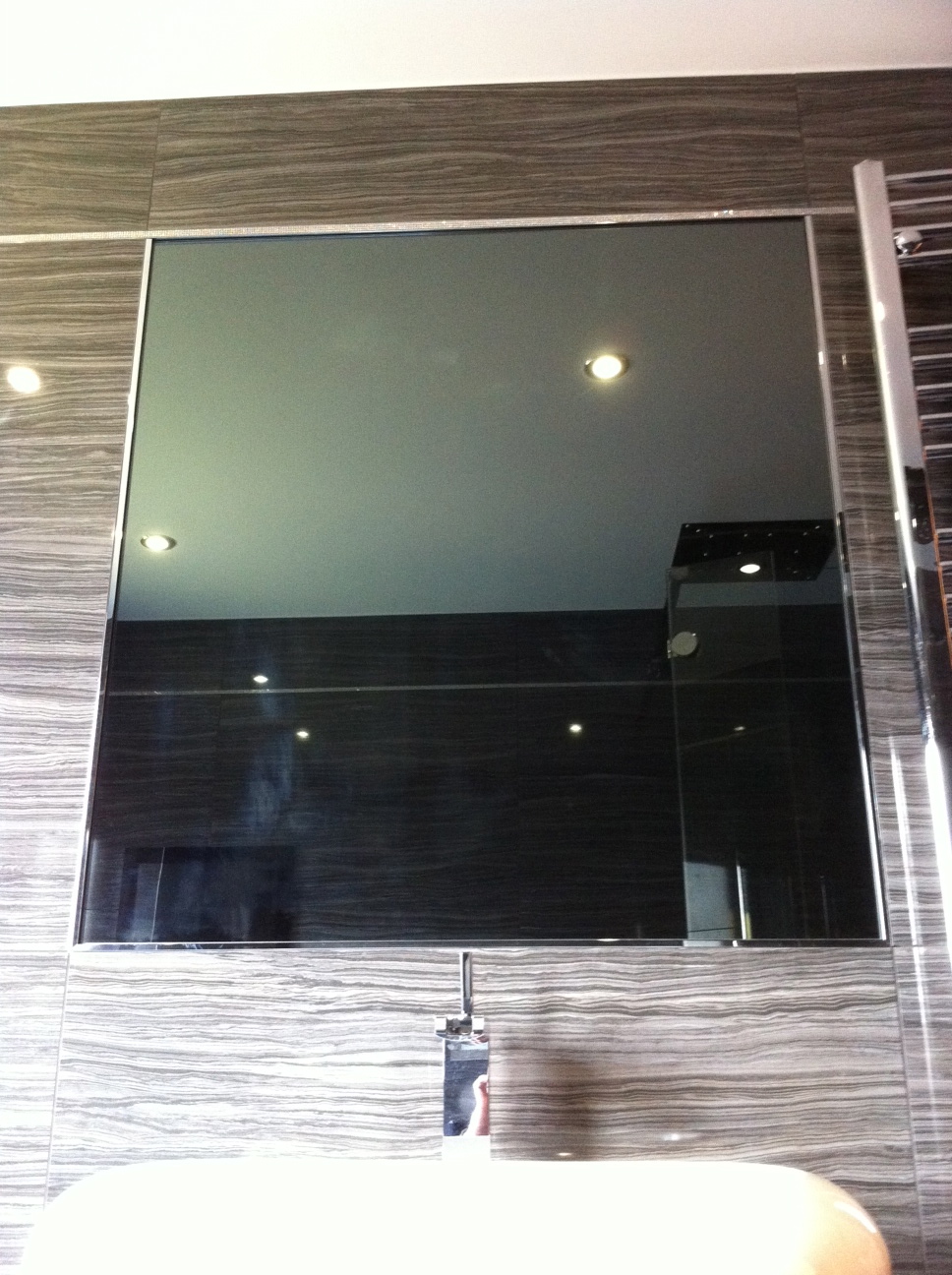

Done exactly what you're trying to achieve, although the mirror was cut to suit to 'hole' created by the tiles. The top part was actually a trim with Swarovski crystals that went all the way around the room, but the rest of the sides were just polished 10mm box trim
