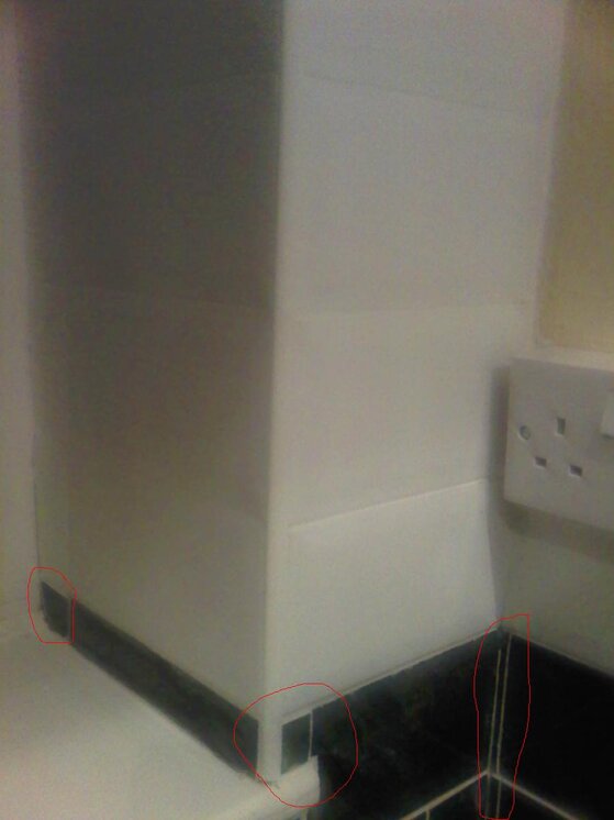

I have been really busy so haven't had the time to update. I took 2 quick snaps when I got home last night (photo quality isnt great as it was dark) - the wall tiles i presume are completed now.

The pictures are not great as you say but its still not right is it? You cant fix a job like that no matter how hard you try, if as in your case the setting out was wrong then thats one of the fundamental rules broken, no amount of changing tiles will remedy this work.
It all has to come off at the 'builders' expense then get a real tiler to do the work chargeable to the builder although I suspect that wont happen.

Hello Riviera, Ive had a quick browse at your pics, and would advise you not to let anymore "tiling" to be done by the "builder".
Judging by the standard of tiling, I would also stop the builder from carrying out any more work of any description.
This work is potentialy dangerous.
