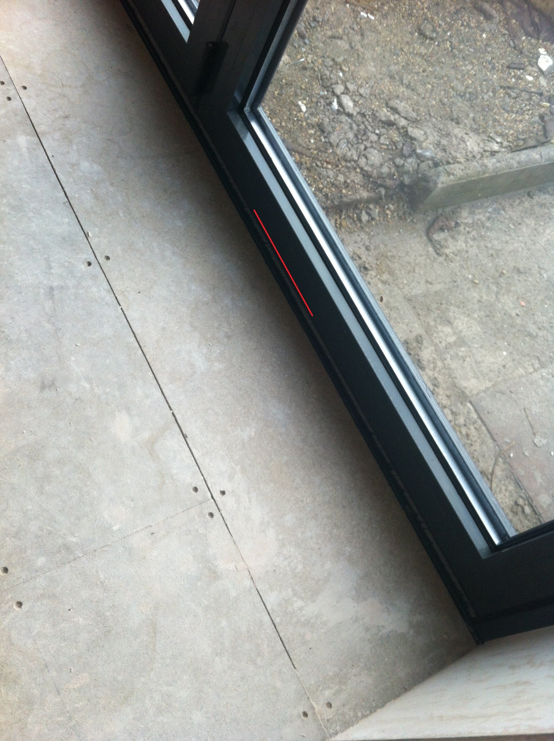

What is the height of the door above the boarded floor? I know I've already asked, couldn't tell from your image. Must have something you can use as a reference.

Well yeah I was going to use a 5mm edging strip and tile up to it, so the only issue will be that the finish floor level will probably be where the red line is on the pic, the doors open out, so that is it really.
That last wooden board up against the door, what are the dimensions of it? does the near edge line up directly with the corner of the wall (bottom right of the pic)? and can you unscrew it, lift it up and show us whats beneath?
I'm wondering if it can slope down to the door to a small degree by chiselling down whatever is under it, bracing it, screwing it back down, then tile/insulation joints sitting directly above the joint in the board and fill with colour matching Silicon to cater for possible movement?
Not seen it done before but could be a realistic possibility....... couldn't it?
Underneath the board is new joists, and 100mm insulation foam,
Yes i believe that board does go along to the wall, It's an idea, but I'd like to keep the floor as level as possible, with an already hard task I'd like to try and keep it as straight forward as possible, it might not come as far up as the red line, I'm just guestimating atm.

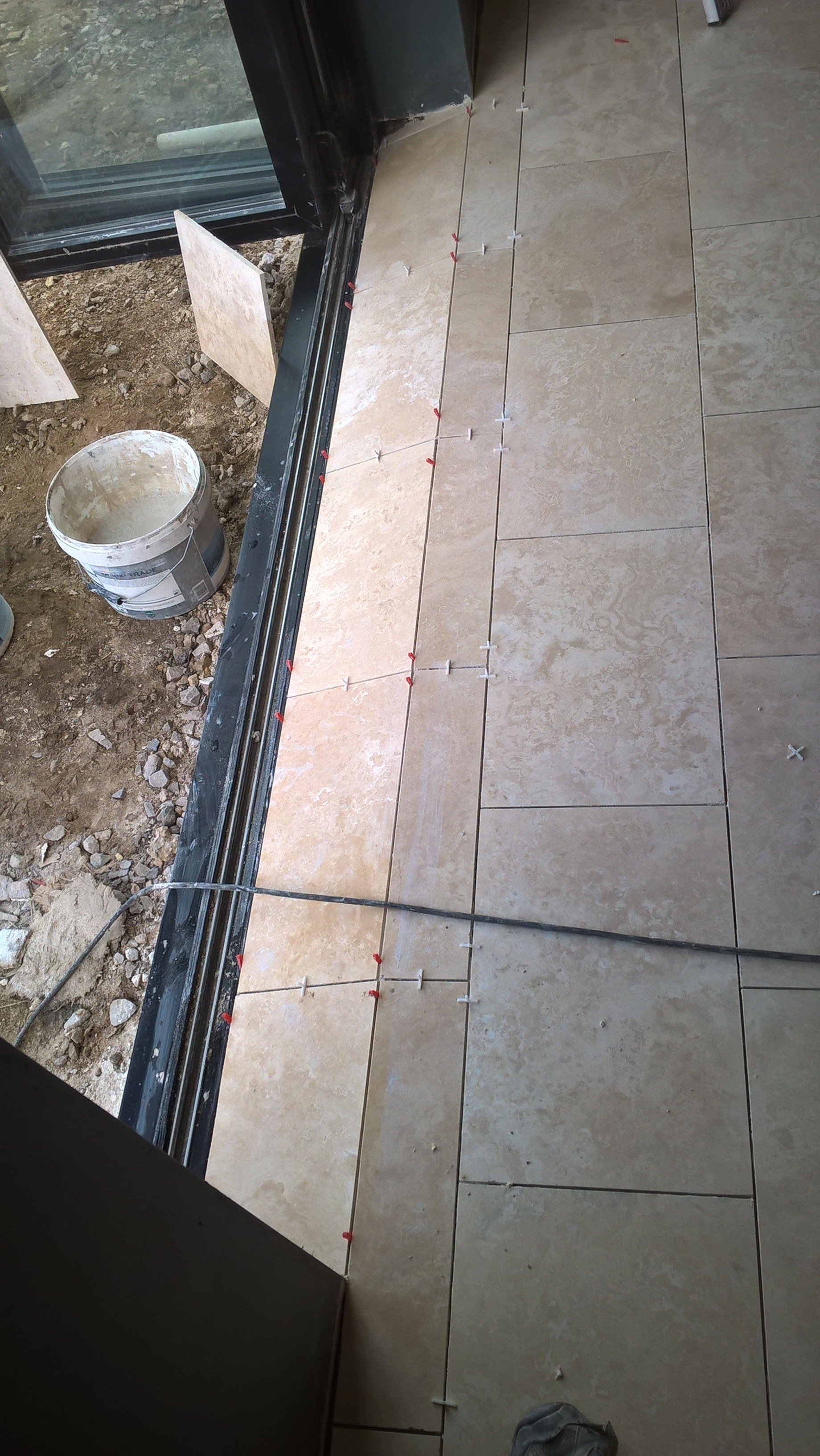

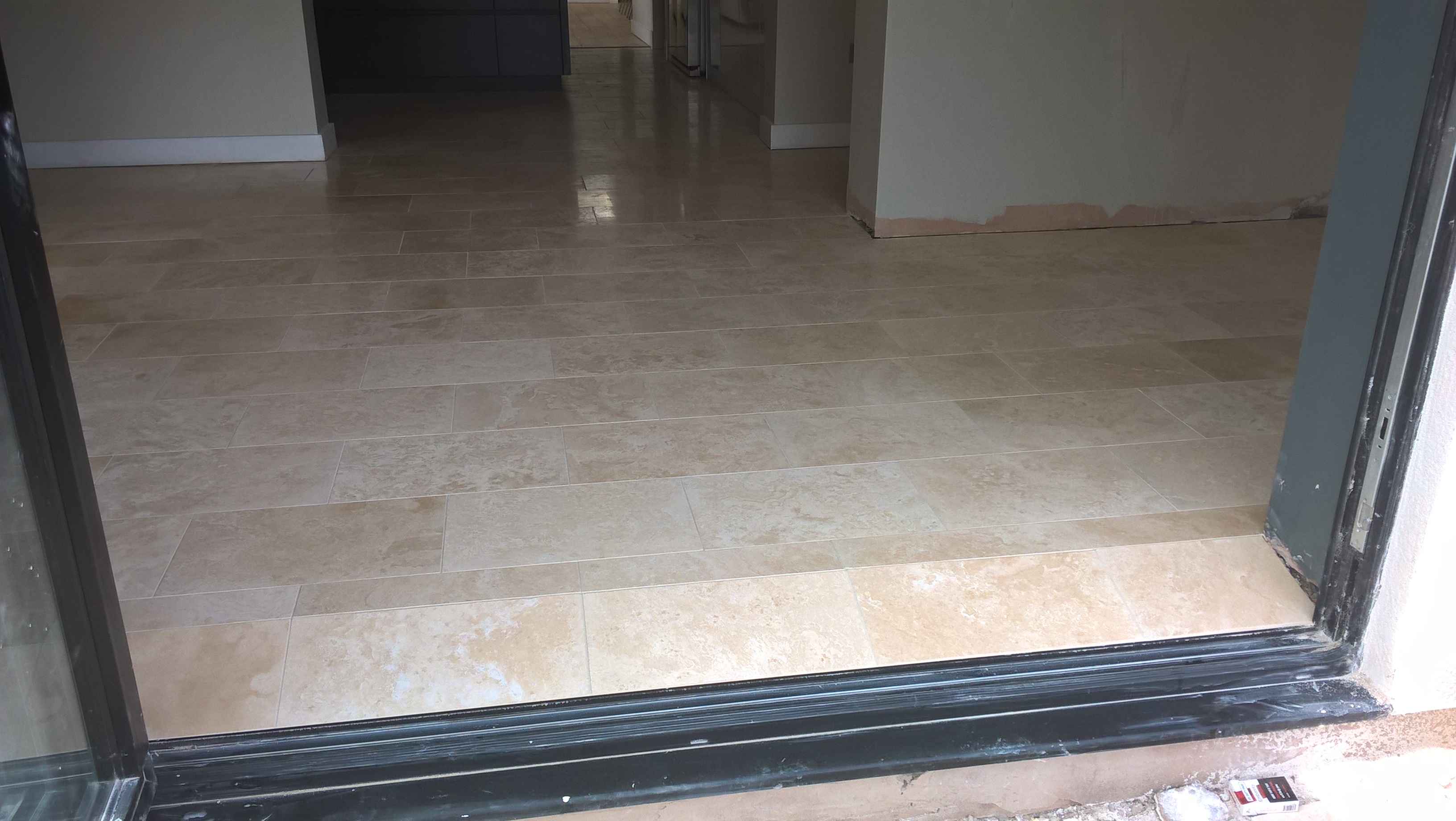

I'd definitely be looking at sloping your last row of tiles down to be flush with bifold rail as Paul suggested, just leave your ufh and SLC back a foot or so, it'll look miles better from outside than a big trim or whatever your planning when the doors are open.
Did this one this year and its quite a bit more of a slope than your looking at but sometimes its a case of make do with what you have to work with and find solutions..

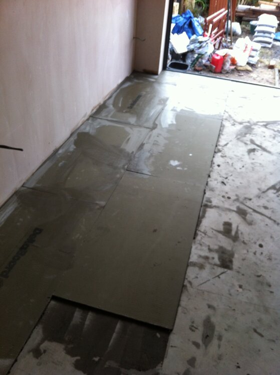

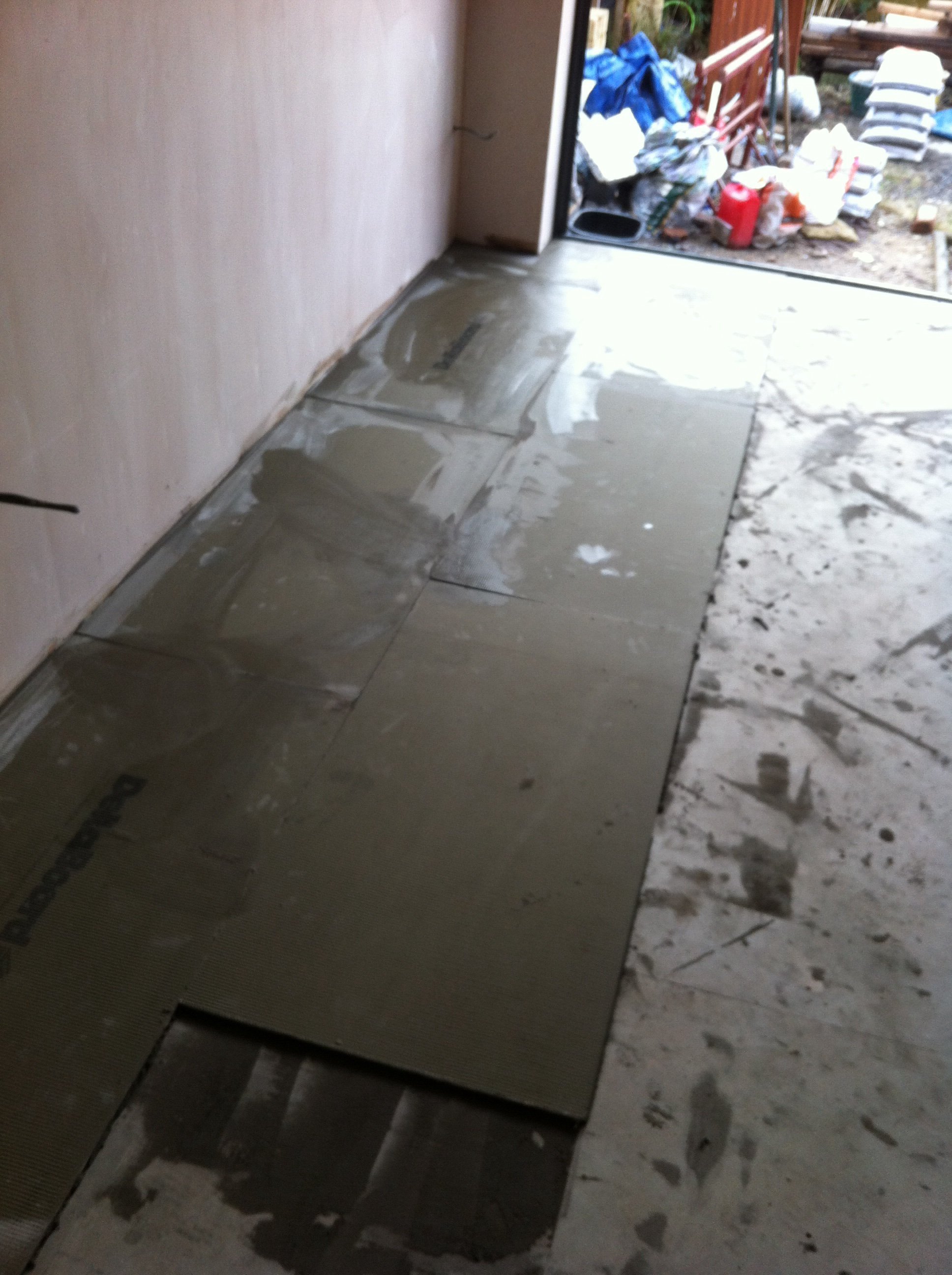

So I put down some insulation boards earlier, it was keraquick s1 flexible adhesive 20kg mixed with 5.2 litres of water, I certainly learnt a few lessons today, I used a 6mm notched trial, and back buttered all boards, it was all a bit frantic, I believe I have kept about 5mm around the edges free from board but not free from adhesive, does this matter? Although I believe I was fairly consistent with the mix I can see one or 2 slight ridges, this time I was on my own and it was rapid set, for laying tiles I'd have someone with me, I wouldn't be using rapid set and id be using levellers inbetween the tiles, I've only put down 7 boards so far so I am hopeing by the time I've laid them all I'll be a lot better at it.
