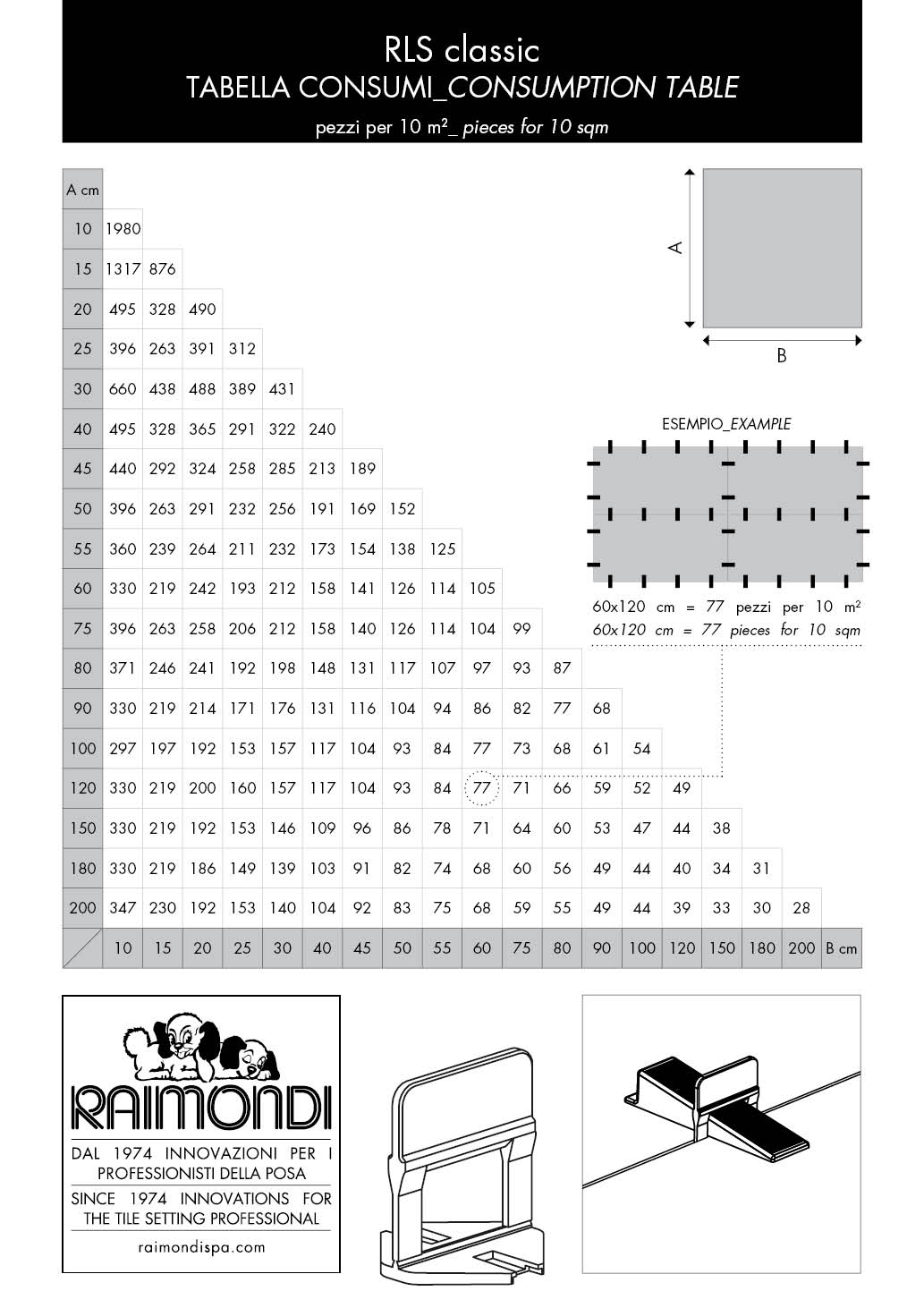

I'm trying to work out how many levelling clips/wedges I will need for this job, I've got 42 800 x 800mm tiles to put down, which works out as 23.3ish square meters,
I'm looking at;
RLS leveling system & Tile Spacers - http://www.kwiksplit.co.uk/acatalog/copy_of_copy_of_Raimondi_Tile_Spacers_and_Levelling_System.html
but can't work out how many I need, doesn't help that the chart consumption chart doesn't open for me on my laptop.

8,7 pz for mq
Raimondi s.p.a. professional tile tools Raimondi Levelling System - Raimondi s.p.a. professional tile tools - http://tilelevelingsystem.raimondispa.com/

then they are quite 100 pieces of wedges

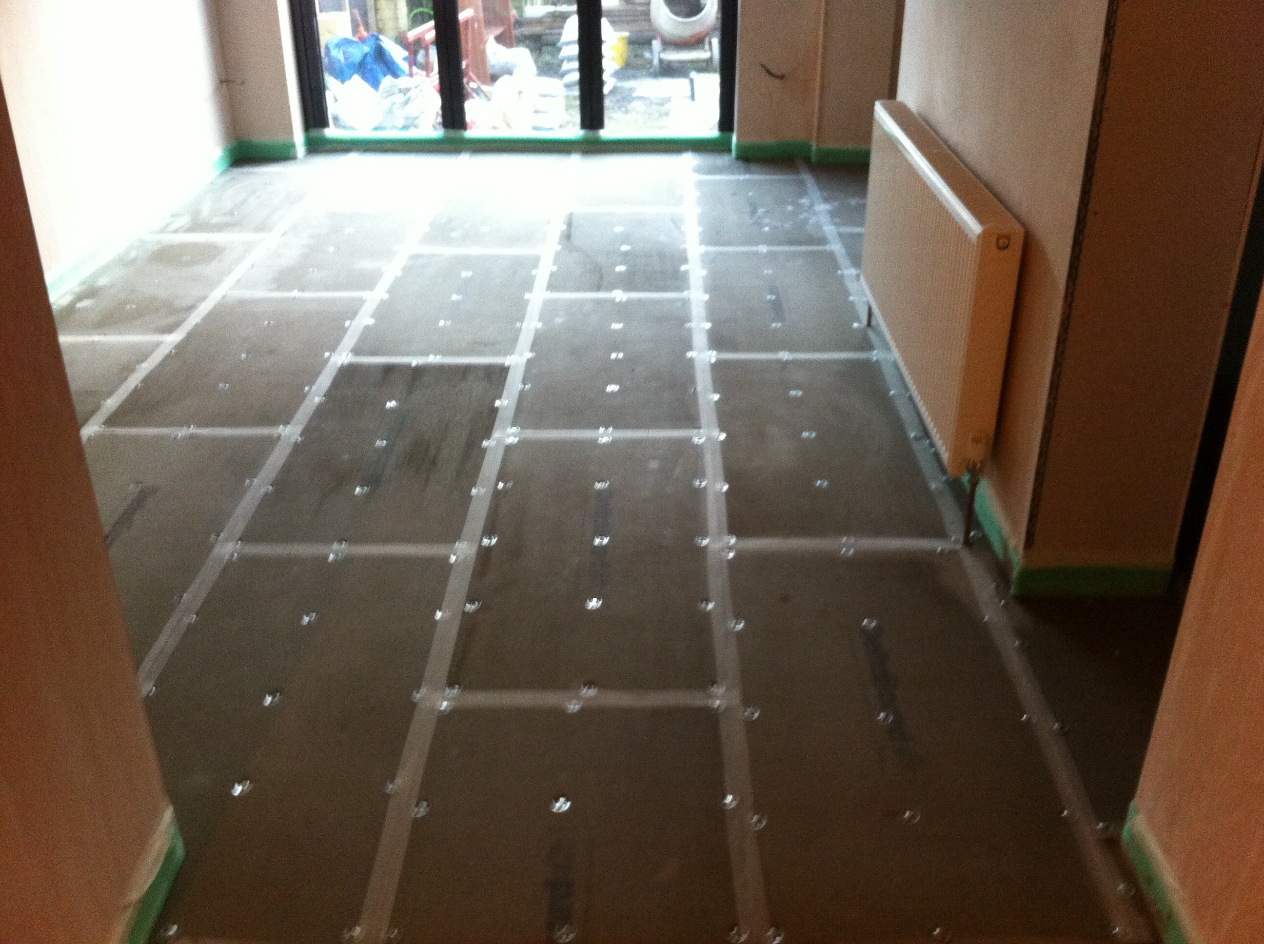

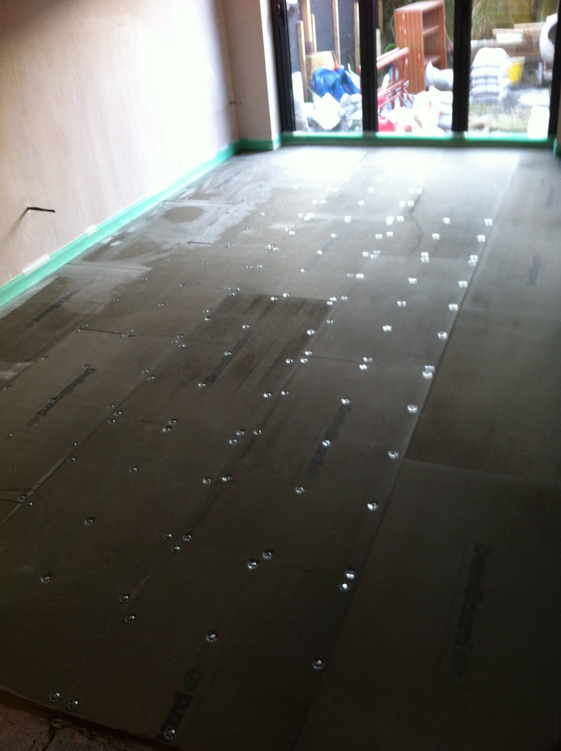

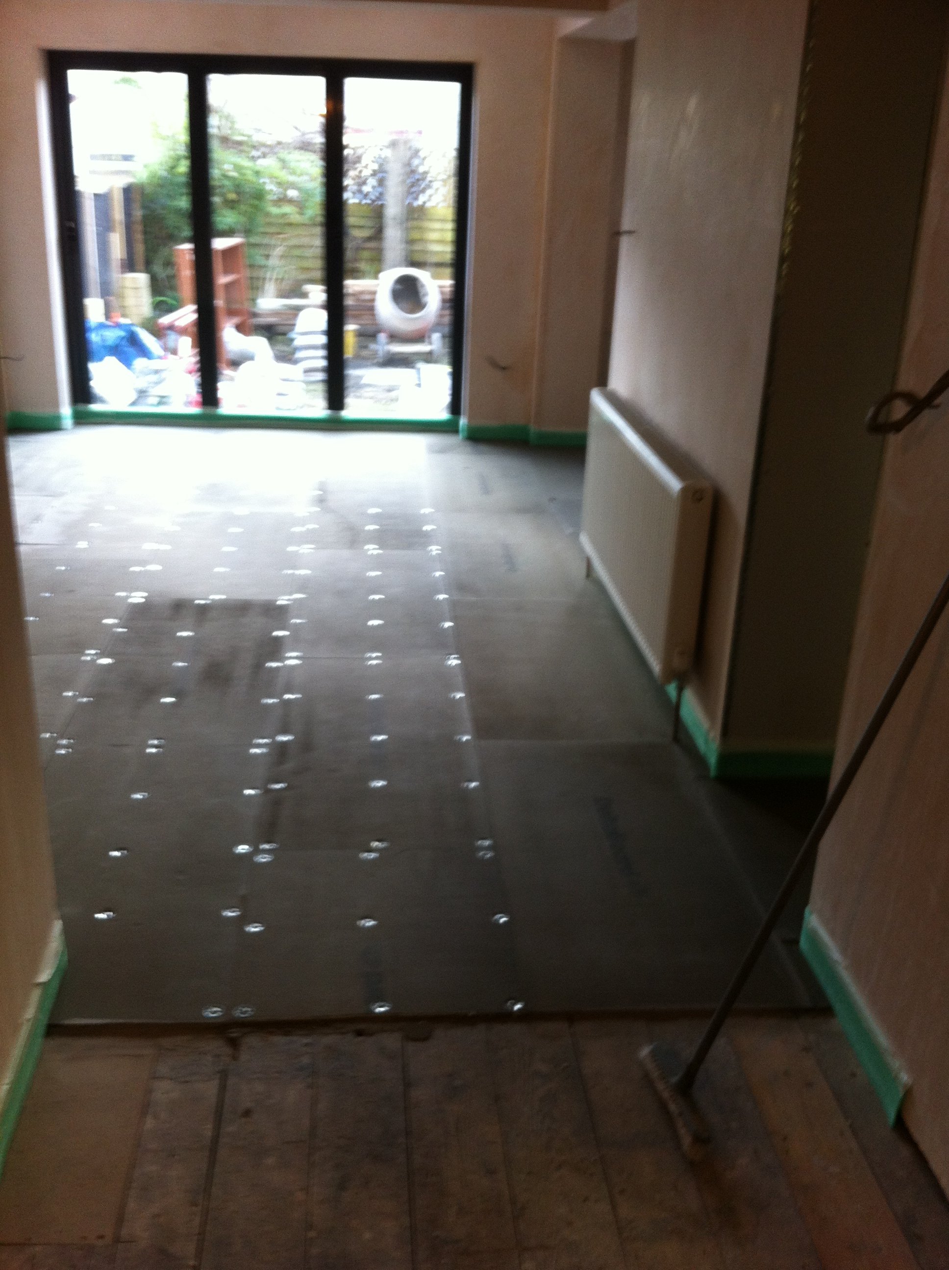

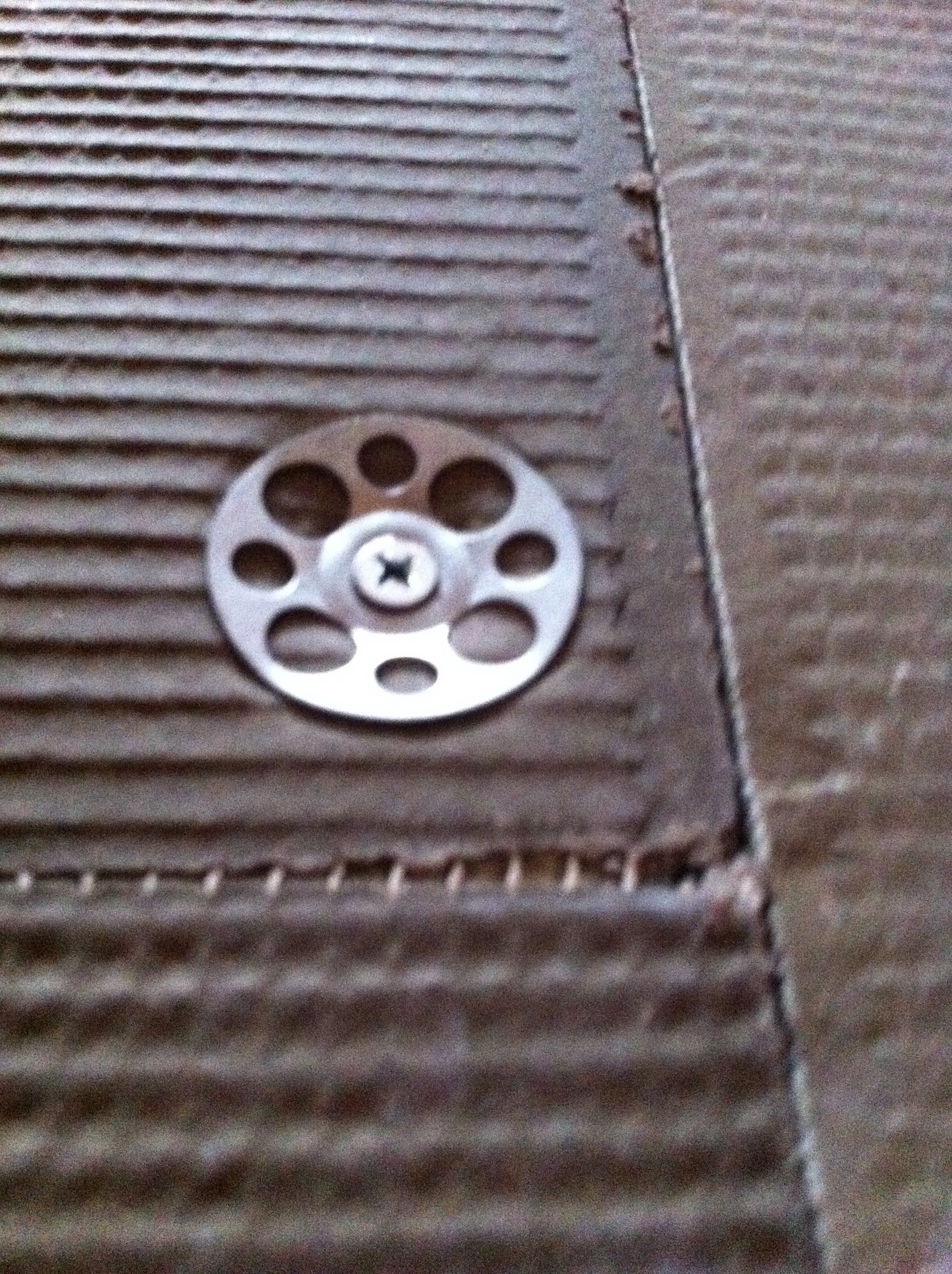

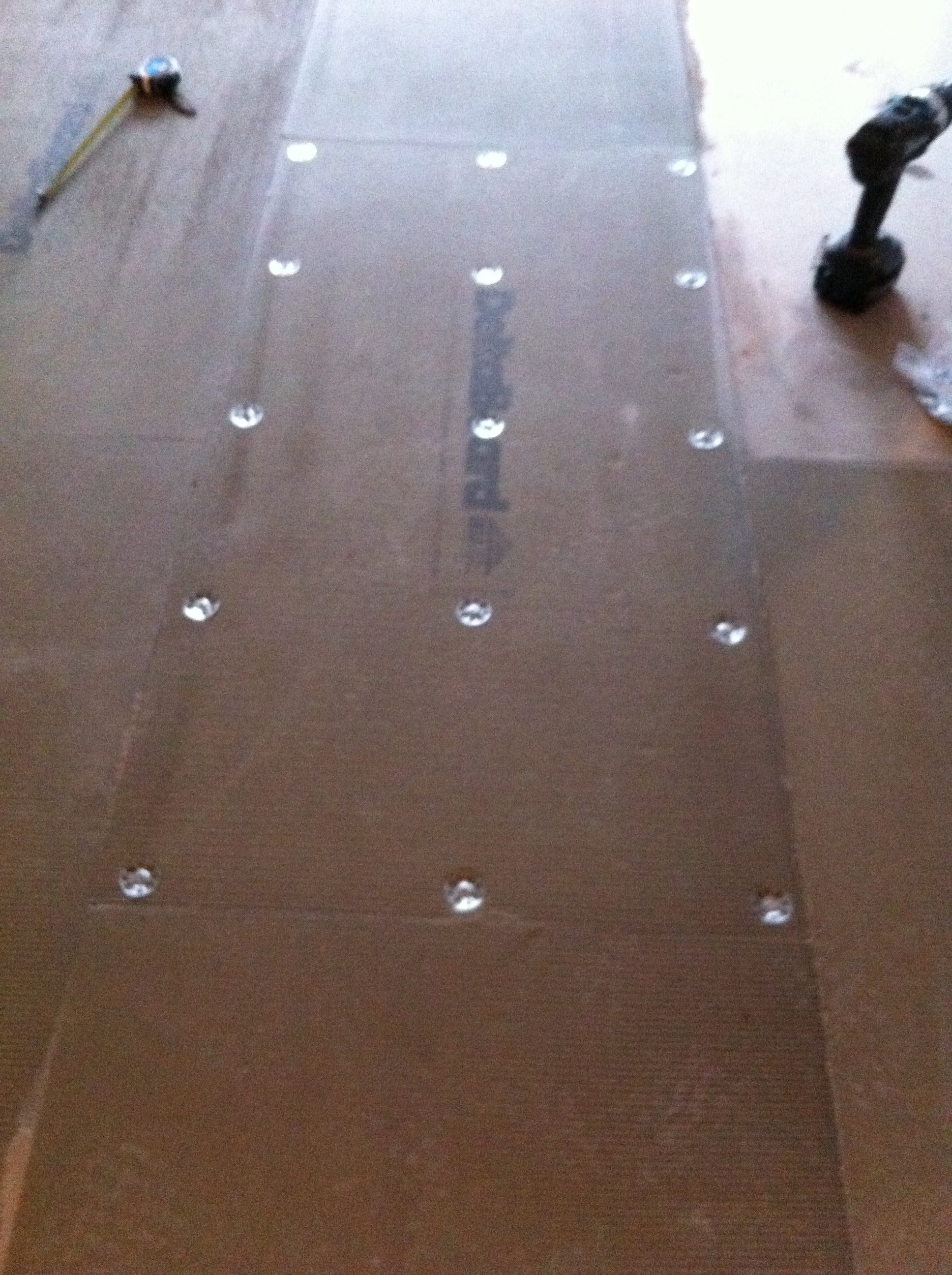

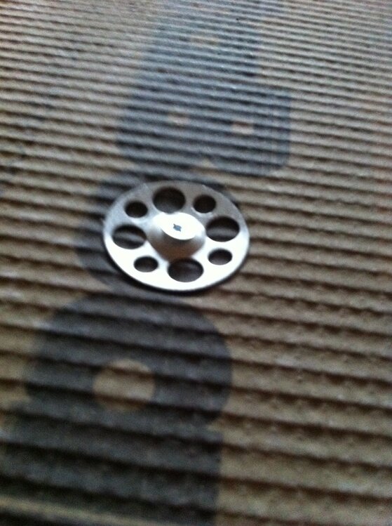

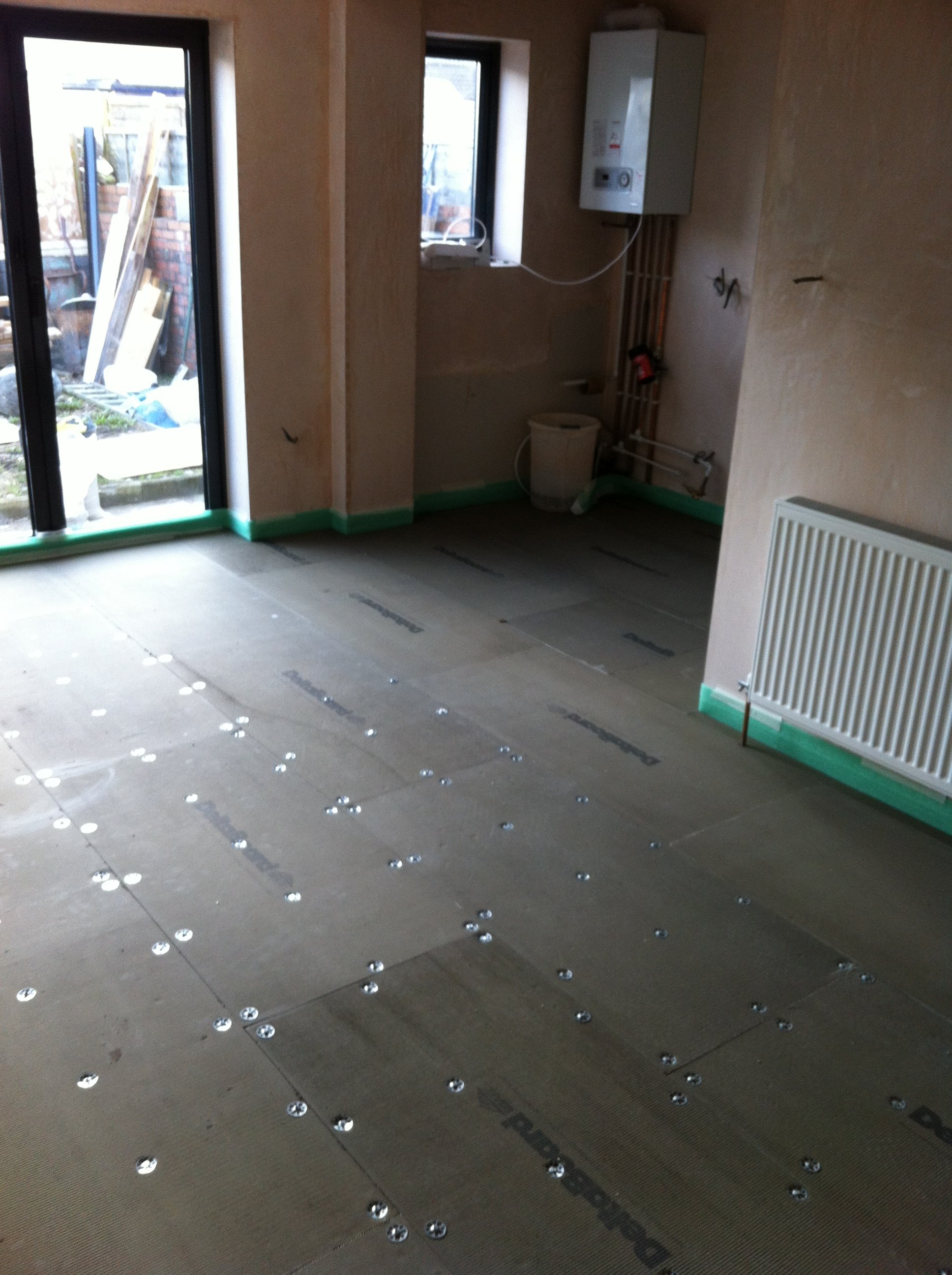

Guys I'm trying to get some screws down, I'm separating at 300mm roughly, I'm finding some going down tight, some not so much, I guess some are catching joist others are not, from what you see is there any problem from continuing the way I am so far?
Looks fine to me, it's getting a covering of levelling compound anyway so don't be overly concerned about the washers being pulled right in

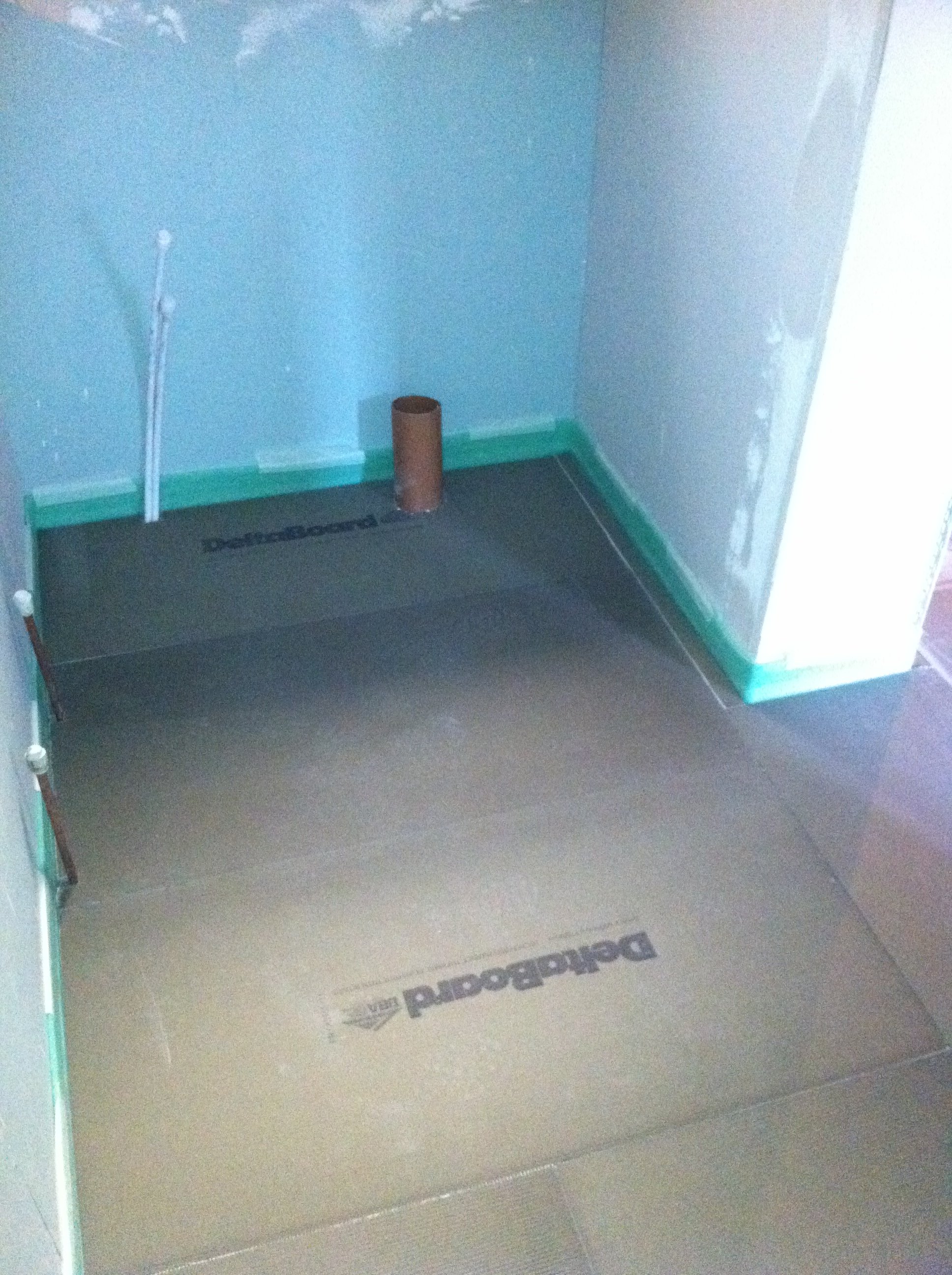

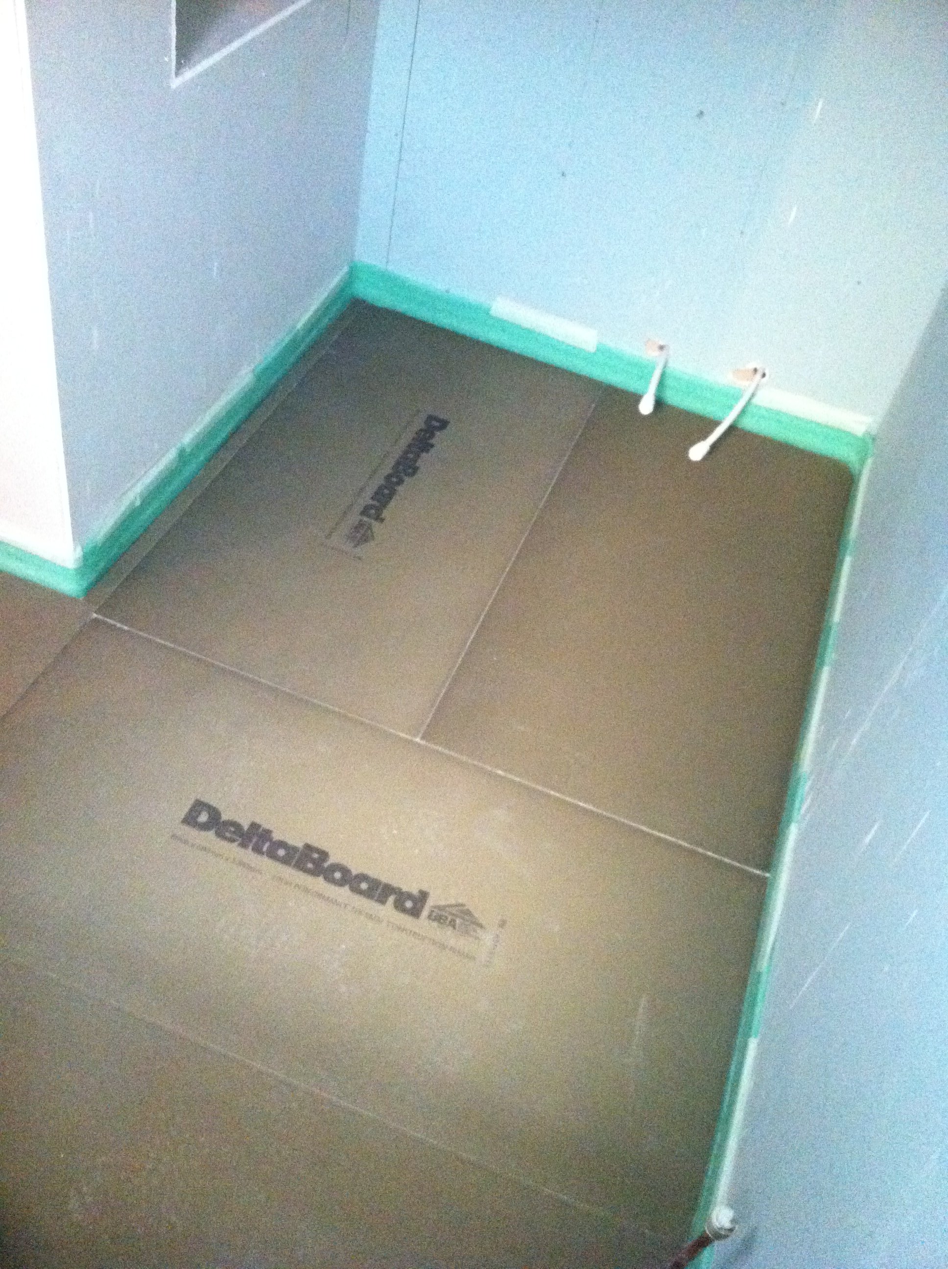

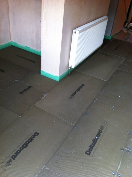

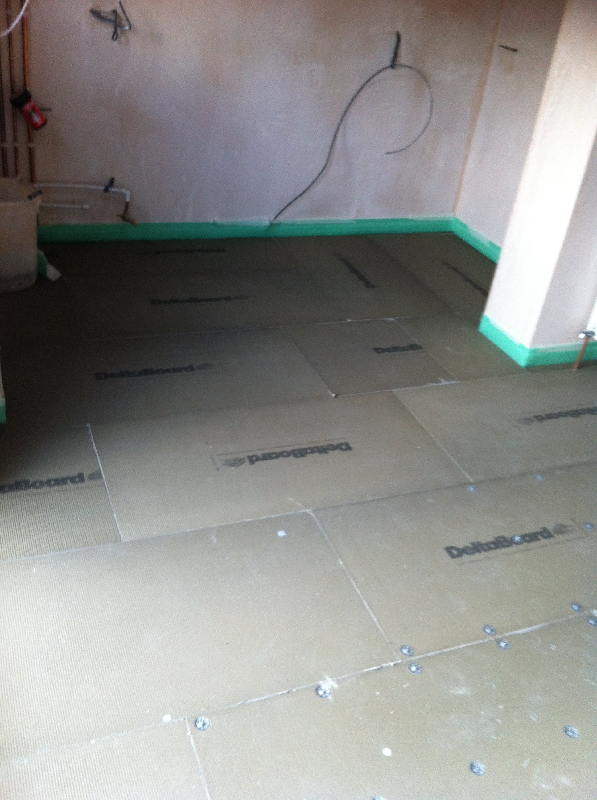

I have laid down all boards to cut to right size, I intend to take them back up tomorrow and put the adhesive underneath and then screw down, I've ran out of 25mm screws. i've got quite a few slithers along the sides of the room, i'm guessing I can only secure with adhesive and not screws as they are too small. i've also ran foam around the perimeter. I have laid a couple of boards in the bathroom not in brick fashion as it was easier, I just plan to have 1 metres worth of underfloor heating in that room, so hopefully it's not such a huge issue.
can I tape the joints with insulation tape or does it require adhesive?

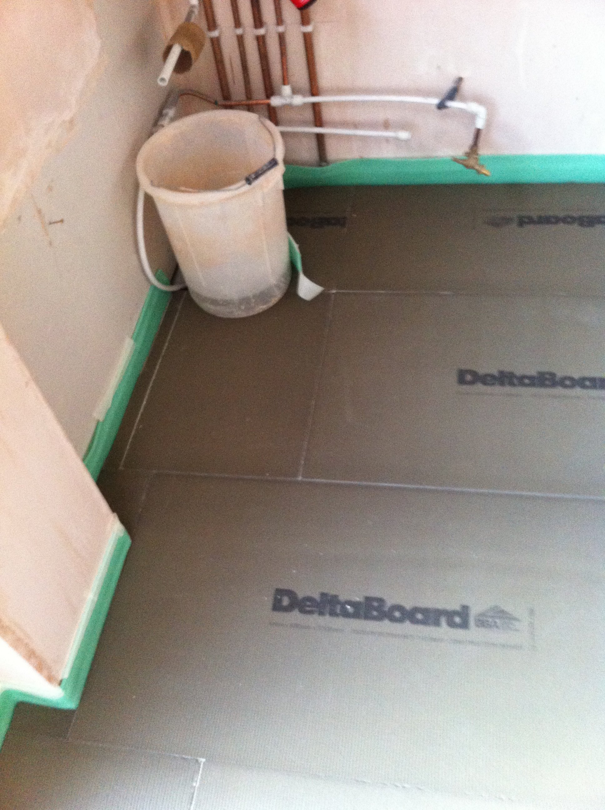

hopefully I will be in a position to lay the self levelling compound Wednesday or Thursday, I understand that I should purchase a spiked roller and maybe some spikes to fit on my trainers. any suggestions on where to pick it up from locally?with slower xmas deliveries etc, and any advice on size? I have a plastic float already.
the compound I have is 5 bags of tm flexilevel 25kg, the square metres of the floor should be 23.33, will I need to order some more? and any tips?

IMG_8523.JPG IMG_8524.JPG IMG_8525.JPG IMG_8526.JPG IMG_8527.JPG IMG_8528.JPG IMG_8529.JPG IMG_8531.JPG
If it is 23.3m2 it will take at least 8 bags to give you a 5mm covering of latex.
Depending on thickness of UFH,this is probably the least amount of coveringyou will need.

Do not use insulation tape.
Use a skrim tape and stick it down with tile adhesive.
You'll only need a skim of adhesive over it. Use the back of your trowel.

After you've stuck and screwed the boards and taped the joints, and laid your UFH mats, you need to survey your floor.
Assuming you have a level, find the highest point of the floor.
Using 25mm screws, place one so that the screw head is 5mm higher than the insulation board.
Using this as your start point, put them every few feet around your floor, using your level to keep them as level with each other as you can.
So that when your pour your latex you have a visual guide to the amount of latex you require in different areas of the floor.
Use them as markers, just don't screw one in to the UFH or too close to it.

So I've used the scrim tape and covered the joints, looking to lay the mats out tomorrow and do the compound, I am quite apprehensive about this, but I'll be following everything to the letter, one issue is that my only water source is in the kitchen which needs to be one of the first areas to do, maybe I'll see if I can connect a hose to mix in the other room, also I am wondering if I should fit a wood batten at edge of room as other room has wooden boards with biggish gaps.
You will need some sort of Baton on the end there where the floorboards are and you will neeed plenty of water! Outside tap would be ideal
