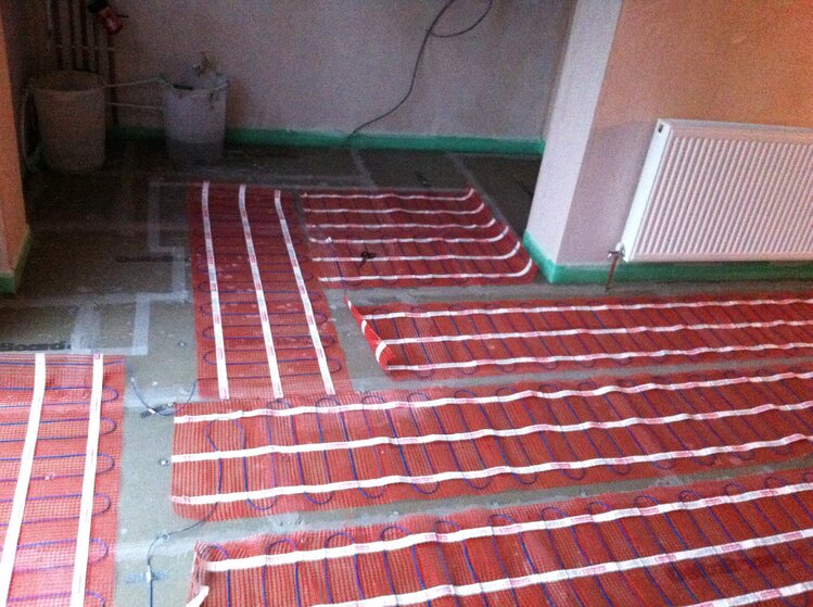

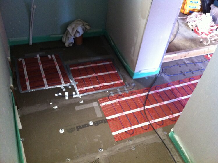

I've laid out the 16 metres of mats avoiding future cabinets and where sofa will be and not going to close to door, and from my current layout I am about 3 metres short, I don't have enough matting to go in bathroom and near the start of the room, if I space the main runs of mats further apart I could probably make it work, would there be adequate heat coming threw the to the tiles if say I double the space inbetween mats in the main room? Or should I just bite the billet and order a bit more? There's already 6 wires from the 2 mats for electrician to wire in I doubt know if 9 wires would be too much...
Imo if you start spacing them out a lot to stretch it you will have cool spots and reduce the over all effect, I would just get another kit and get the floor properly covered.
Me, i would just leave it , how often are you going to be stood in one spot? You probably will have a mate who will say " oh its 2 degrees colder here, just kick him out 😉
Also the heat will spread around im sure , the whole tile will warm up .
Just sod it and slc it, or your gonna be here next new year 🙂

This is why its so important to measure and set out your mat before you go cutting it up, eg..a ten sqm mat will give you 20 linear metres of mat, this should all be marked out on the floor before you even get it out of the box..

I don't measure out the mat before hand but I do always measure the floor area and check mat size and work it from there.
Simple space then yeah, did one the other week though..32sqm of ufh, through three areas round an L shape dining room and round an island, 3 mats 2x 10m and a 12, you try laying that without marking it all out first 😉

i ended up spacing it out a bit more in the end, not ideal but I got the small covering in the bathroom which I wanted, kept all wires away from each other at least 50mm and no crossovers, so should be ok hopefully. SLC will go down tomorrow hopefully.
So my brother and I put down the compound, used all 8 bags, it wasn't enough, I had to go out and buy an additional 5, used the spiked roller, tried to use the trowel as little as possible. so I have covered 70% of the surface i'd say, it was definitely difficult trying to keep it level, I found the sticky adhesive came off a bit whilst rolling, and by using the spiked roller, quite a few threads of the mat came off, but I don't believe any wires came lose or moved too much. unfortunately the cold tail lead is sticking up a bit, and also the powerleads are still above the service here and there, i'm planning to do the rest of slc tomorrow, a couple of areas I can see that the electric wires aren't so covered as others, but i'll just have to do what I can tomorrow. i'm feeling average about things, I don't think it was a complete disaster but it definitely wasn't as perfect as i'd hoped.
