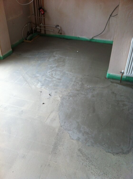

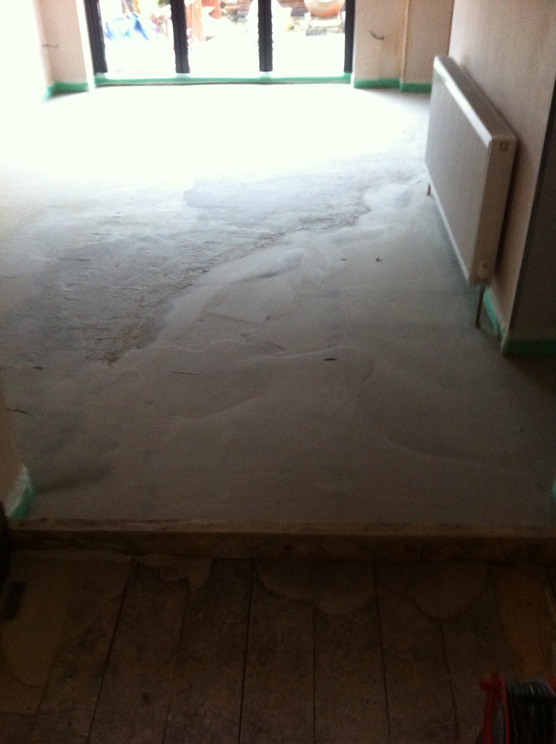

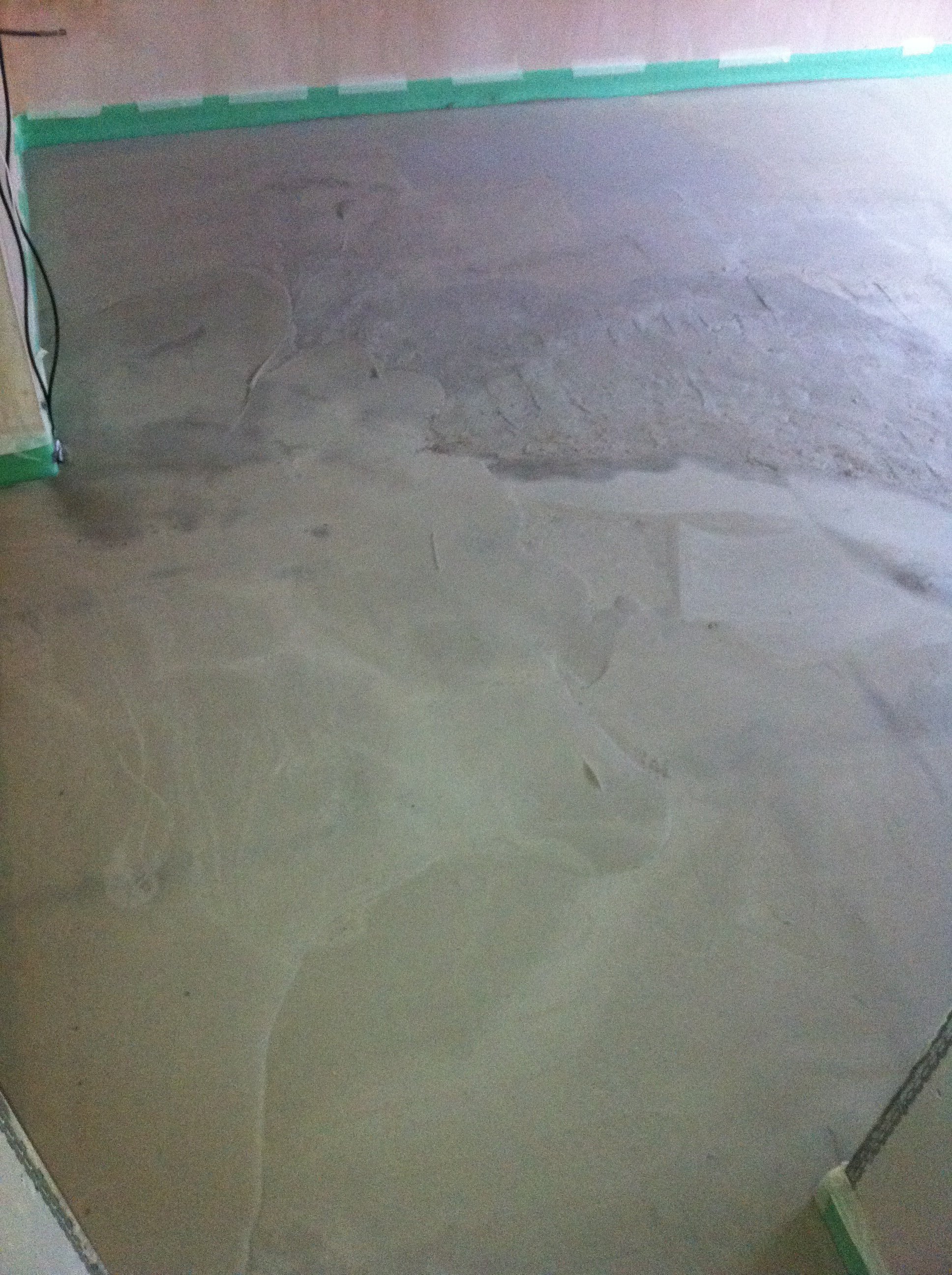

Well I finished the 2nd batch of slc, it's certainly not seamless but I have the slc coming next week to go all over the top.
It was frustrating to see one or 2 cables pop up even after pressing them down but hopefully it should be sorted on the next batch. image.jpg image.jpg image.jpg

I thought you had height issues?? More self level is only going to make the situation worse. Especially if it's like the stuff you have already poured. Not to put too fine a point on it but some 4 x 4's would struggle over that surface.

Well id be using that more than the spiked roller. Mark the dips out and use the straight edge to pull the leveller over them..
Thanks for the tip, excuse my ignorance, but do you mean use the straight edge of the level to pull over the dips?
Yes, go over your floor with the straight edge and mark out the dips first, its hard to tell from a picture how bad your highs and lows are, it was flat in the first place so surely cant be that bad..
OP, the longer the straight edge the better because if you use a smaller stright edge, you might think youve a bump but infact its actually a dip and can make it worse. Ive seen before some tilers chasing their tale filling with slc rather than removing a bump with a grinding disk.
What Andy is saying is to pour the slc down and lay the straight edge on the floor and drag it over it so it essentially drags all the slc and it will fill the low spots.
Your second pour looks better but it doesn't look like you have used the spiked roller a lot!
Where you get the tidal lines they are the areas you really want to be rollering
Grinding disks and ufh cables won't end well, if there's a gap under the straight edge it needs filling. Mp3 has never leveled a floor before and the first attempt using the spiked roller didn't go too well, so what's the point in going through all that again. Imo after marking all the dips out a long straight edge is the best chance he's got at getting this floor tileable..
