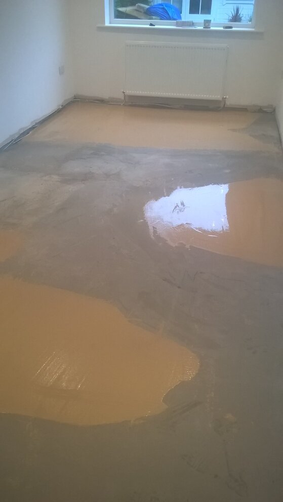

Grinding disks and ufh cables won't end well, if there's a gap under the straight edge it needs filling. Mp3 has never leveled a floor before and the first attempt using the spiked roller didn't go too well, so what's the point in going through all that again. Imo after marking all the dips out a long straight edge is the best chance he's got at getting this floor tileable..
No im not saying he should grind. Was just pointing out about other tilers ive seen thinking it needs more SL rather than grinded.
Yeah there were a lot of lose wires around my 2nd pour, I glided over with the spiked roller but I didn't feel comfortable putting force to roll as I think the wires would of came up.
So I need to check the top level only on the level, I'm a bit confused on what method I'm using to spread it, am I pouring a thick layer by the bifolds then scrapping along the floor, or gliding it? Won't it leave a juddering effect on the finish?
Or should I just pour the entire area then glide over it afterwards? Until now I've not been stepping on the compound once, so by getting on hands and knees to scrap it's a big change.
Survey the whole floor first with your longest level, get right down and look under it for dips, mark the dips with a permanent marker, pour some leveler in and drag your level over it...like this
I just watched this one, I guess the only question I have left is am I just using the slc on the crap bits or throughout the entire area?
I've enquired with a company to finish off the screeding, I'd be providing the SLC, what would be a competitive price in your opinion?

thanks for your vote of confidence average, I do feel that the next batch of SLC will go better, but I understand the concerns from others that it is the last attempt before I'd get into problems with floor level etc, so I want it get it right, if these guys comeback with a reasonable quote then for peace of mind I might use them for screeding only, if it's too much then I will do myself using the methods discussed.
Just have a think carefully about it, if you can't get the floor flat to within a couple of mm over the length of your 2m level then your gonna struggle with those tiles same as a professional would
I understand, I just got the quote in and it was over double what I'd consider paying, so I will be going it alone (well help from bro aswell).

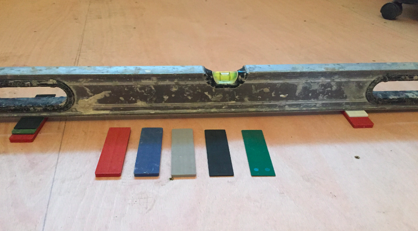

If it was me in your situation, the thing you need is a height to work to, otherwise you could be pouring slc forever. If you can get a bag of plastic packers, of varying thicknesses you will be able to get it somewhat nearer than just pouring and hoping. If you find the high point on the existing poured slc and then work from there.
What you need to do is Silicon the first packer (cut them into 3 pieces) to the high point. Sit your level on top of the packer and approx 600mm away from there use more packers until its level. Move round the room uniformly fixing the packers with Silicon. Once set you can then pour the new slc until it's level with the top of the packers
This is what I mean, unless you've already done it
thanks John, being able to see visually will be a huge help,
will 1 mixed pack of 200 be sufficient?
is there any special type of Silicon I should use?
I'm guessing I should avoid placing them over the heating element if I can help it.
with this method should I still be using the straight edge of the level to spread or will the usual pour and spiked roller be sufficient?
More than enough, cut them into 3 pieces to make them smaller. Any Silicon will be fine. I would just pour and use a trowel particularly over the existing slc as it will spread less easily as the thickness will probably be a few mm at most. Pour and use the roller on areas where the new slc is going. Work quickly though, it will set faster the thinner it is!!!!
