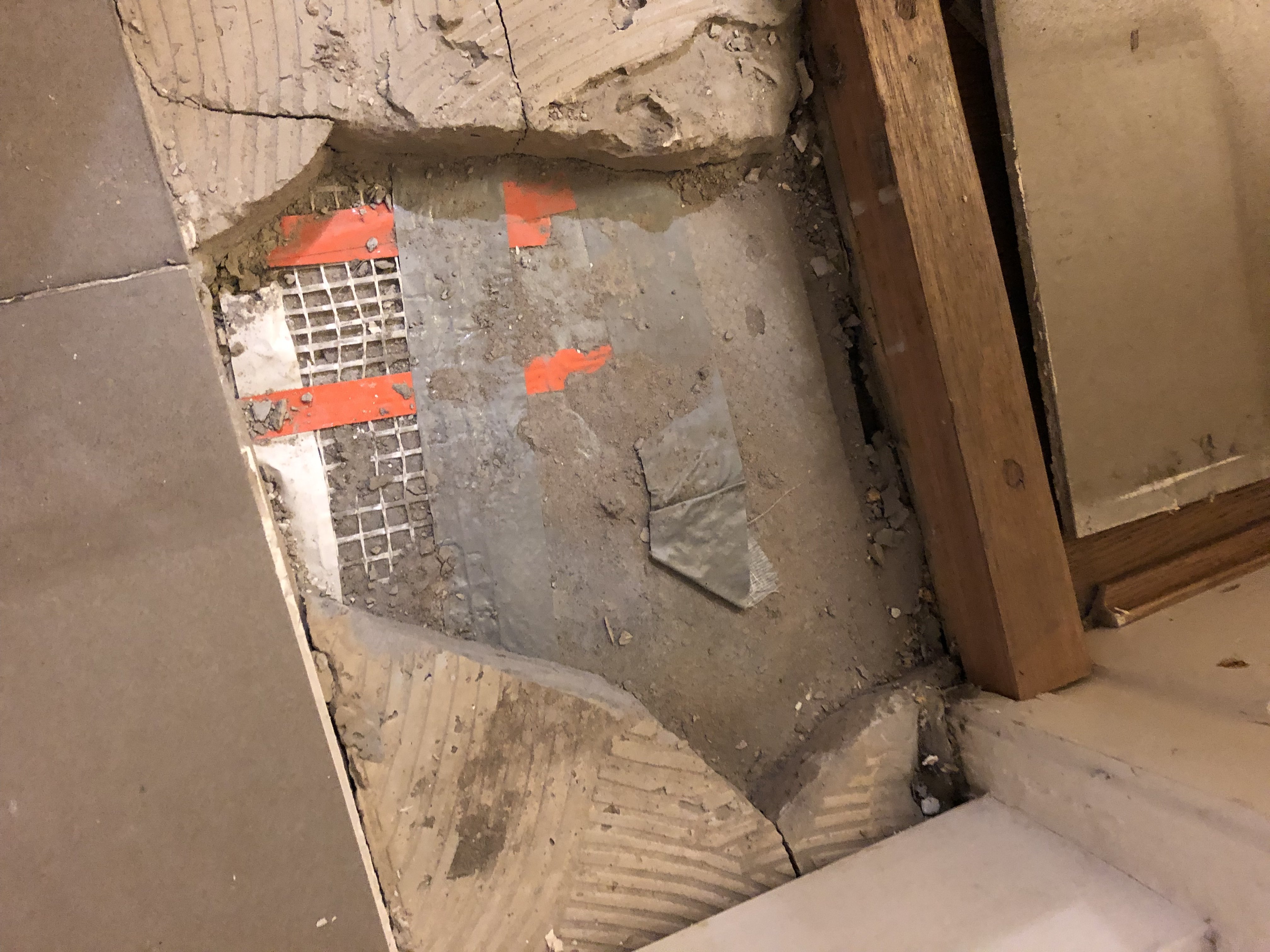

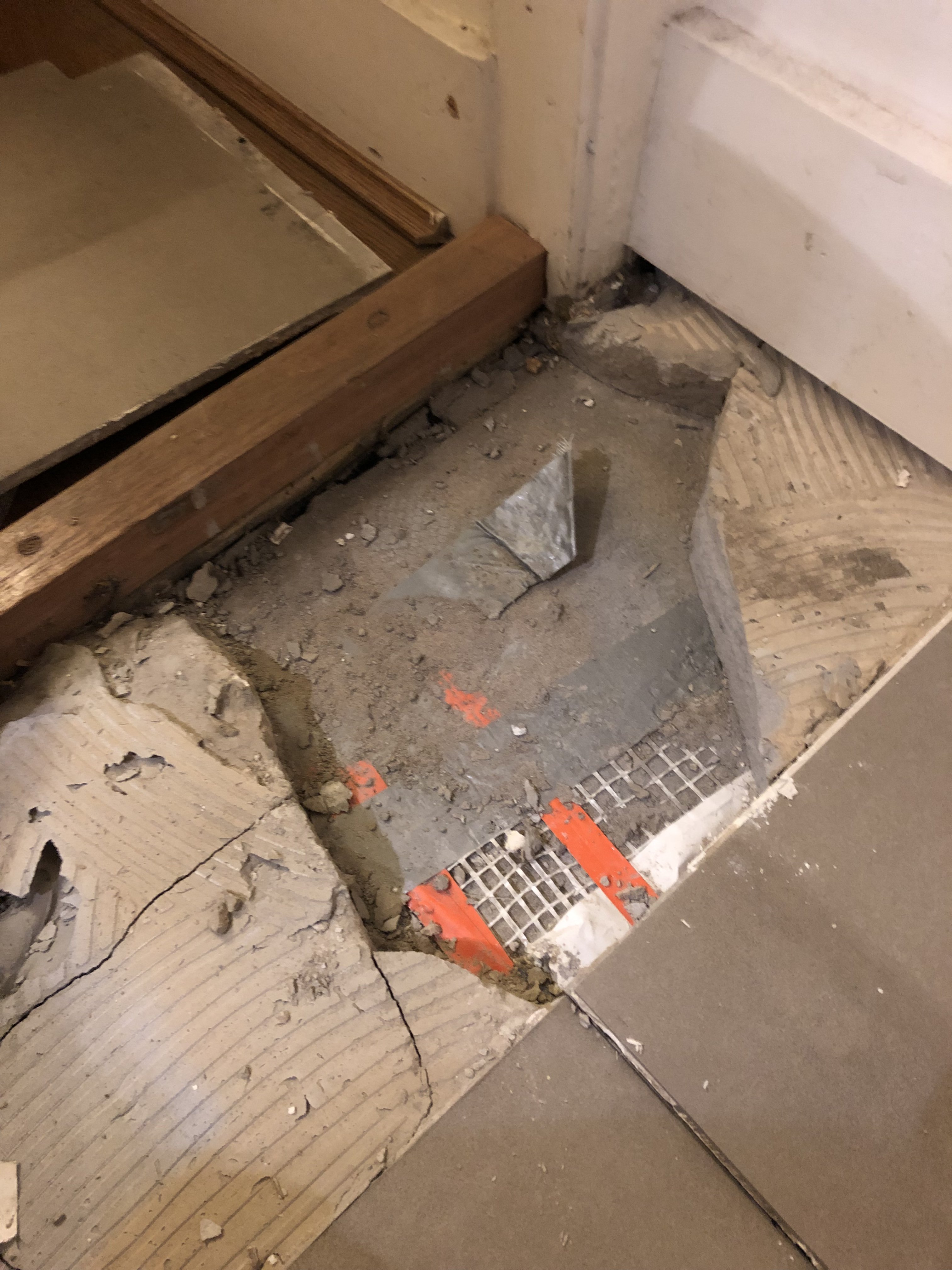

I had a new tiled floor laid a couple of years ago. The tiles have started to crack soon after completion and are now a complete mess.
The floor build up is a timber hoist floor spaced at 300mm centres with 18mm ply board 10mm marmox Board electric underfloor heating mat. The bit that looks odd to me when lifting the tile there is 40mm of adhesive which is all cracked and loose. Most of the tiles have debonded from the adhesive too.
Seems to me that 40mm of tile adhesive is crazy.
Can anyone give advise on if this is normal and what would be the best way to remedy.

Very few (if any) tile adhesives are made to go thicker than 25mm.
That's the issue.
To be honest; anyone stupid enough to use that thickness of adhesive has probably done many other things wrong too which may have contributed.
Tiling direct to the mats is one.
I can see the adhesive ribs, so not back-buttering and bedding the tiles properly is another.
A job should last a decent length of time (7 yrs or so) can you get legal with the "tiler"?

A bit hard to tell from the photos but it looks like a few different layers, possibly very thick levelling compound rather than adhesive. It's wrong though whatever it is.
That's not 40mm adhesive it's a screed. Possibly anhydrite although looks too dark...
Am I missing something, it’s white Adhesive and a screed. Would’ve taken an age to heat up.
It looks to me like a thick pour of SLC and then adhesive on top with a tiny trowel like a 6mm. I can tell it's got issues with the amount of gaffa tape over the wires. It's probably a catalogue of errors leading to this point.

You have to ask yourself why it’s that deep in the first place. My guess is that thickness is there because it’s a lower point.
I’d get everything up and potentially level the floor up with a self leveller capable of coping with that thickness then a sizeable thickness insulation board, then UFH then latex and then tiles
I don’t do many concrete floors though so perhaps someone else could advise.
Do not introduce ply to this job . Although you may not think it you have a good background to start with ie your lower level of screed . Introducing ply will add a later if weakness and complication. It will be very hard to do this properly with the kitchen in place although getting back to that height shouldn't be an issue . As said above after clearing out old flooring and screed or whatever it is . First job level the floor . Then fix insulation boards ( thickness for thickness they are usually cheaper than building up with levelling compound ) .once boards are fixed fit under floor heating then level over that to protect it , get a better wrap of material around the cable got better heat transfer and also if you damage a tile in the future you have more chance of replacing it without damaging your ufh and then finally tile the floor .

Looks to me like they’ve used a leveller that obviously can’t gobthag deep or cope with ufh. As stated above don’t introduce ply to the mix. Set datums and level up, underfloor heating must be fully invaded in leveller.
