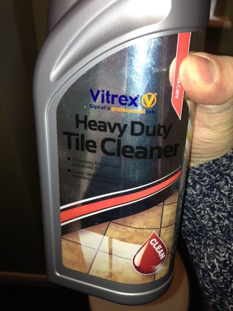

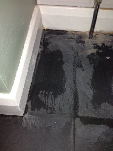

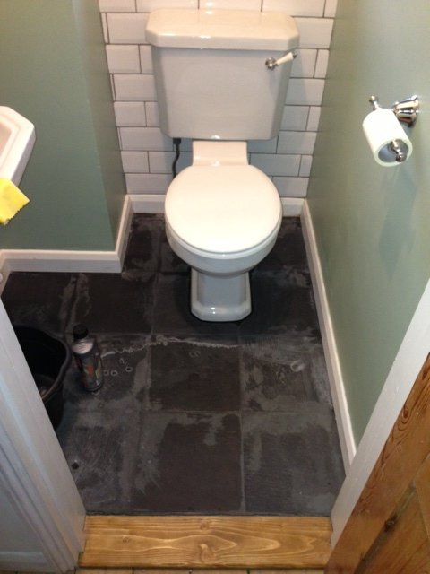

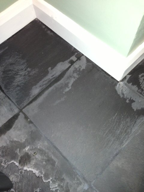

Any how I went and bought 'Vitrex heavy duty cleaner'. I spent today trying to clean off the grout haze and excess grout on the first 2 rows from behind the toilet which you can see in the photos. However it does not seem to be shifting it.
How would you go about this? I want to get them clean so i can seal them. It sonly now i think the job is an extremely poor one, but its too late to moan, just want them clean.

That is quite some mess! I would be using LTP grout stain remover or LTP grimex personally. Good luck

Bought this stuff, has worked a treat. Using wire wool and elbow grease, comes off relativly easily. Once done i will clean and seal, job done.

Pleased you got the floor sorted. Now it's just a question of redoing the tiles behind the wc! :lol:
