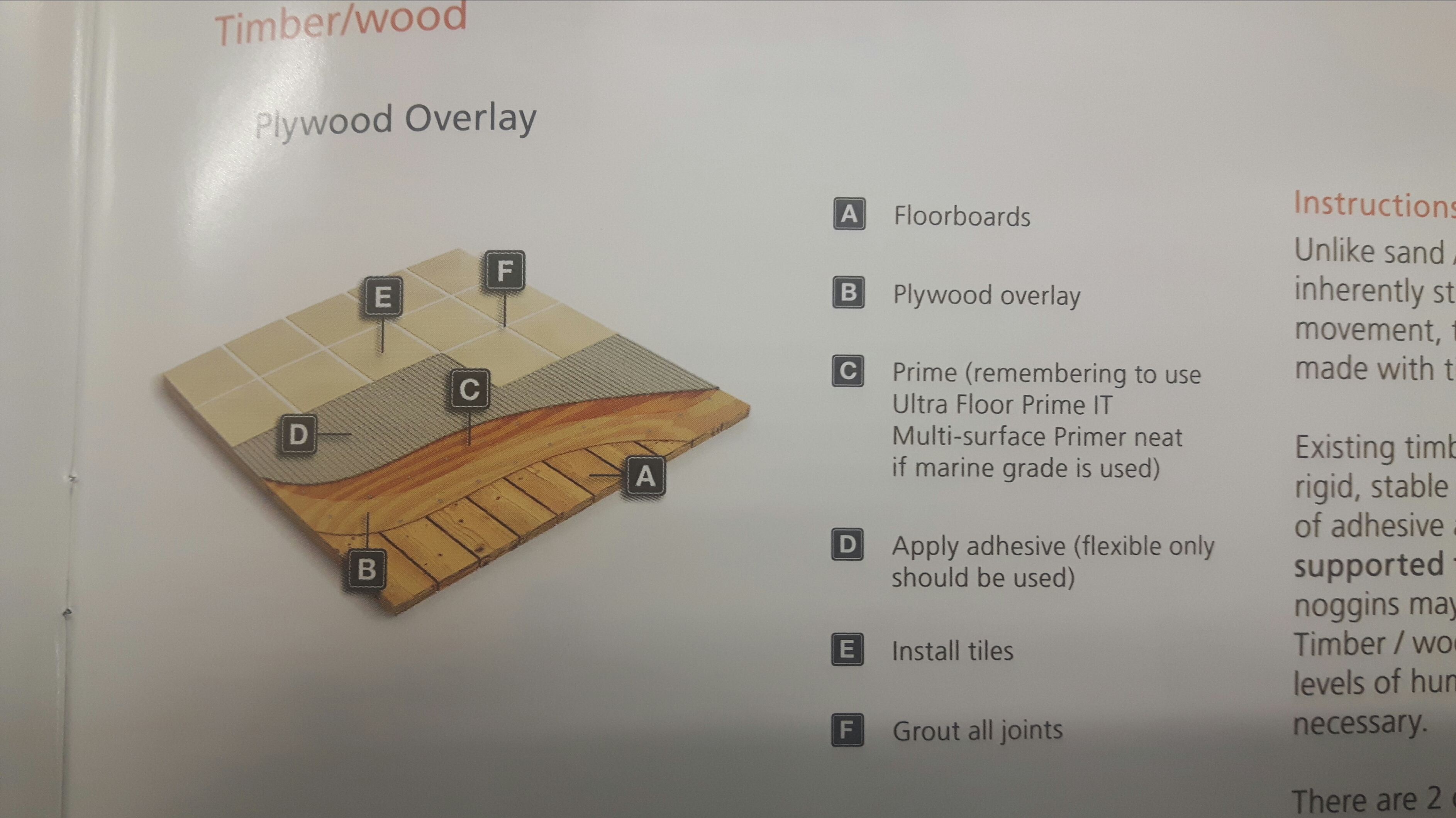

Afternoon, (Brand Blocked Temporarily until they unblock us on facebook) recommendation on Ply for all the Ultra adhesives.
I was always told not to prime ply unless it's dusty. Beginning to which I'd primed it now but if the instructions say not then I'd be going against the mi's, so they'd get me on that.
Had this discussion a while . I prime everything . Was told by people on here that I should not prime ply with bal fast flex. I checked their spec sheet and they were right . So I contacted bal and asked them about it and they said it wouldn't be a problem if I primed it . I expect the same answer may be got from weber

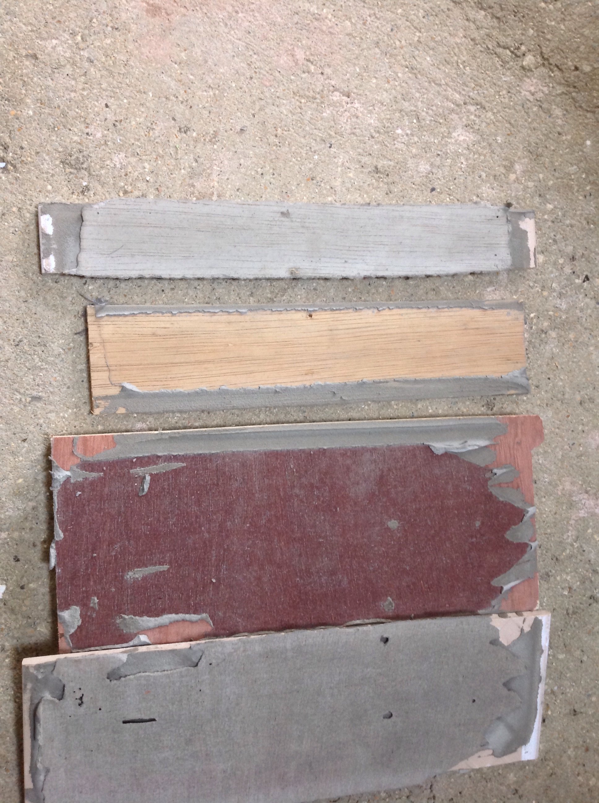

Just a thought, the photo that shows the plywood, as has been said looks quite dark, I don't suppose it could be more of a concrete shuttering ply with releasing agent impregnated in it
And maybe the Weber adhesive just couldn't cope, whereas another manufacture may well just have been a bit better?
As said just a thought
Dave
Dave
Shutterers defenitly don't use hardwood plywood. That darkness indicates 'Redwood'
I did a little test of my own over night. Stuck some off cuts down to an 18 mm piece of ply I found kicking about my shed, so not the same batch of ply I've used, and used a 9mm piece of hard wood ply. Pushed a knife between them with vertualy no pressure this morning and both popped off clean as a whistle. Now surely something should have stuck to the ply??
