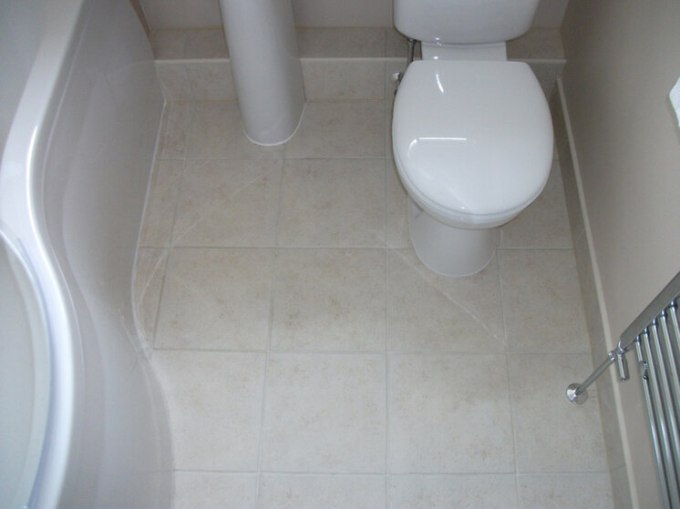

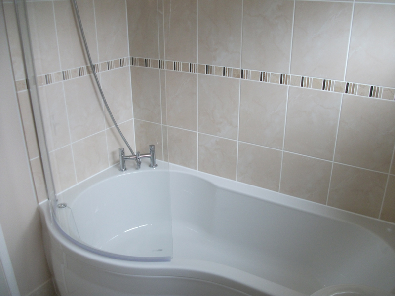

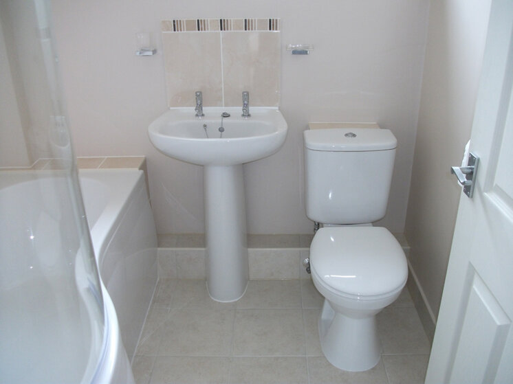

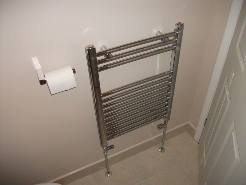

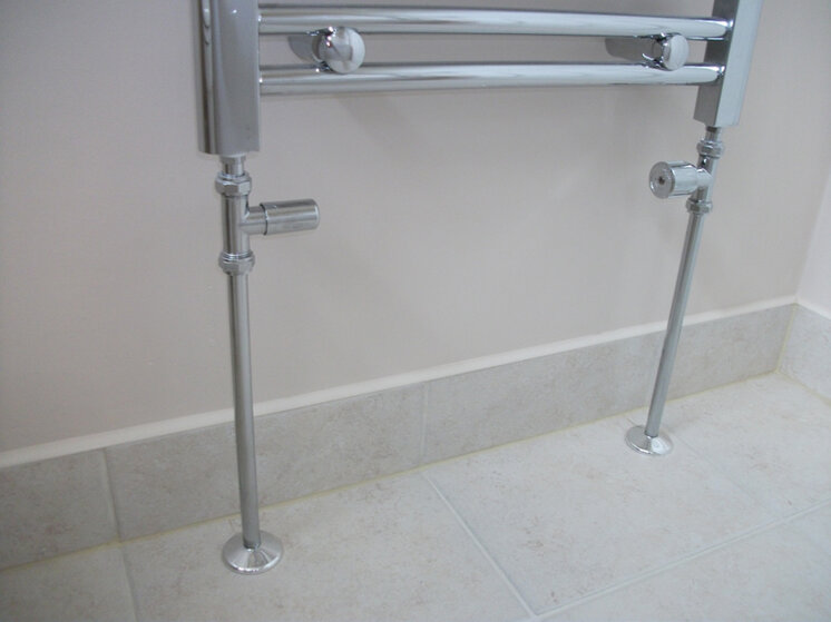

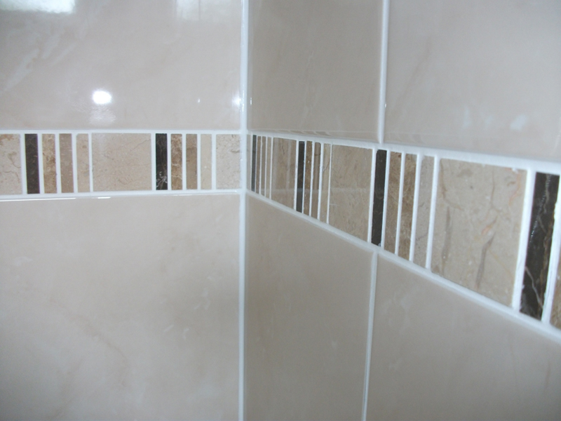

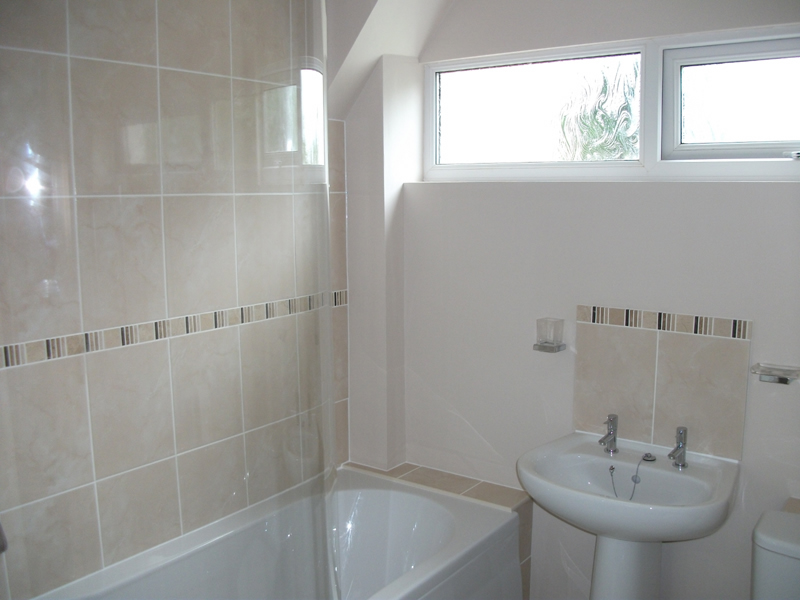

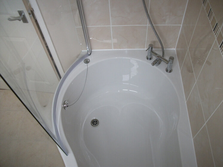

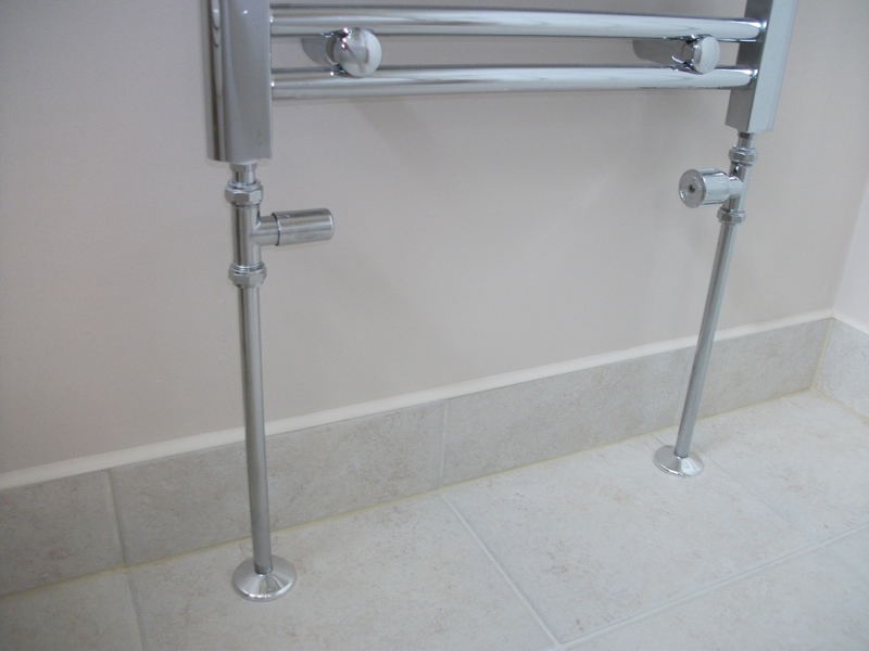

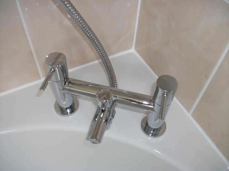

My first full bathroom refit - basic compared to most of the stunning work on here but a big deal for me. I've done everything but the skimming and 1st fix plumbing.
Used bal tanking and single part flexible on walls and hardie board and single part fast flex on floor.
Be interested in your comments.

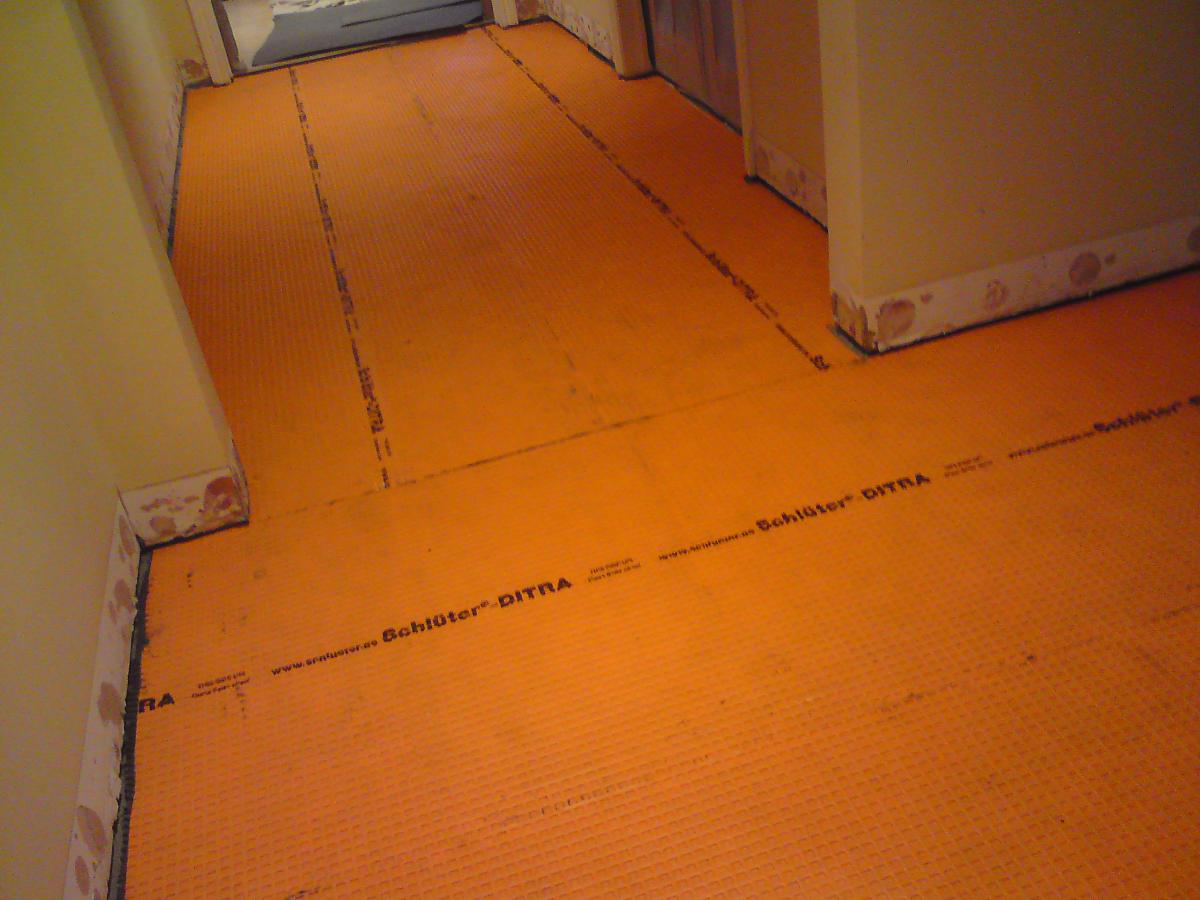

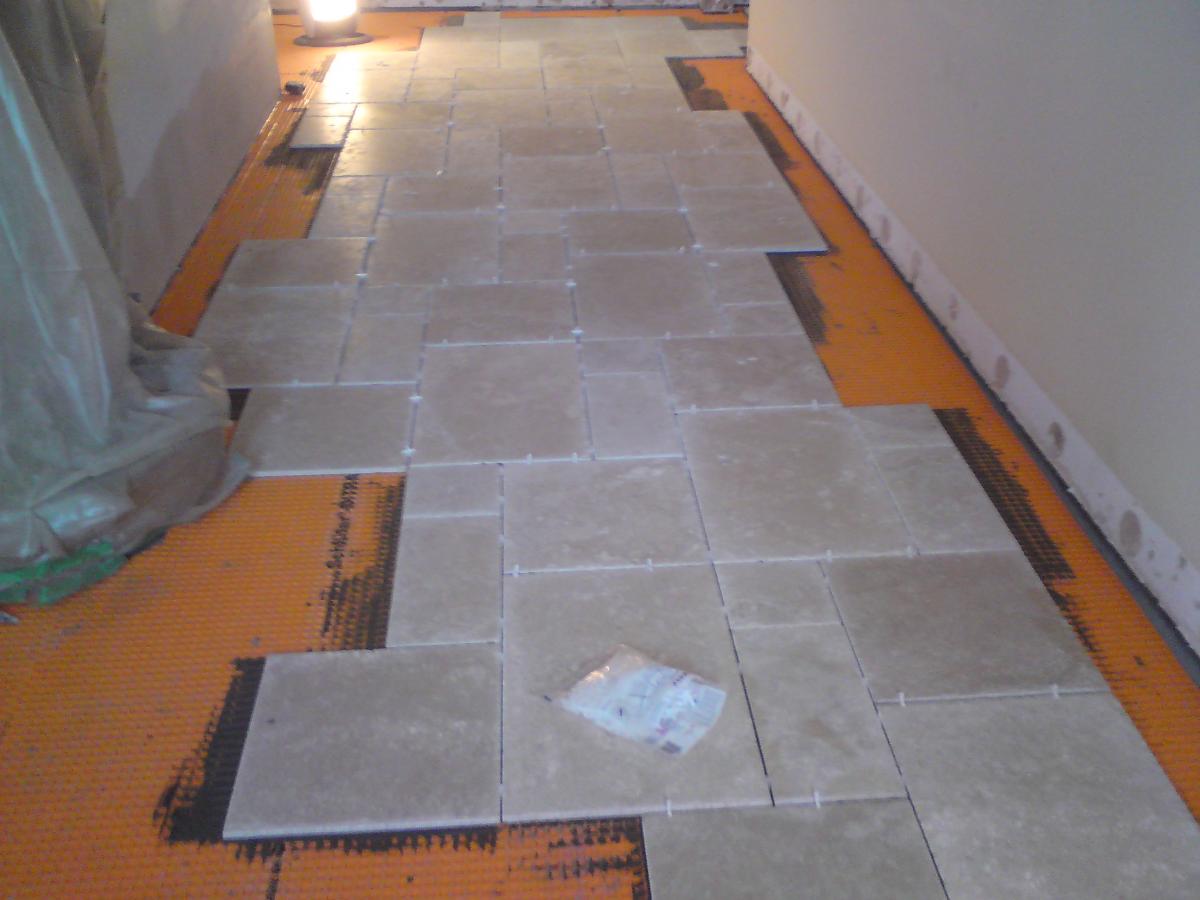

This is an NHBC job, I'm the third person to replace these tiles, so it's getting done right with silicon expansion gaps and ditra matting as shown in the pics. Tiles are tumbled edge filled Trav in a 3 element pattern (forgot the name of it).Originally fitted directly to the screed with no expansion gaps or decoupling matting:yikes:

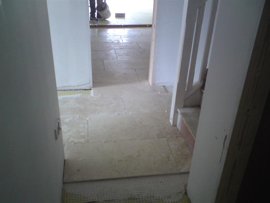

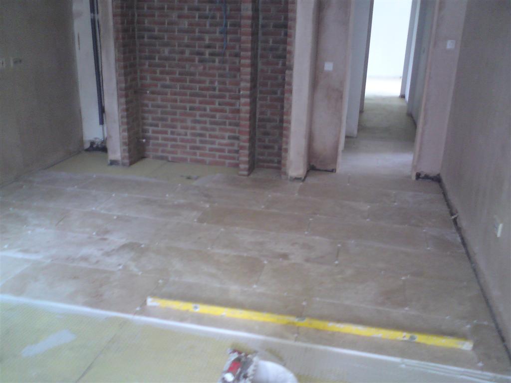

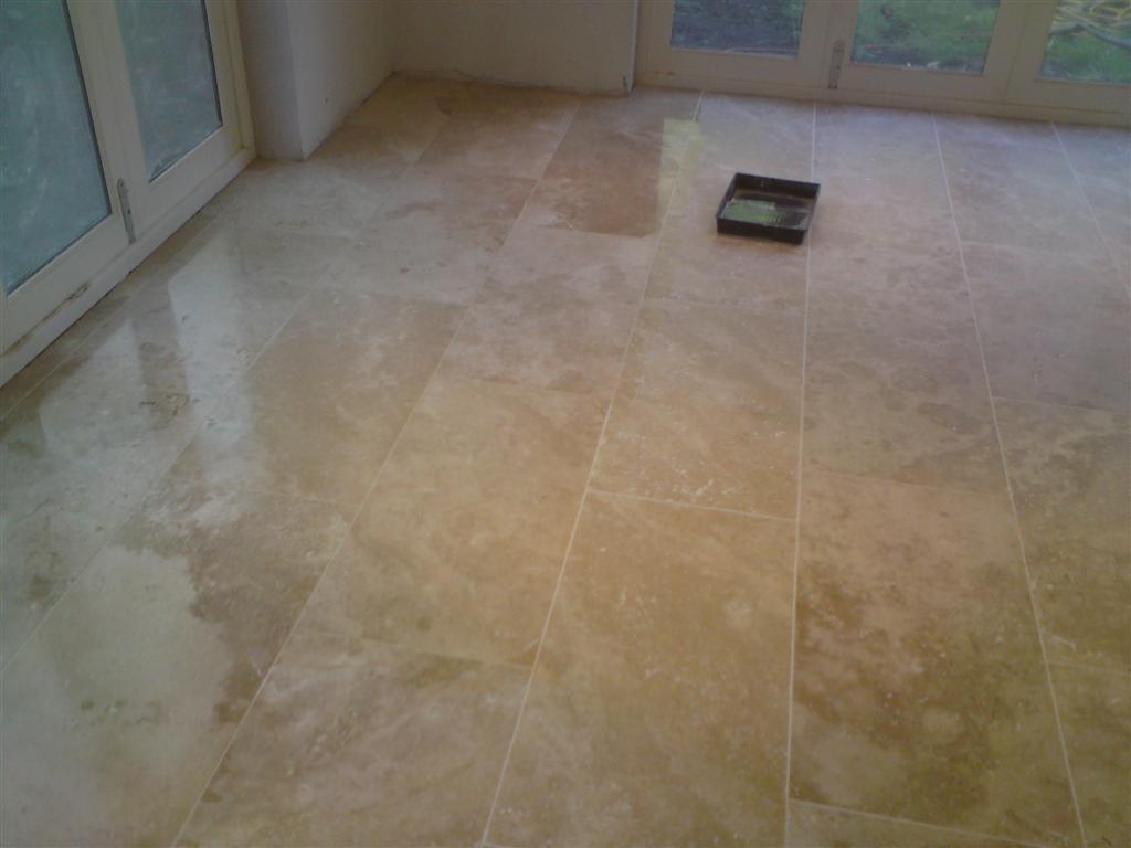

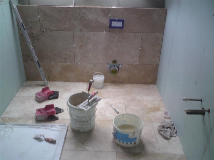

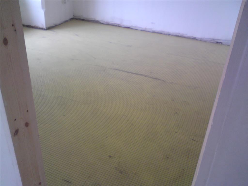

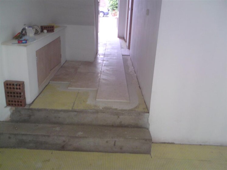

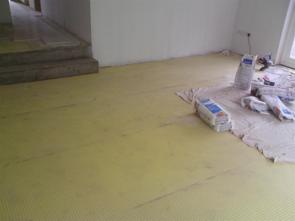

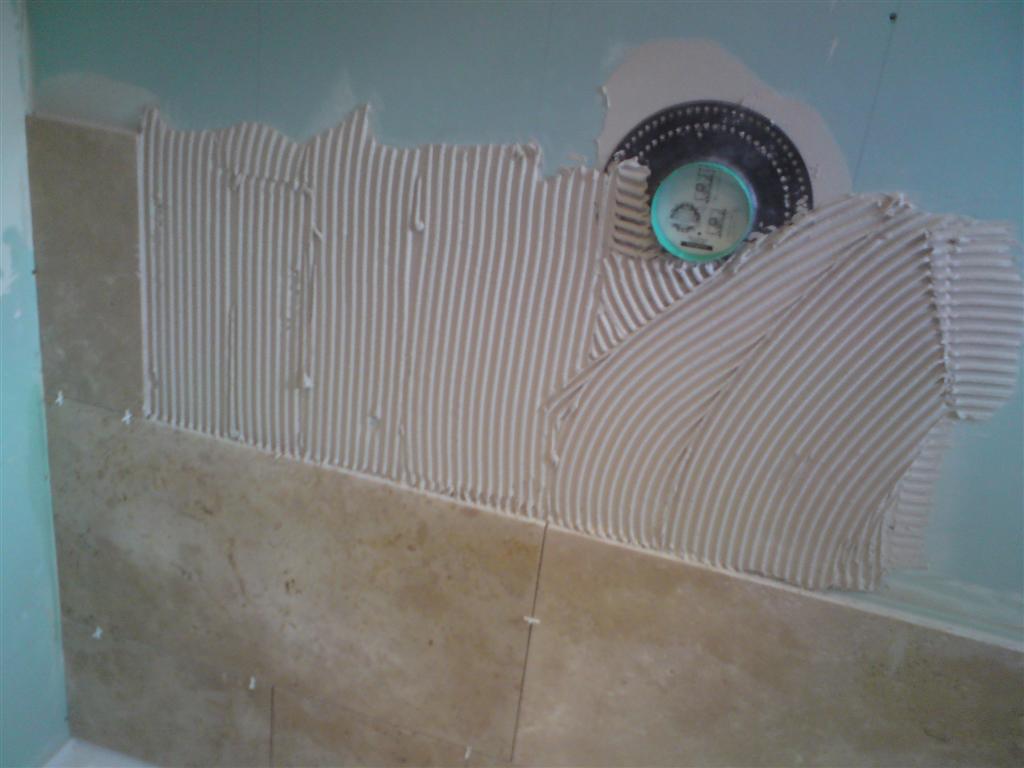

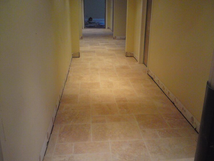

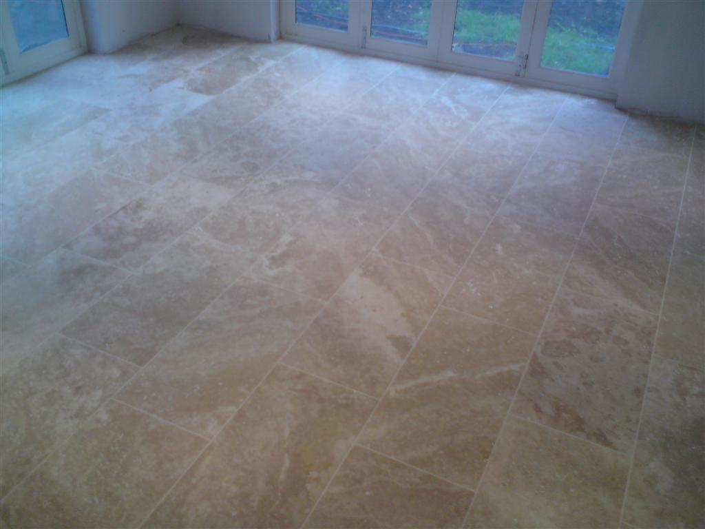

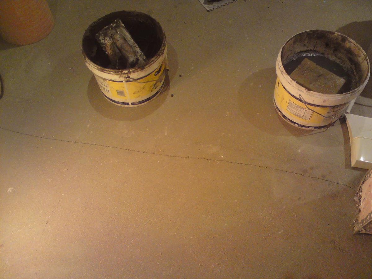

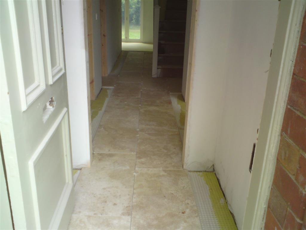

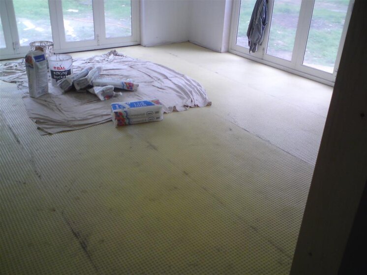

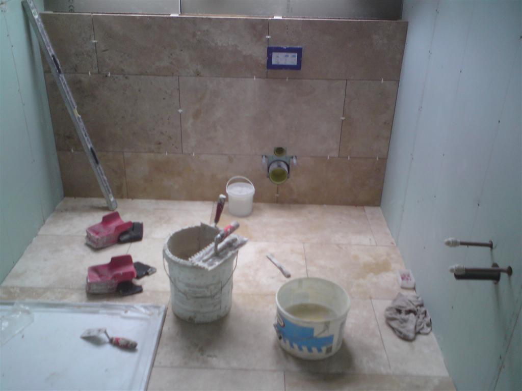

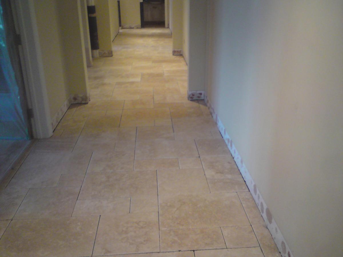

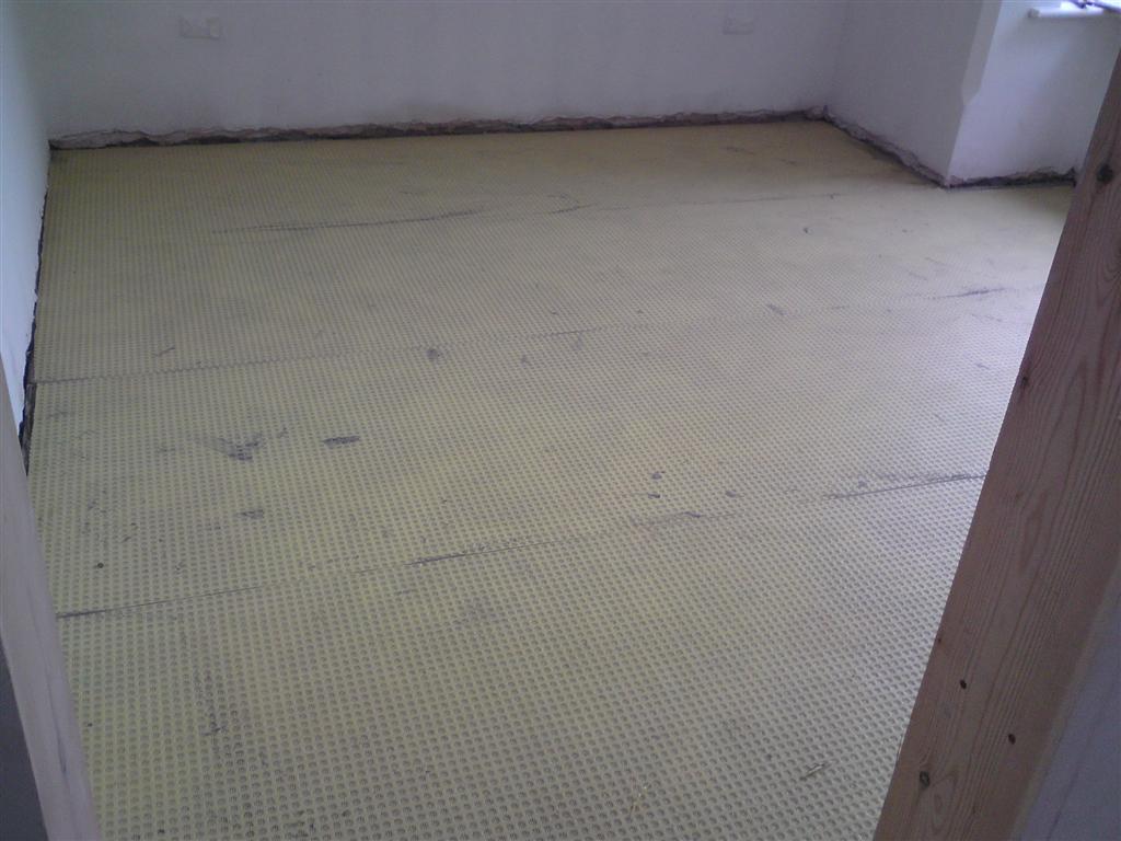

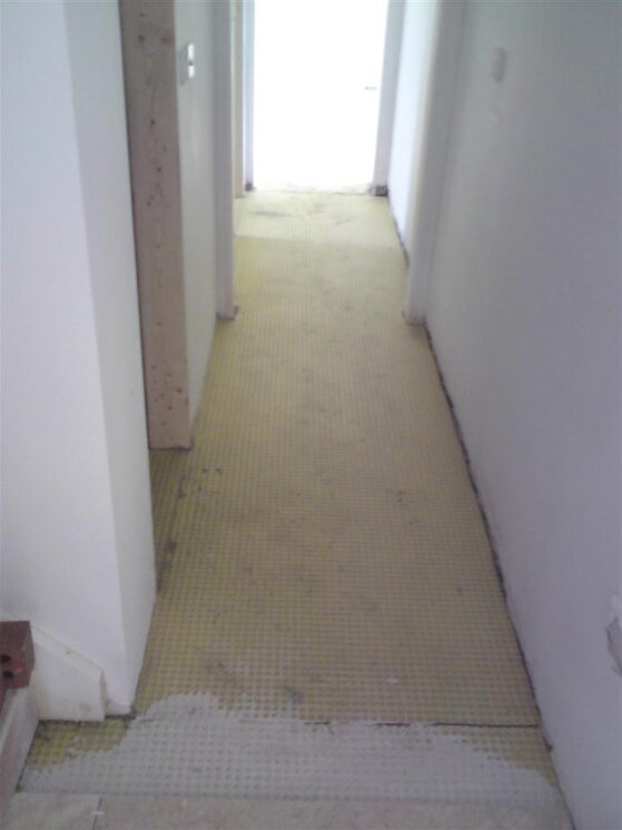

Just started a large job with Moccha brushed travertine 920x460 square edge and unfilled.
Supplied direct to the customer again from Perfect Home and garden stone products suppliers.
First process was to clean and prime the floor and then lay Dural Ci throughout the ground floor, which totals 170 sqr mtrs.
The property has piped heating which is ground source supplied and will be supplemented with solar panels and a log burning range cooker for running costs.
So we set from the hallway as requested and then this works into the rooms leading from that.
I also have 3 bathrooms to do in the same stone..
So i will add pics as i progress with the job..
So here's some pics of the job so far.

Sorry forgot to add.. yes it is random bond.. this is to create that none uniform look..
I get these jobs from my website and recommendations from Perfect Home and garden..:thumbsup:
Total mtrge for this one is 220 mtrs including the bathrooms.

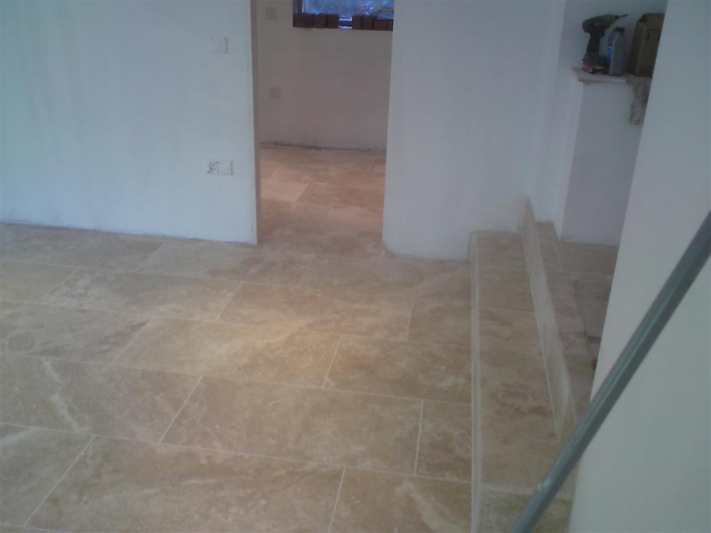

Just an update on the tiling with the moccha travertine..
Some pics of the living area and some steps leading into the hallway with bullnosed edges.
And some pics of it getting some sealer applied.. ( Aqua-mix sealer's choice gold)
And the upstairs bathroom i started and is now complete , will get more pics this weekend..
The kitchen is going in , so stopped me getting pics of th at area as the floor is covered up at present..
So more pics to follow as i progress..

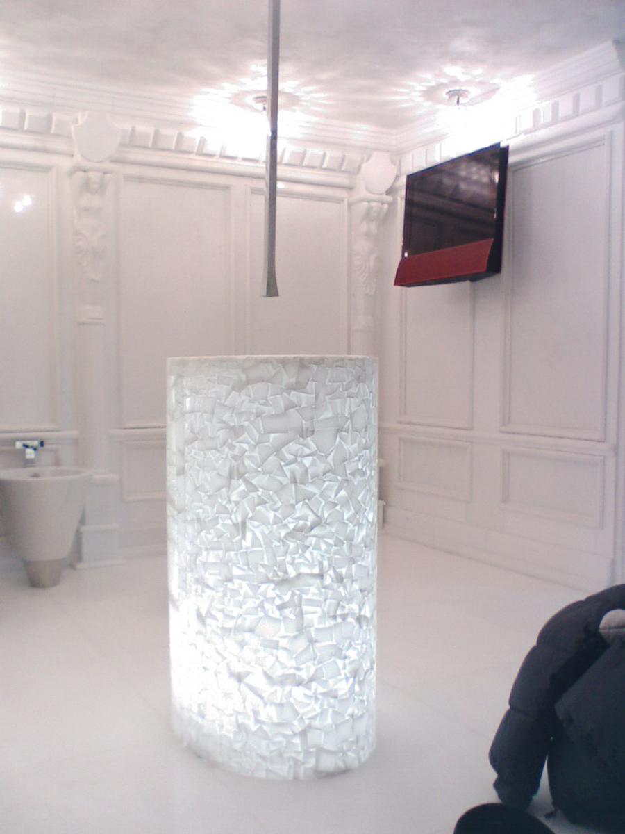

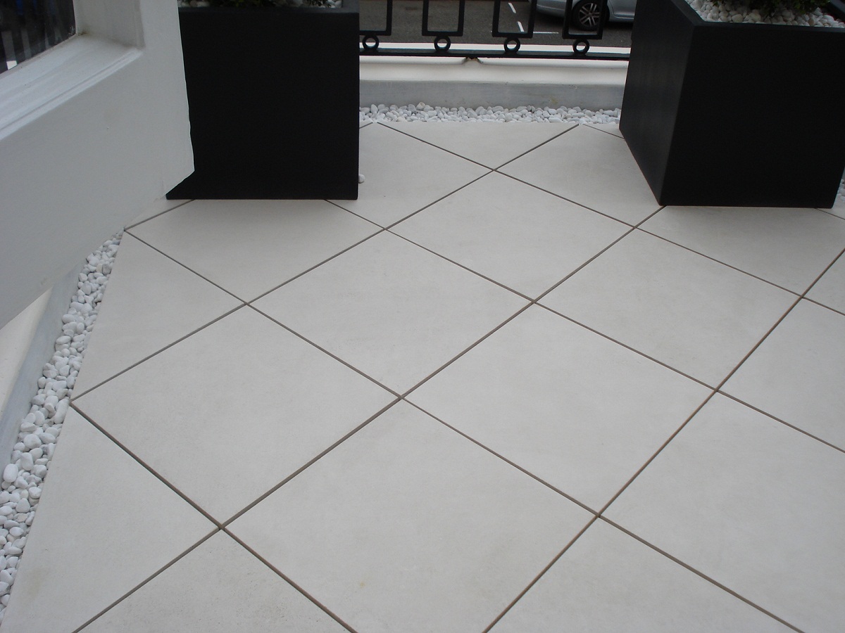

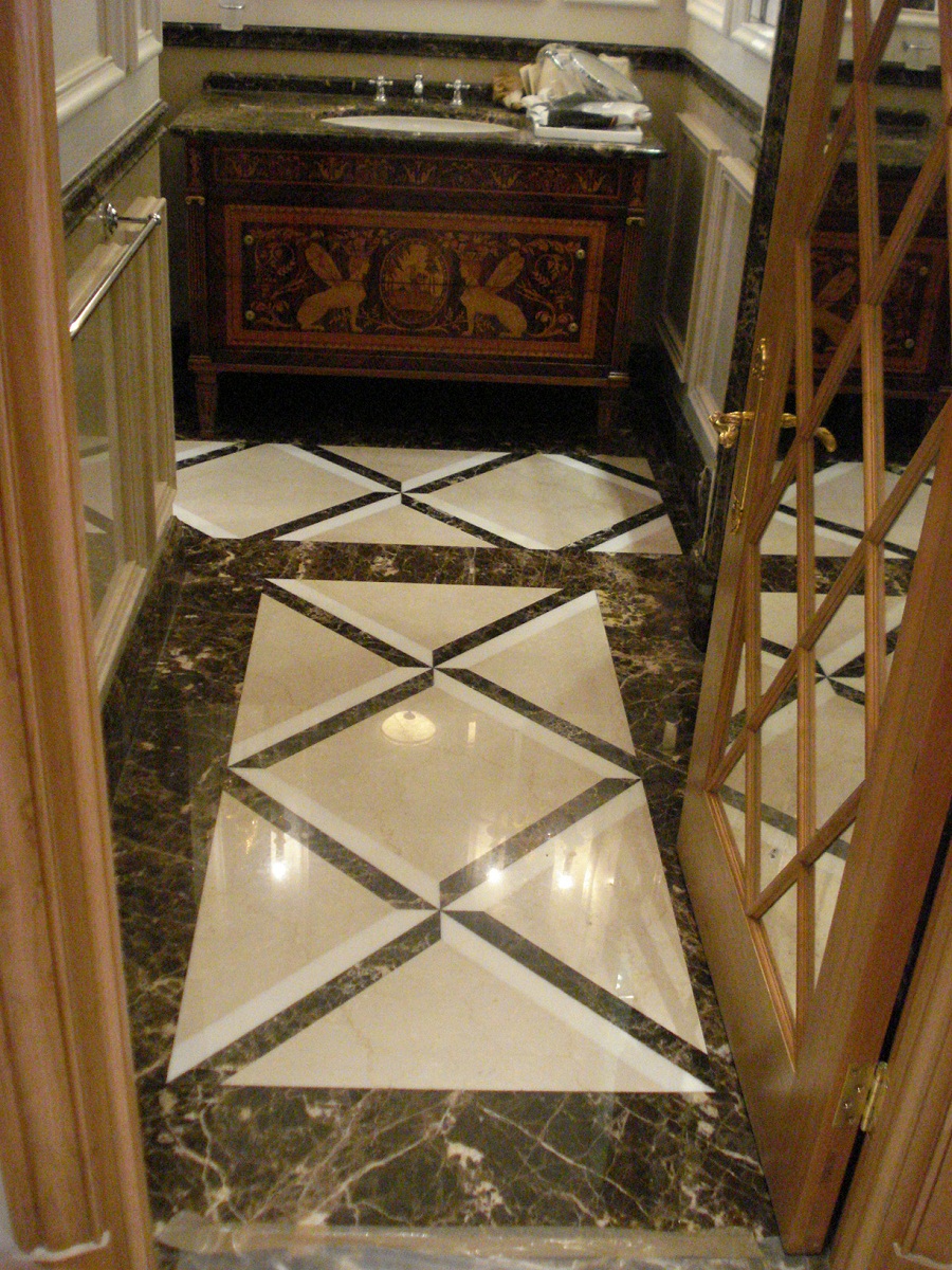

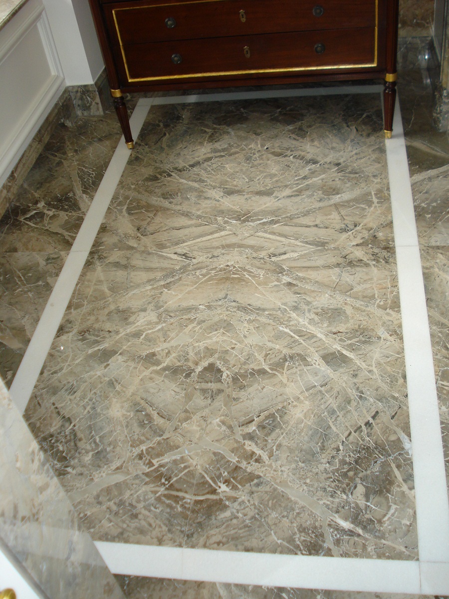

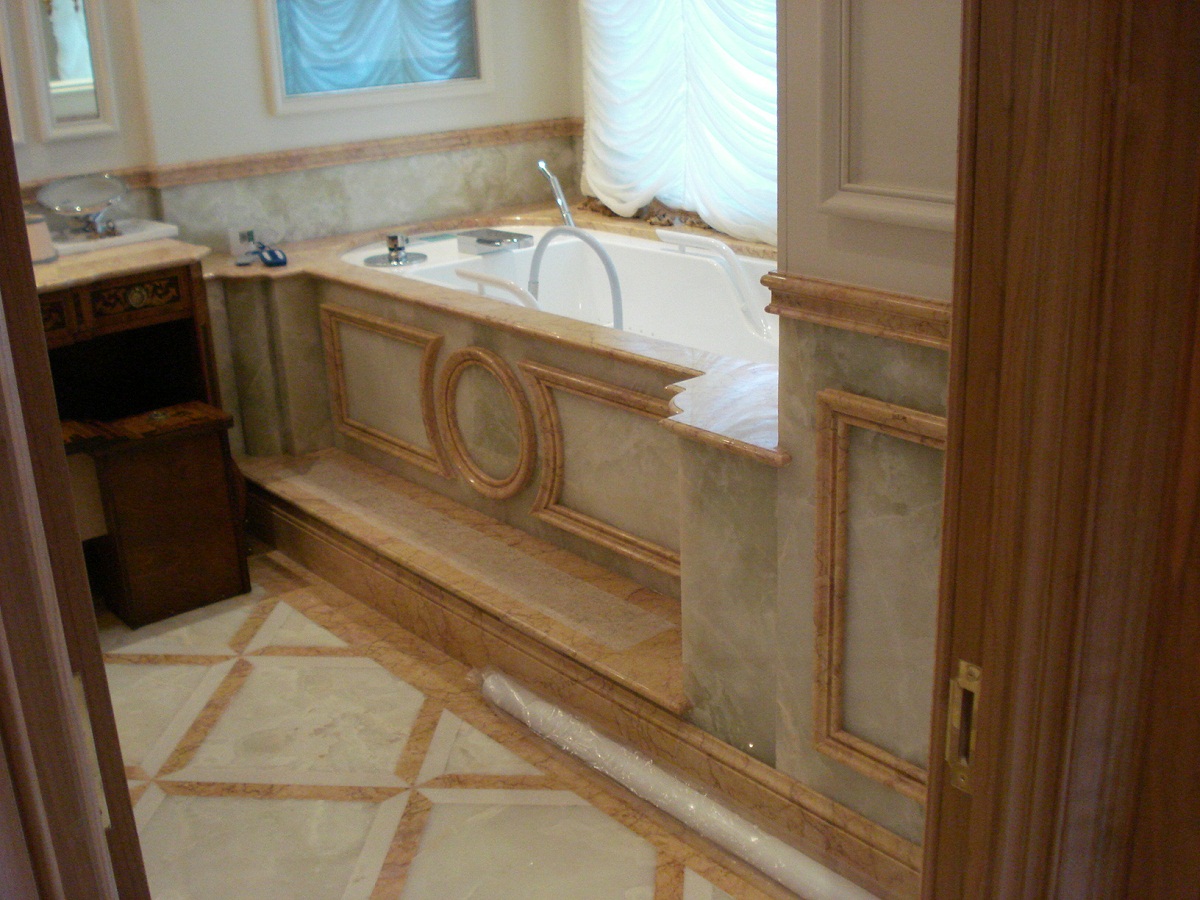

Just snagging the last bits of this job in Central London, heres a few pics... I included my little balcony, because I wanted this to be kept plain and simple. I think the next contract I do will be following this trend, no more fussy patterns, obscure busy marbles and onyxs..less is more.
