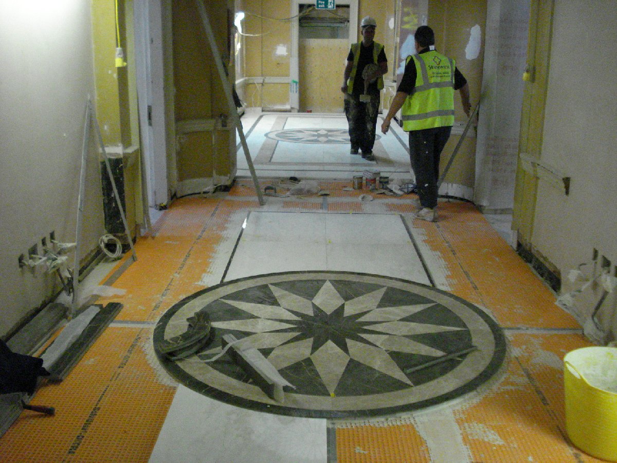

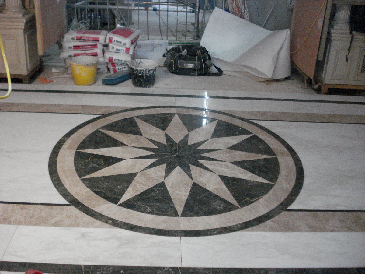

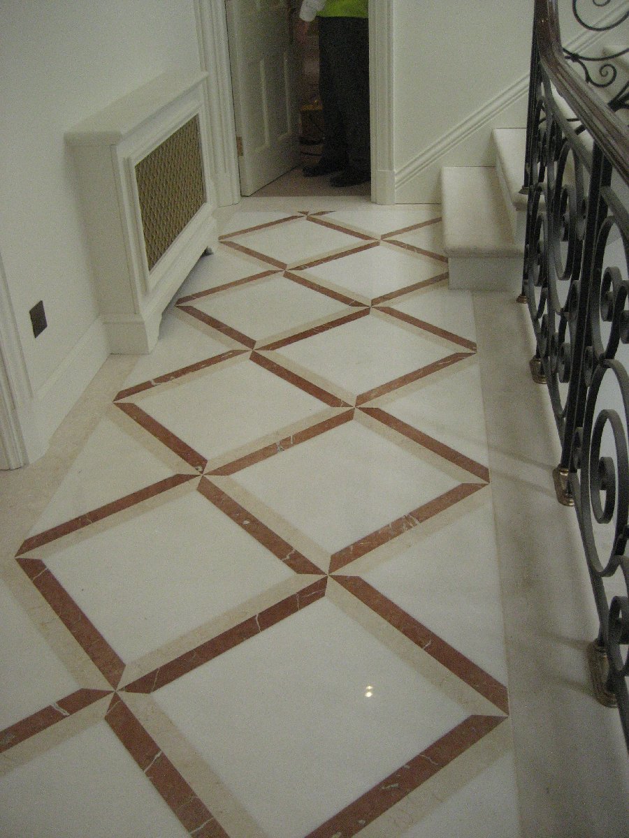

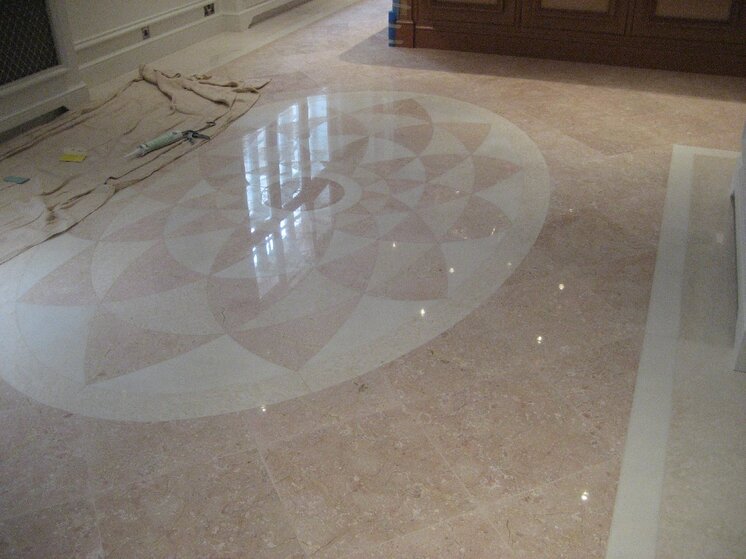

These are my work in progress photos, The total area is 100m2 broken into 4 bays. I had the first area dry laid, which is a good job because as it turns out there has been a load of cutting to do. Anyway were getting there now. I will post more when we are getting towards the end of this corridor?!
Pebbs
Aww thanks for that glad you like it.
Water jetted, and then found that everything else had been oversized and to be cut on site :mad2: Then found out that the central point has to line up with the chandelers which meant I had to start the setting out all again. Slow work, but its coming along nicely now.
Pebbs
Water jetted, and then found that everything else had been oversized and to be cut on site Then found out that the central point has to line up with the chandelers which meant I had to start the setting out all again. Slow work, but its coming along nicely now.
Pebbs
I did a very similar job, only in travertine, in an office building a few years back and had the exact same problem Lyn:mad2: Only I sent the whole lot back to the water jet company who turned it back around in 48hours for me:thumbsup:

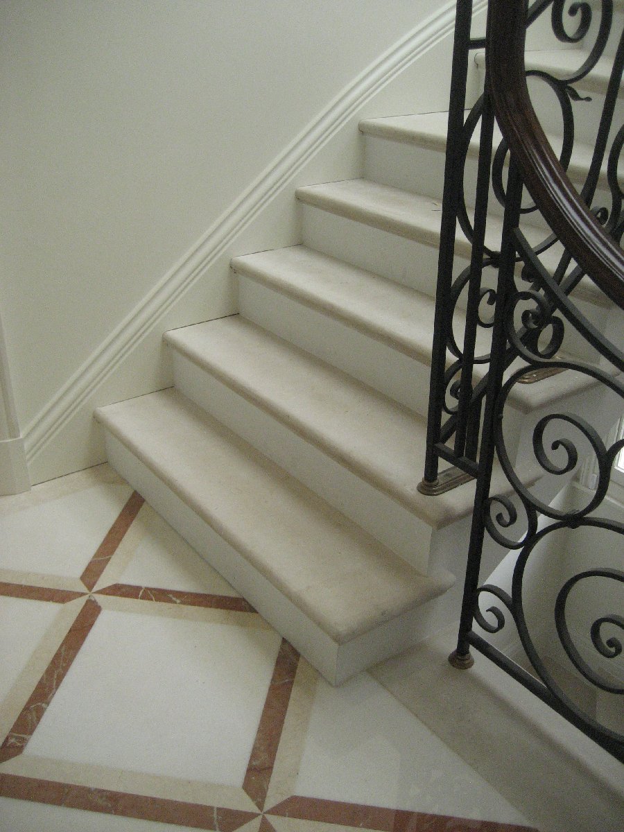

Some time ago I advertised for some stone fixers for this portland stone staircase, anyway it was all good and the job got done. These are a few photos from some of the areas we did, I'll try and post some other areas later this week. Had a bit of a quarrel on site and didnt feel like taking any more.
Before any of you eagle eyed lovlies point it out, yes I am aware of the gap between the treads and the stringers...My stone was in first so they messed that part up...time for a snagging session I think!

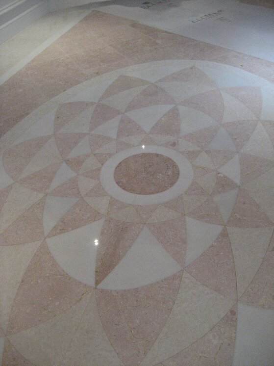

No Gary, all selected, fabricated and cut in Italy, and had it dry laid over there. That way I only had to worry about it arriving safe and sound. I got another more complex one arriving shortly, I seem to going through a phase of wanting to do difficult stuff right now. Its keeps it interesting for everyone!

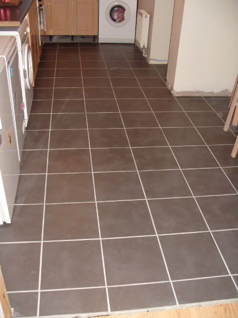

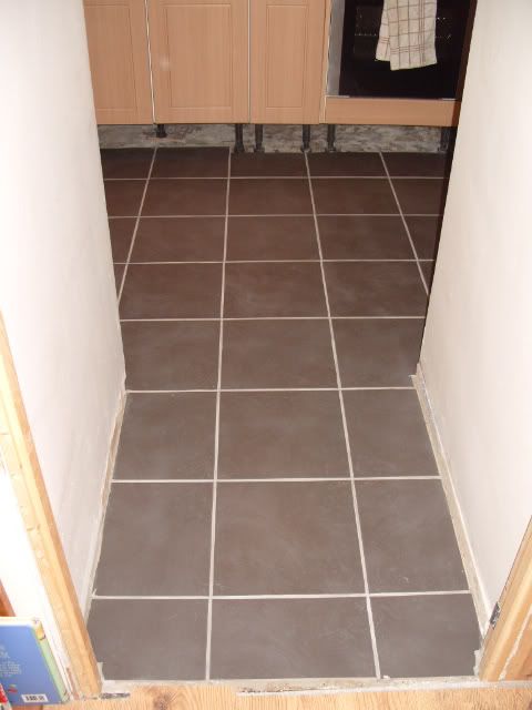

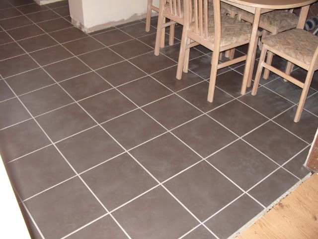

I did a kitchen/dining room for a mate on saturday with 330 x 330 ceramics
in almost unbearable heat. Hard to work in them temperatures and made using rapid set interesting. :sunny:
