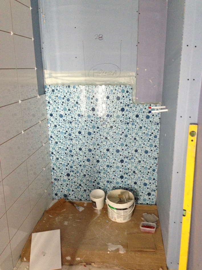

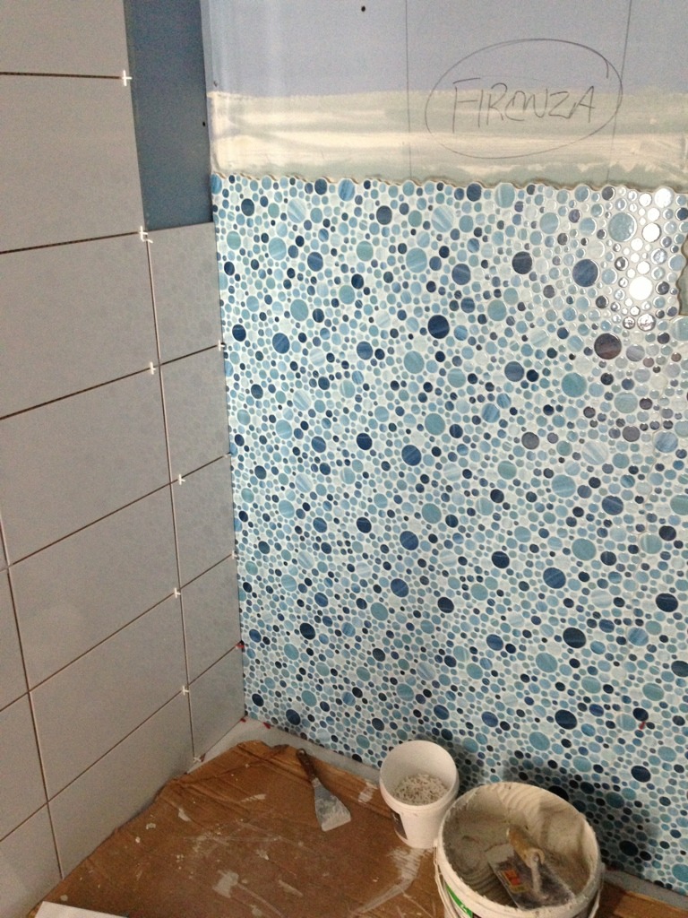

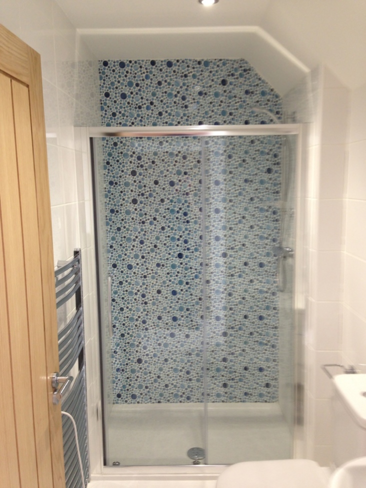

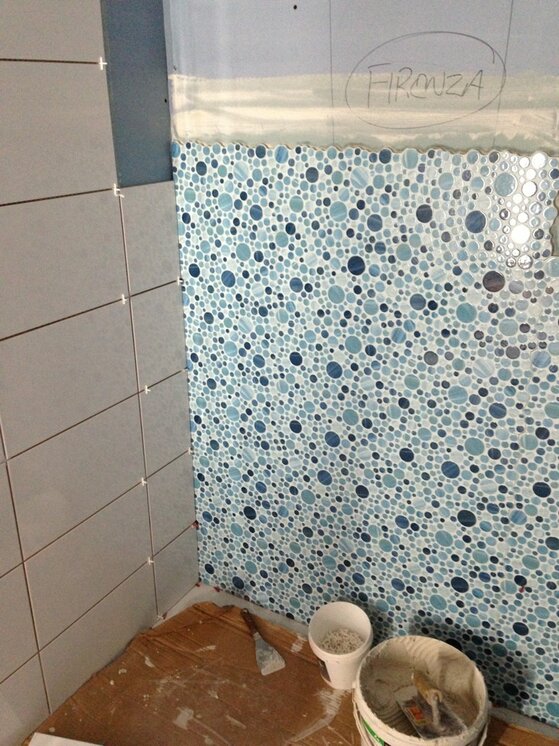

As JB states above this is a wall tile & cannot be fitted to a floor, even if that floor is in a shower area.
John Benton
2,214
Didn't you post some pics of this tile a bit since Stef of a feature wall you did?
