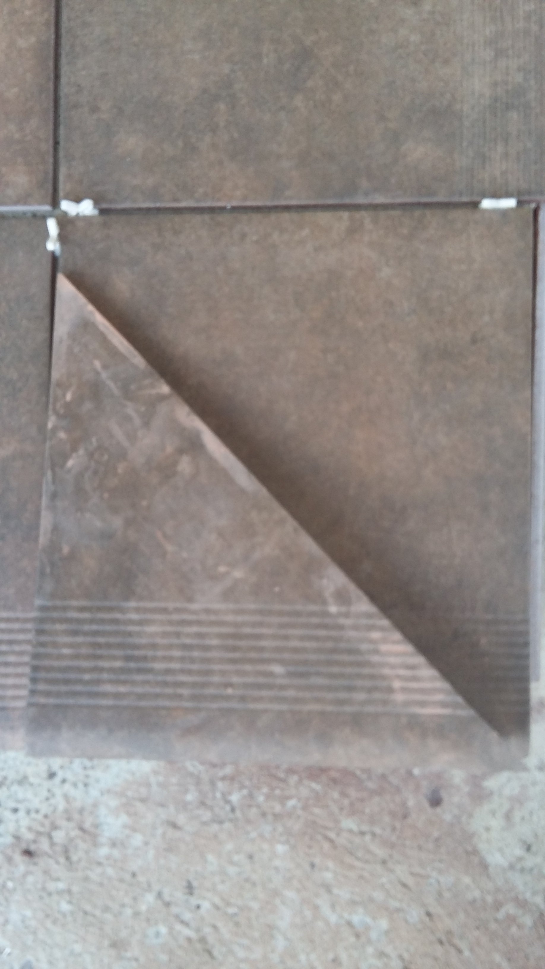

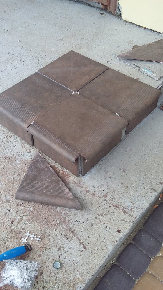

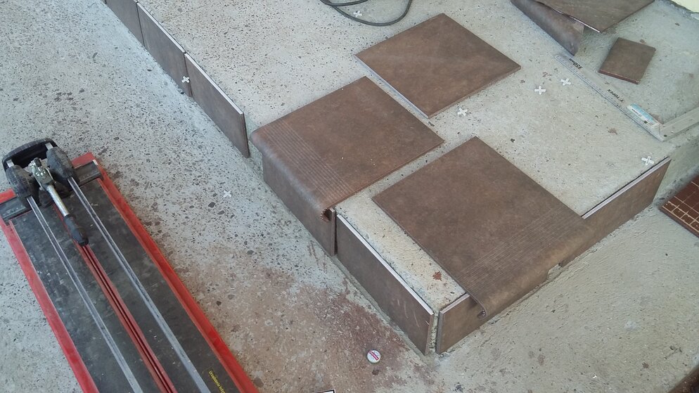

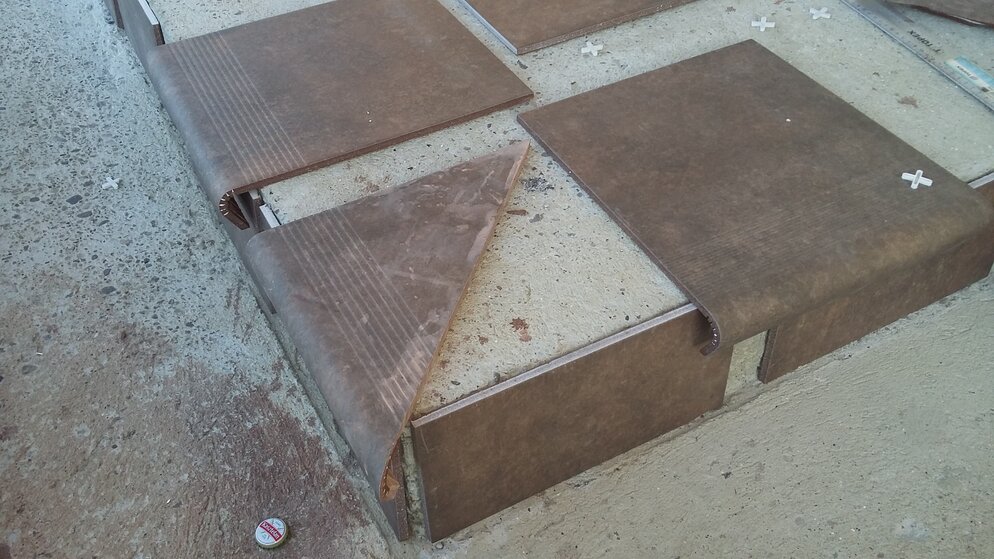

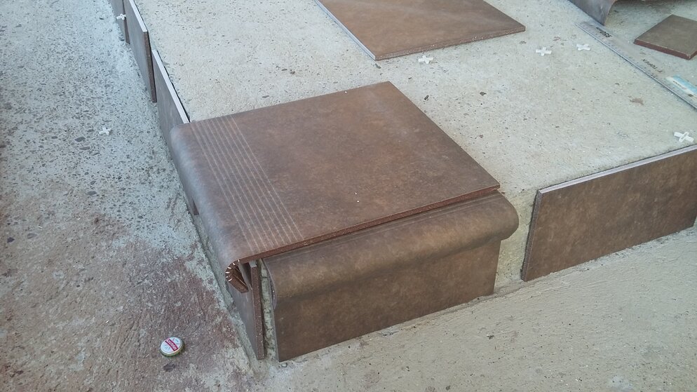

New to this forum and I have done quite a bit of tiling in my life but I am not an expert by any means. I am trying to do the front landing of my steps in a v-shaped tile and am having a hell of a time with the corners. The problem I have is that the corner pieces are 32cm long where everything else is 30cm. There are no corner pieces, only straight corner pieces (That sounded like it made no sense). Meaning, for the corner (not the edge) the pieces have to be cut diagonally somehow. I just can not get it to work without messing up the length of the run in either direction. My wife is convinced it can be done without cutting the entire run in one of the two directions. I dont think its possible without cutting, but if someone could please tell me how, I would be eternally grateful. Here are pics for you can understand exactly what Im talking about...

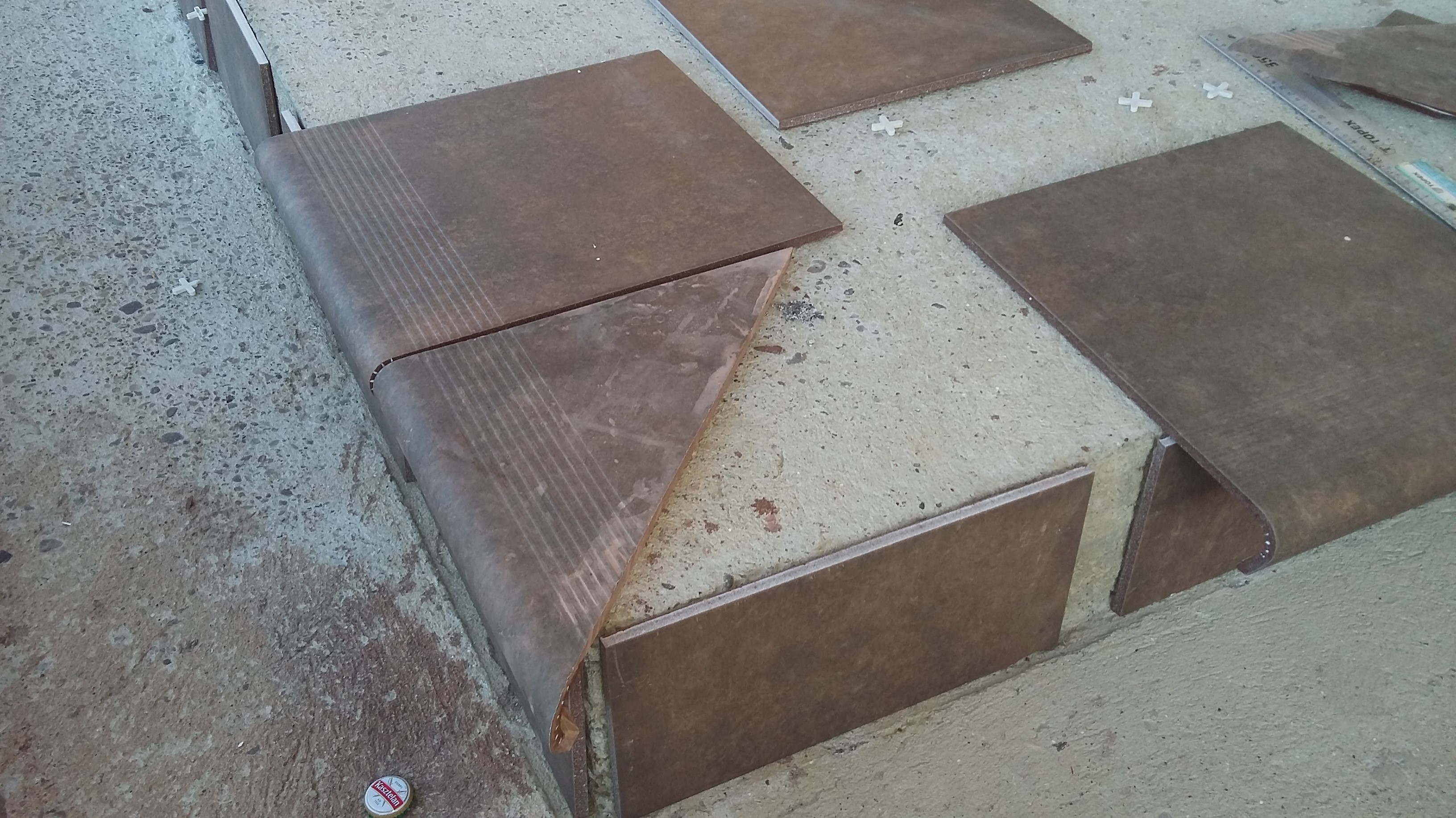

To have the grout lines all line up is next to impossible (notice the huge gap on the corner). If I cut corner to corner it will end up being diamond shaped. If I cut a few cm shorter (see pic) and square the two pieces it is much shorter. I want to just go ahead and do that and cut a few cm off all the other edge pieces, but my wife is not happy with that. Is it possible to do it without cutting all the other edge pieces?

If this is the Cerrad Plytka Kalahari range, external corners are not made in the V-shape. So because of the size I'm afraid you're fighting a losing battle. They're only designed for steps with closed ends.
For this situation you may have been better off opting for the standard 30x30 steptread RE and REX, and overhang the step by 12-13mm so the upstands sit flush with the underside.
The only way I can see it being done is by doing a bit of a jigsaw puzzle using 4 edge tiles and 2 plain to fill in the gaps. but its going to look ugly as hell and a nightmare to fit.

I would opt for taking the small amount off of the whole front row personally. Or you could infill that corner with a bullnose piece cut with two 45° cuts and fixing that in

If there is no v shape corner made for this range then your only option is to make it work as aesthetically as possible. One way I'd suggest is to cut two corner to corner diagonally to form the corner as you've started to do. I'd then cut both in a straight line parallel to ribs but say 5mm back. I'd then cut down a plain tile to fit the square shape. You could either leave it as a square or cut it corner to corner to follow the grout joint of the newly formed corner. Hope that makes sense!
Nope! :D Hahahaha ;)
Actually it does! Hehe :)
I'd wanna cut ribs off them all tho to make it all bond.
The way I would do this is to start with your external corner, (that is your set out point, everything emanates from that) bring the two pieces together until the front corners meet.
Square them off to each other as u've done and cut diagonally thro them.
What u've suggested is absolutely correct imo.
It will leave them short
Then cut the backs off the rest of the bull noses.
U won't get oblong pieces to turn 90o corner to corner.
U can't, not when one specific edge on the same axis has to be perpendicular to another.
It won't look wrong, in fact quite the opposite.
A lot of bull nose pieces are actually shorter than their field tile anyway, a cap piece if u will.
But the important thing is it will look right.
Little adjustments like these set you apart from others who would just miss match the corner cos it's easier and faster.
But if things are to look right, then u do what it takes.

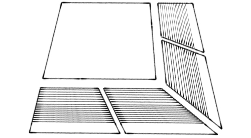

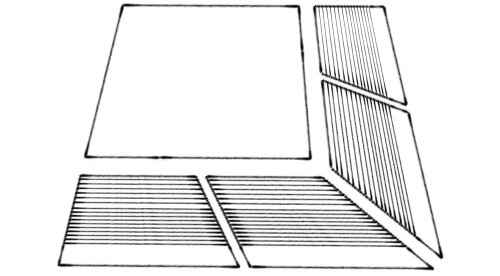

This is my idea about the Jigsaw, exploded. Might not be too bad if you can get the grout joints along the ribs around the main square. Can't do anything about the diagonal cross cuts other than make them even. If you want measurements and angles, let me know if this is an option. This will keep the main bulk of the tile free from cuts, but will take a little more patience than 3falls idea.

You need to over hang the risers so that the treads will cut to size on the new corner points. You can't start full tile (length wise) risers on both sides.
Tile Shop
Thought i had a great idea for a second. Then read the first post and saw he'd tried already. Simplest is to cut 20mm off the back of every tread. She'll have to put up with it as the best of a bad bunch.
Was racking my brain with this all day, then the simplest solution hit me.
Can't you just cut 20mm off the arse end of every tread and then mitre the corner? Then everything is 30x30 and will fit.
Yeah its extra cutting but makes sense. A wet cutter will file the edges as its going so won't be a sharpe edge like a ceramic. Gotta get it spot on though.
