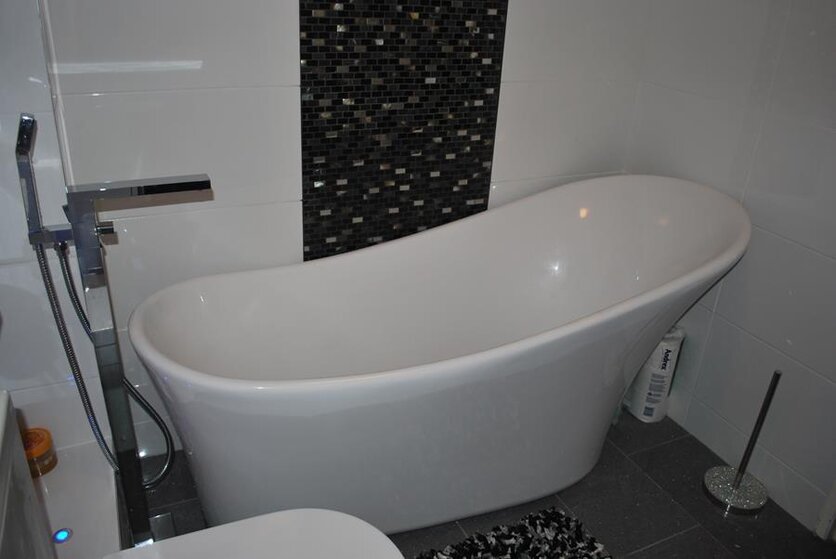

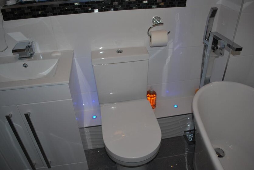

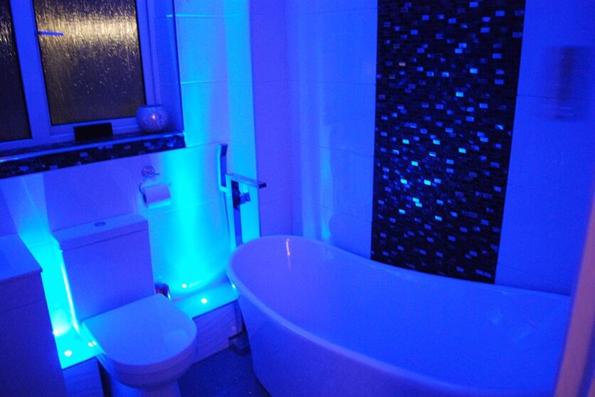

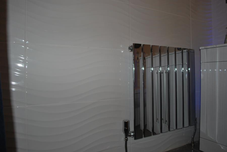

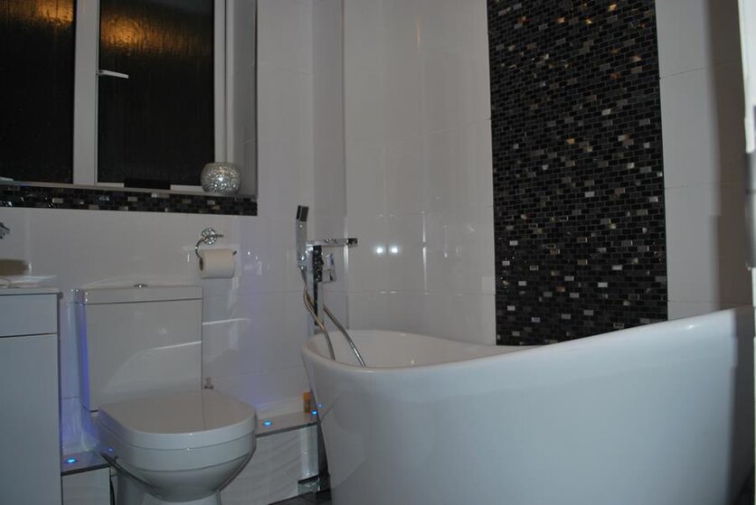

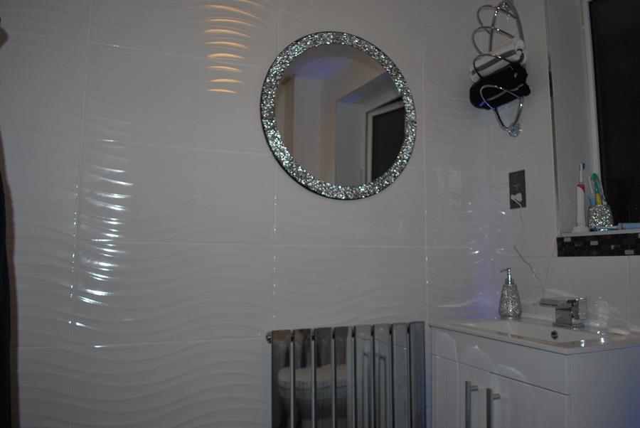

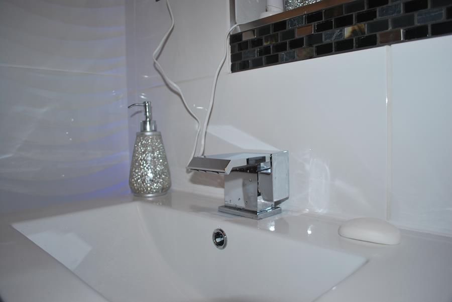

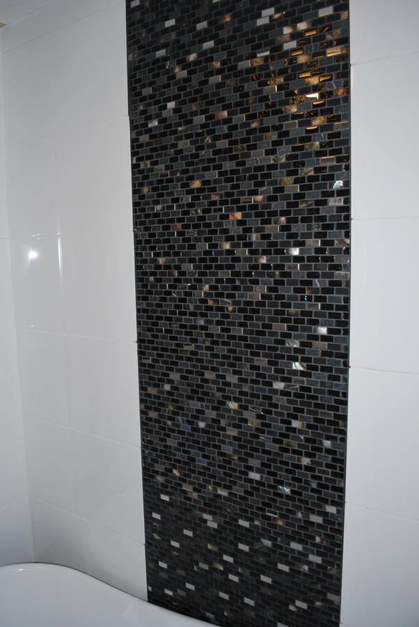

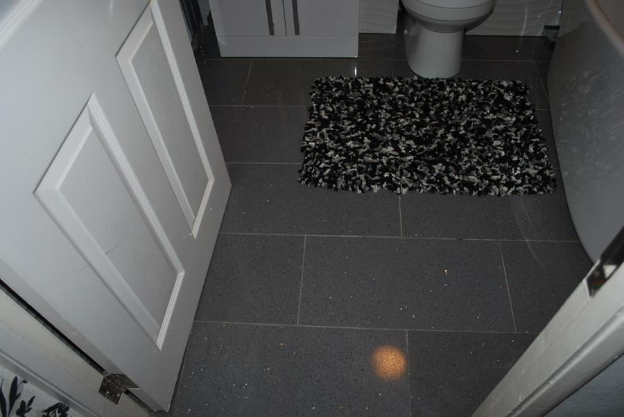

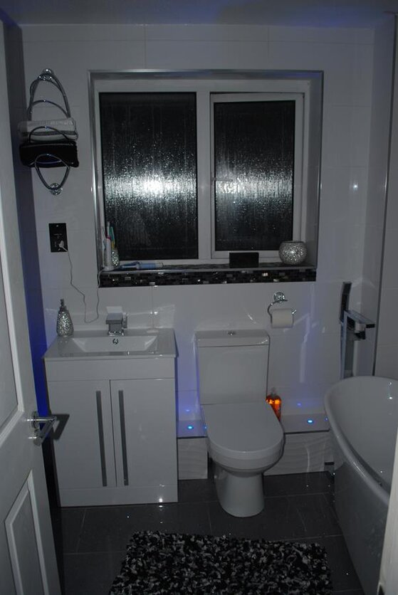

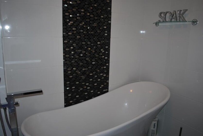

After a week of ridiculously hard work I've finally finished (well, after a little touch up with grout)
It certainly wasn't an experience I'd want to repeat anytime soon as it took me so long to finish and was bloody hard work. I'm happy with the results and very proud to be honest as I know that I cut and placed every single tile :thumbsup:.

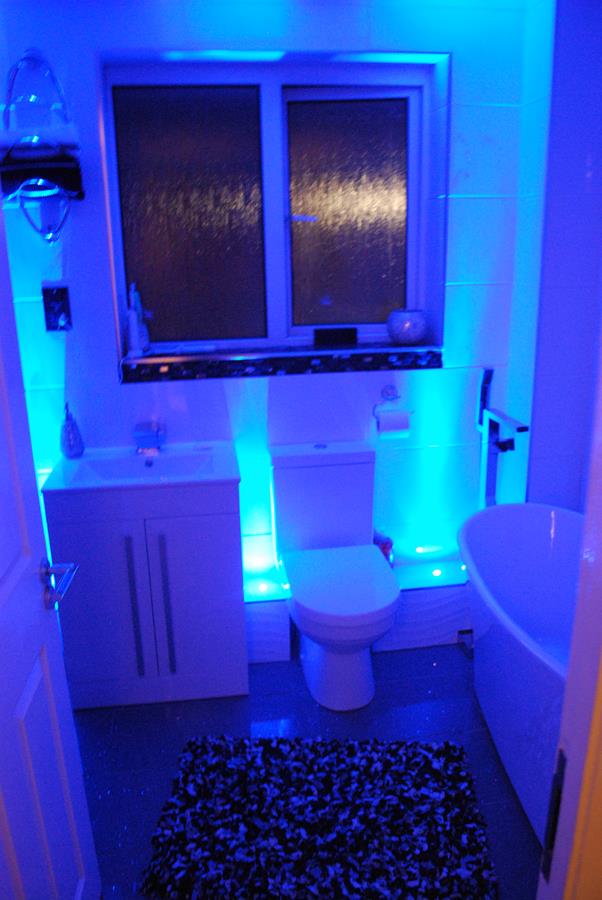

The worst part for me was grouting the mosaics. It was horrific.... We went for the mapei anthracite in the end and my other half was going nuts as it looked like we'd just ruined our mosaics, but after lots of washing off it all looked great.
The blue LEDs aren't as bright as they look in the photos and provide a nice soothing mood when having a soak.
Thanks for all you advice chaps!

Certainly looks the part!
My only critic is you can see the cut out behind the toilet.
Other than that looks lovely!
Do you mean the boxing? Yes, it was a bit fiddly because of the curved shape of the toilet. I could have made that box lower so it would fit tighter but I wanted them all the same height.
That's looking good, be proud what you have achieved, I've saw so called professional Tilers that can't tile to an acceptable standard like that.
Big weeel done..
