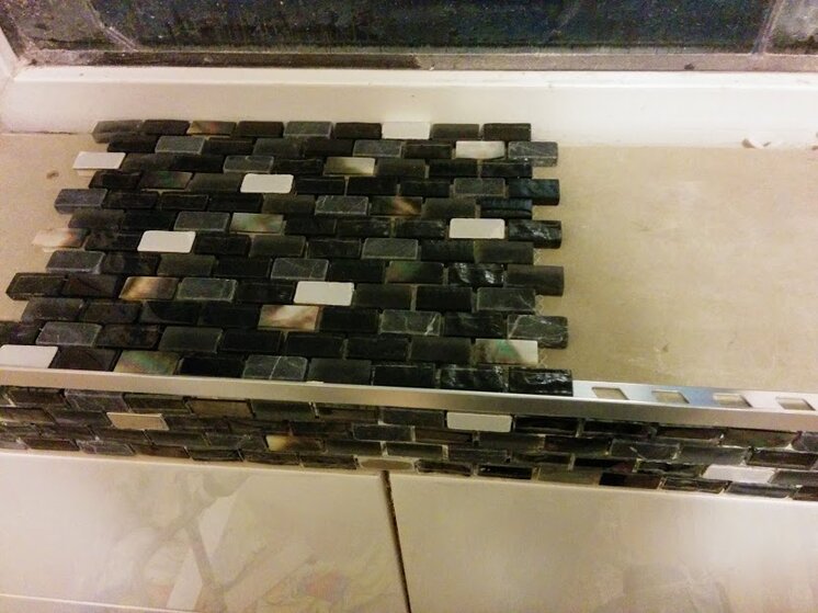

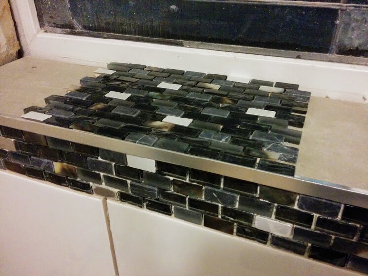

Started tiling today. Had a bit if a nightmare with the tile trim. I got the flat chome 12mm. Got a little confused about which way around they go? I know it sounds stupid but any tips or pics to help me out?
Cheers for that, so would this be the correct way to fit them? I'd started mitering them (not an easy task) but then I was convinced I was fitting them on the wrong edge!!
I hope your window reveal/wall is straight, you will find it difficult to bow the trim.
Also your trim will need to be fixed then feathered with adhesive from the inside towards the window so your mosaic does not lip near the trim.
