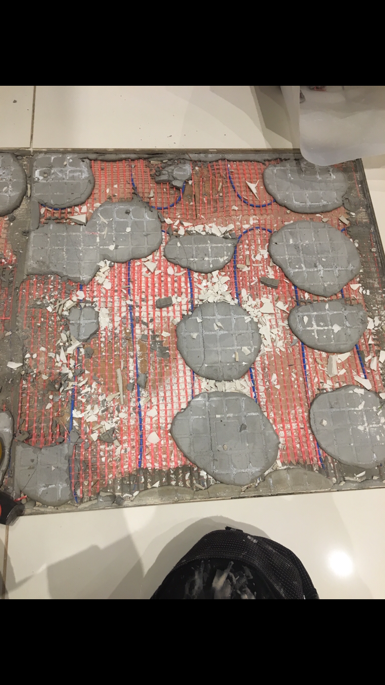

Sounds like a disaster waiting to happen. What was the process of laying the floor, from the floorboards up?
This was one I looked at earlier this year, kitchen floor. The build up was plywood, electric ufh and then dot and dabbed 60x60 porcelain tiles. 50sq m needs lifting and all redoing and the kitchen is sat on top of the tiles, island unit with granite worktops.
Don’t get the kitchen fitted over the floor until the problem has been rectified otherwise it will cost you a lot more money than it already will do
I like the fact they have ventilation around the cables to induce thermal convection to make the ufh more efficient
