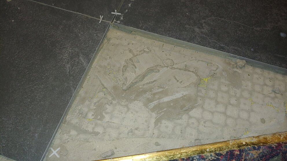

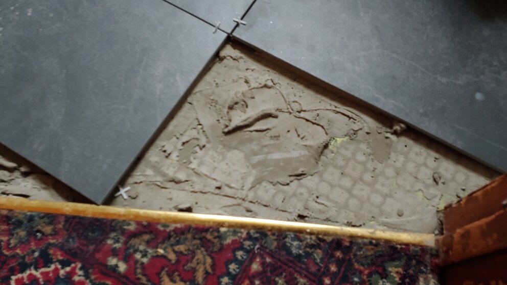

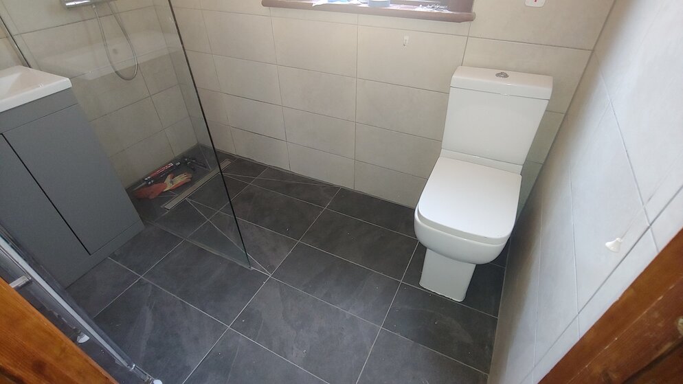

Recently had a building company replace a leaking wet room floor, located on the 1st floor of a 1930's built terrace house.
The tiles are large format porcelain tiles sitting on a Ditra Matt supported by 18" plywood. The rusty trowel that he left before the bank holiday w/e gave me some concern.

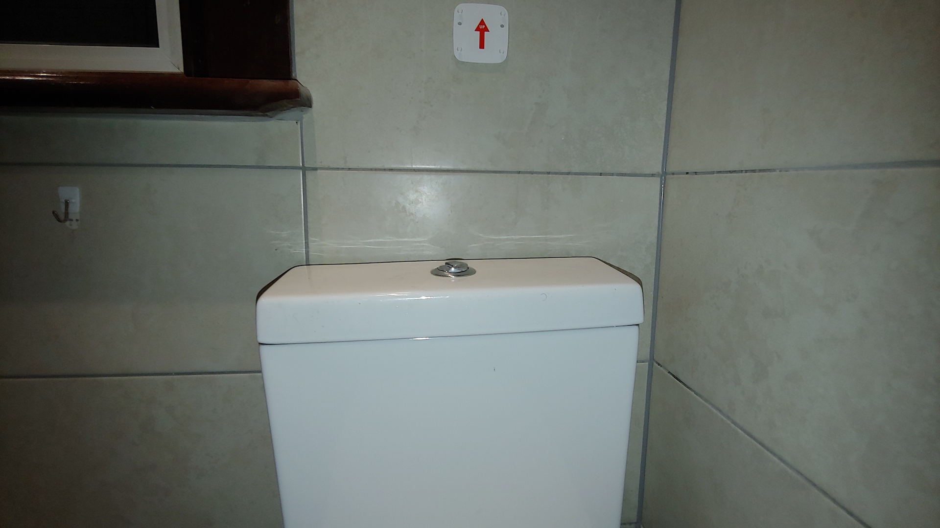

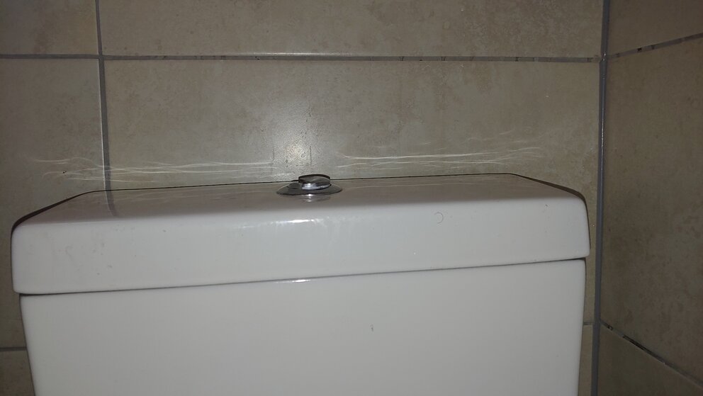

This morning I couldn't help but notice this morning that the top of the toilet doesn't line up with the grout. The toilet is located on the far opposite walll where the shower is located.

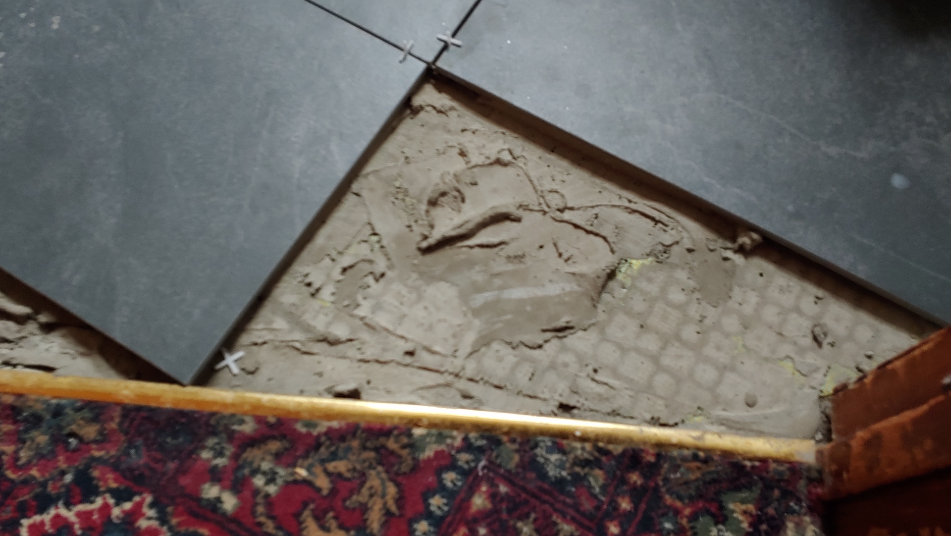

I had previous concerns that the installer didn't use a notched trowel. I could also see gaps in the adhesive applied to tiles he had laid.
The rusty trowel that he left in a bucket of FastSet before the bank holiday w/e gave me some concern.
He came back yesterday to finish off laying the rest of the tiles. He was due to come back today to connect the toilet and taps (didn't have the right sized connector), but he didn't pitch up.
I've attached photo's mid job and when all the tiles were finally laid.
Any feedback or advice would be most appreciated

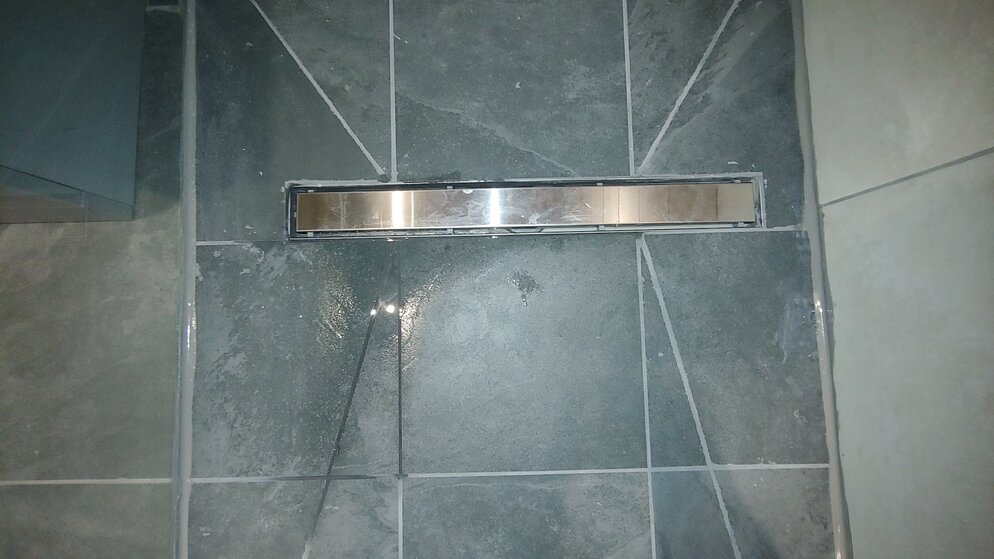

Hi and welcome… the first thing that hits me straight in the kisser is the envelope cuts on the shower tray , they are not lined up tpo the end of the linear drain as they are supposed to be.. hence why he has lippage at the drain ends. And jeeeeez!! How much silicone has he used . I’ll be honest i would be worried as well.

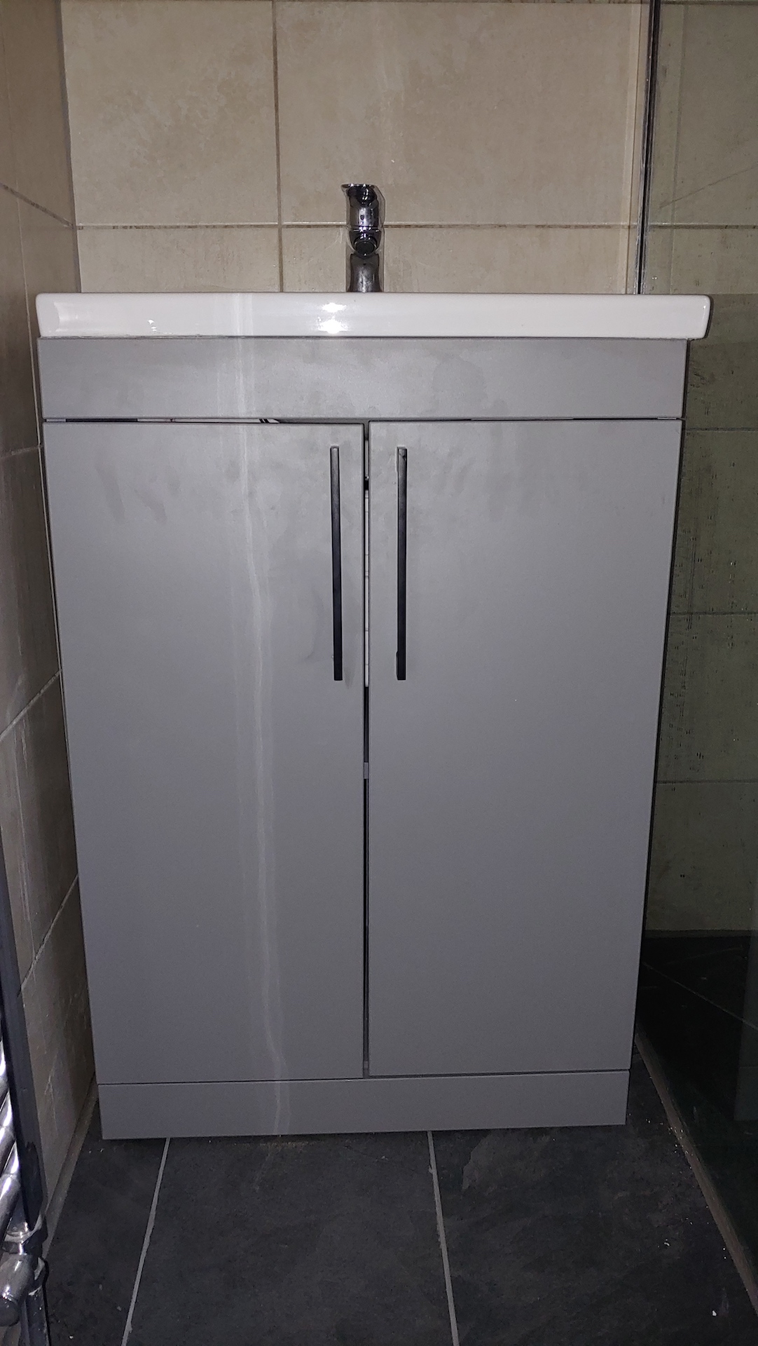

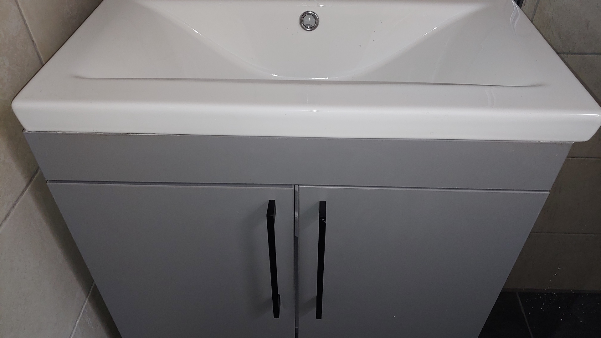

The sink doesn't sit in alignment with the top of the vanity unit. As you can see from the photos, the top of the vanity unit is exposed on the left side of the sink. I pointed this out to the builders boss and he tried to fob me off with a gap was left there for "easy access or cleaning that side of the shower screen". Note, there is double the space between the vanity unit-shower screen (~60mm vs ~30mm) and the vanity unit to the wall, although the sink sits more or less in the middle between the wall and the shower screen.
Anyway, today my mum said water was leaking again into the kitchen. I only poured around a 1 litre of water down the drain today!! The shower was has only been used once since the builder left. I strongly suspect that there is a void under the tile, where the lippage is). Water was still present in that location 2 hours later and the grout is obviously still wet. I'm thinking what was the point of having a shower tray, which was an afterthought by the builder. Should've listened and acted on to my inner voice...

It's a shocking job, linear drain falls are completely wrong, location of linear drain is wrong, the setting out is wrong and not a good tiling finish, did the yea ahh person even do the correct preperation and install a wet room tanking system???

I’m hate to think what it’s like underneath!
Agee it’s a rip out and start again. Poor preparation is preparing to fail.
