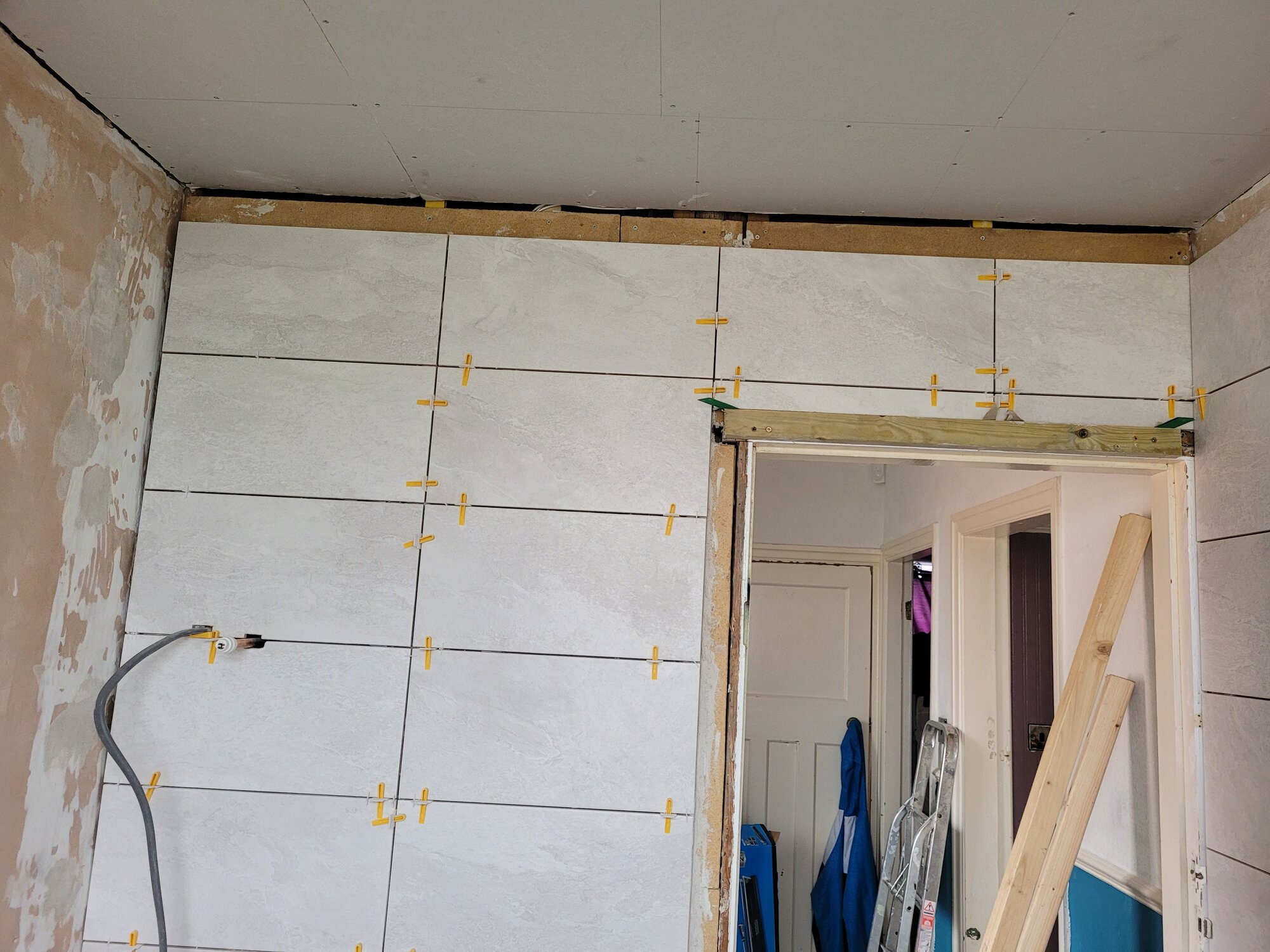

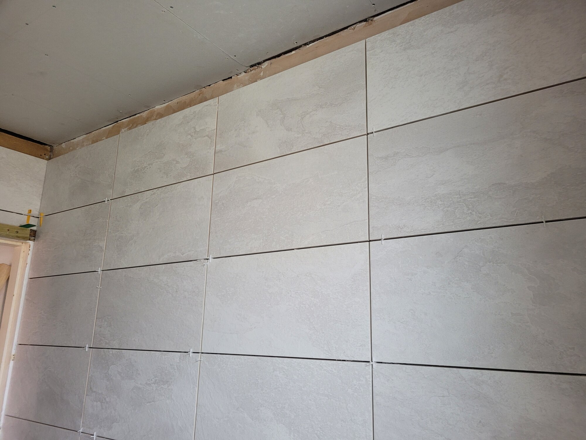

Had my bathroom ripped out and plumbers first fix at weekend. Tiler I had turned up Sunday. Did an hour and half. Did half a wall that looked a complete mess. I tried to put it right but couldn't. Me and my missus decided they would look horrendous and got rid of the tiler. No one could come at such short notice so we decided we'd have to do it ourselves. Il upload pics when it's finished

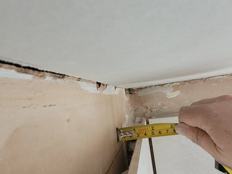

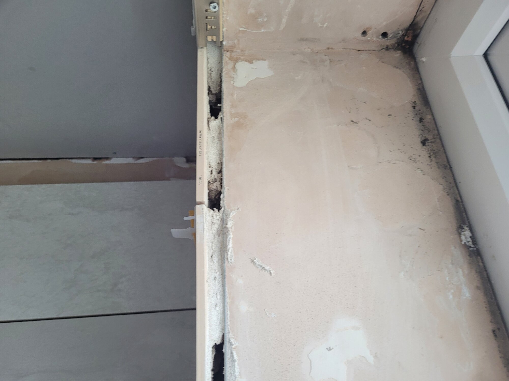

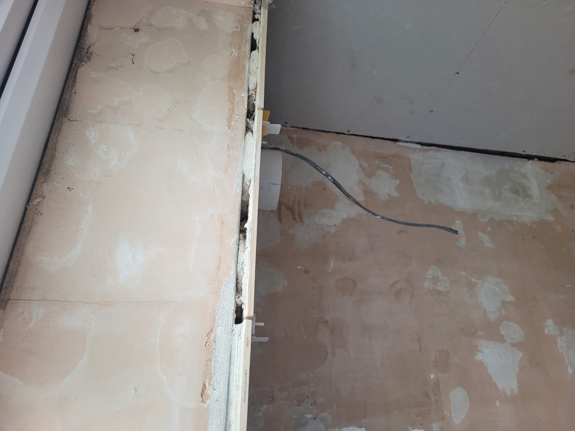

All the lines are straight and level. I primed the walls. I've made a mistake by fitting window trim after. The tile is 10mm thick and the adhesive bed in places is thick due to the walls being so far out. So the trim doesn't sit on the window itself it sits part on the window. A tiny bit. Then on top of the tile
The walls are shocking as well. I didn't expect a perfect job but honestly the gut was a retired tiler who I think couldn't be bothered. My main concern is in places the adhesive is 20mm thick to compensate for walls being out. The tiles are 500 wide by 250 high and 10mm thick. The adhesive bed is 6mm to 10mm. In some it's 4mm. The max is 20mm. Now my worry is is this too thick. The tiles are solid. The ones high up are the worst out so were the adhesive is thickest and that's what concerns me the most.
