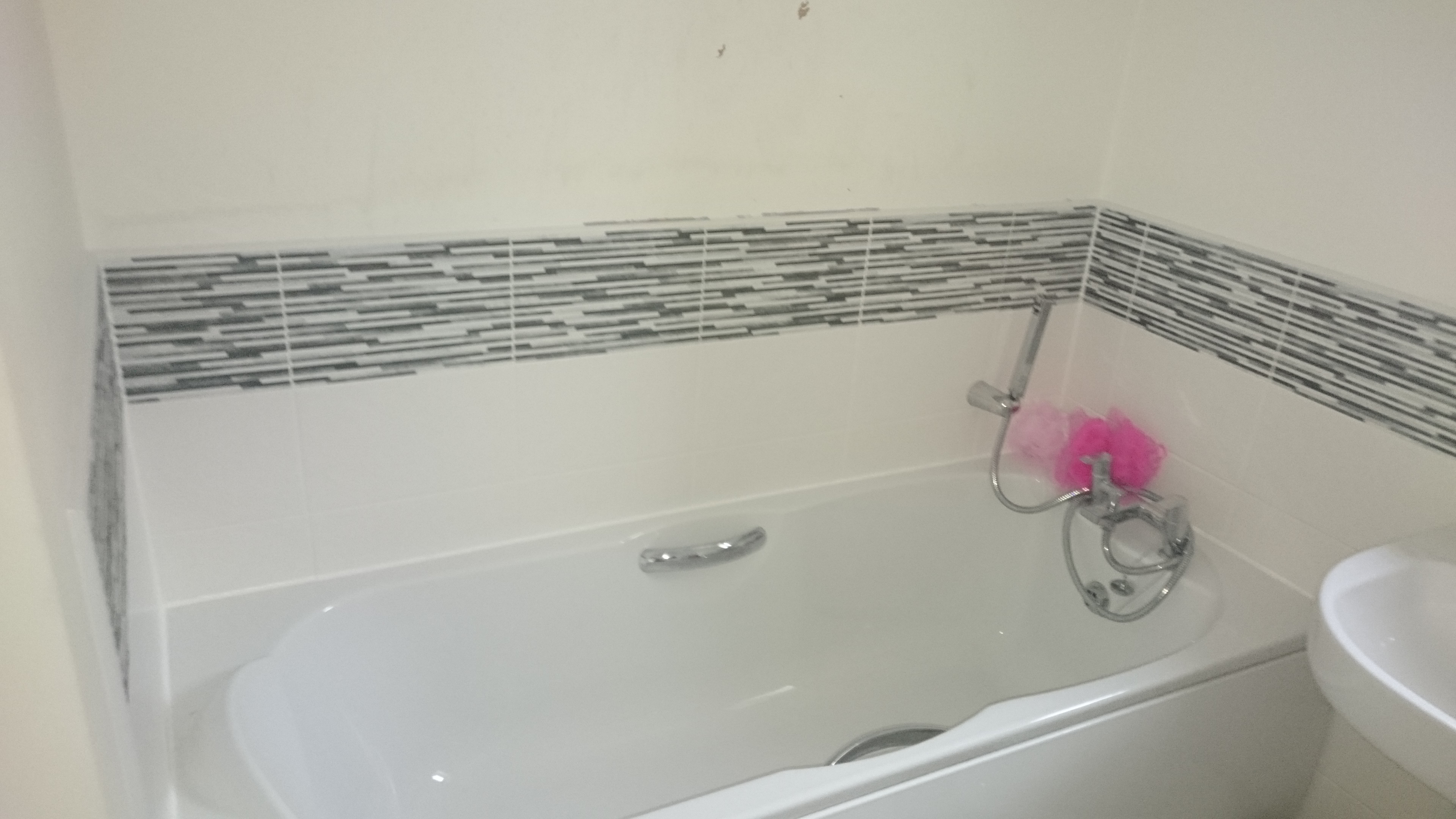

Nice to be on this forum, I am trying to tile my bathroom wall as the builders only did about a fifth of it when it was built (house built 3 year ago) and I was wondering if I could get some advice.
The existing tiles is a Porcelanosa bali nieve 20x31.6. what is the best adhesive to use for this, can I just use general adhesive like the Wicks own brand?

hi,
It is a plasterboard, yes i was looking at the the Bal on Topps tiles Bal Green Star 15kg | Topps Tiles - http://www.toppstiles.co.uk/tprod2927/bal-green-star-15kg.html.
it is for a small area, like i said in my previous post there already tiles on the wall, just looking to add a few more to it.

Could you post some pictures of the job to help us understand better? Will be easier for some of us to give advice

Hello,
thanks for all your reply. @Plan Tec Tiling the wall is painted @jcrtiling am not really fixed on using topp tiles i just got suggested that, so what ever is the best option i am open minded. I will also like to mention that in future we could be putting a power shower in there. i have attached some pics hope they help.

Remove paint from the walls to be tiled.
Prime walls with acrylic primer.
Fix new tiles to walls using a standard setting bagged cement adhesive.
Grout with a bagged cement based grout.
