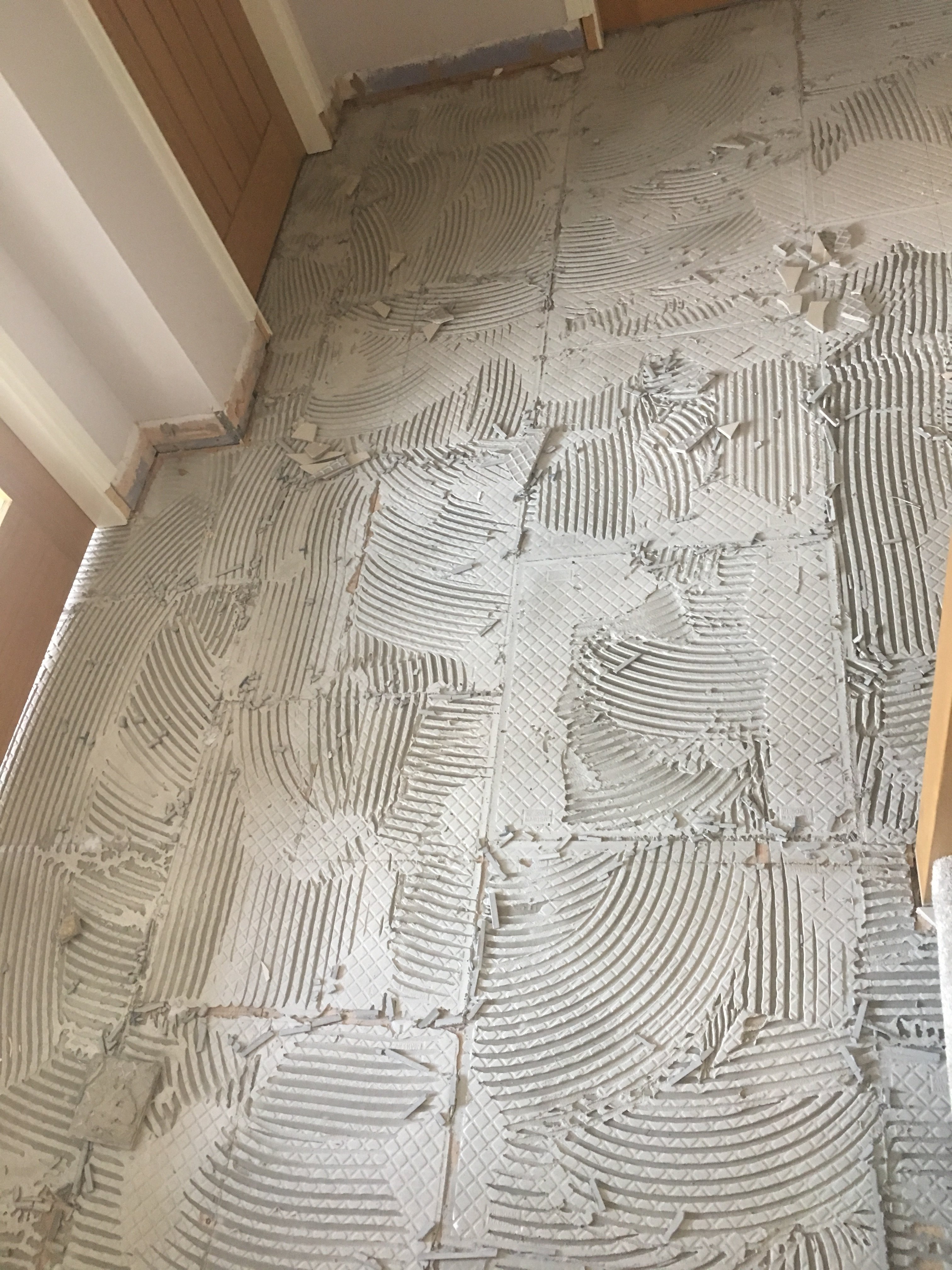

Pablo68
Here’s a picture of where the tiles have been lifted.
Dumbo
There are issues there with the tile not bedding properly. But if was a betting man I would put main cause of failure but no the only cause as a lack of back buttering the tile before laying . This helps the tile stick to the adhesive that is on the floor.

I'm new to this game but IMHO poor troweling out and a lack of back buttering has caused this or certainly contributed in a big way. I start tomorrow on a 28 sqm 600 x 600 porcelain floor (my own) so this thread has given me useful info.

I would say poor trowelling technique, no back buttering and adhesive mixed too stiff, or starting to go off.
Bathfix Bob
340
Builder went for speed and not quality by not back buttering, tut tut..anyone can spread addy and plonk tiles down but he needs to back butter and collapse ridges.
He will now pay dearly, an expensive lesson ...
