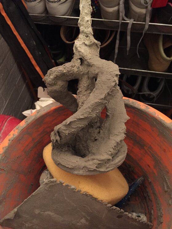

Yep!! His trowel which I assume at one time would have been a five mil notch, was down to nil mm, he may as well have just put it on with brickys trowel, but a bricky would have covered the complete tile rather than the middle with none on the edges.! His mixer was fairly new so that did not see many other jobs. His radio was spotless though!

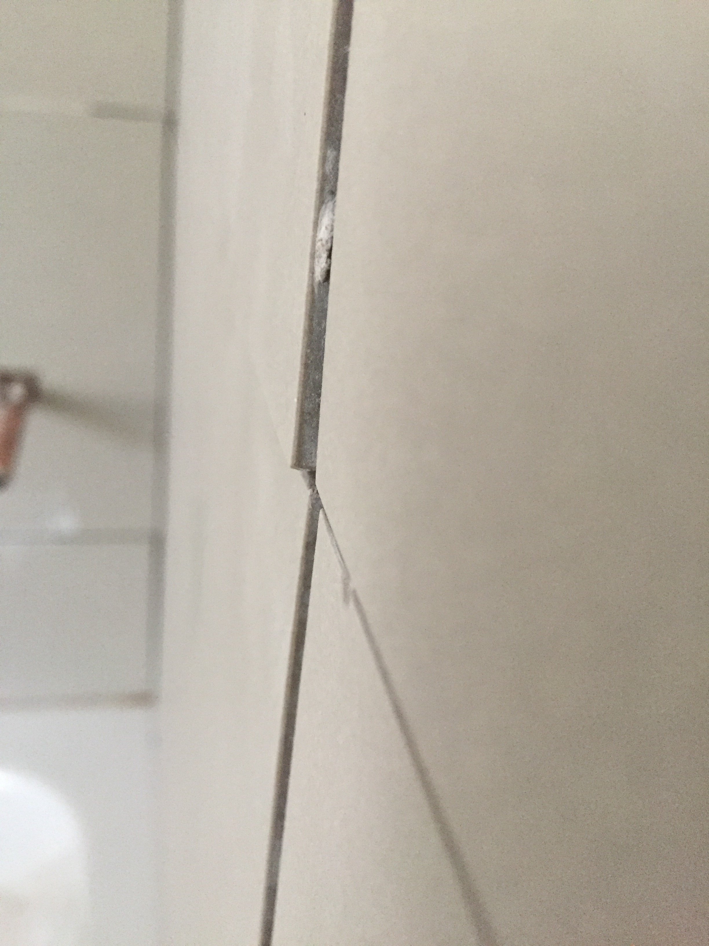

Looking at the adhesive on the back of that tile says BAD PRACTICE to me.....should be 100% coverage on the back of the tile and the substrate, no wonder it sounds hollow!.......get these cowboys out of the tiling industry
A subcontractors efforts for me!. Bearing in mind there's 6 bathrooms in this property and and 120mq2 of limestone flooring in a £3mil house, oh and is straight onto new MR board!.... #sacked!...
crikey that's some serious lippage!.....get that cowboy off site now!!!!.....' Holy smokes that is truly shocking !....shouldn't be tiling.....end ov

Quick spin in a bucket of water then a nylon brush for 30 secs after every mix (well the lad does anyway!) maybe hammer and chisel it back every couple of months. Still using the same paddle for a couple of years.

I'm not sure I understand your post. Ate you making excuses for him? There's no excuse for spot fixing.
Whoever fixes their first tile without getting your levels and straight edges out??
I understand that you can start on any wall, but as mentioned you have to be dead certain on your levels, ie you can't have a massive gap above the bath which would look like an absolute pigs ear and beyond applying mastic or trying to cut a 14mm wide porcelain tile. This geezer did not have a scooby dooo. End of. Just pity his next customer who probably won't really know what he's about. No excuses for this guy.
