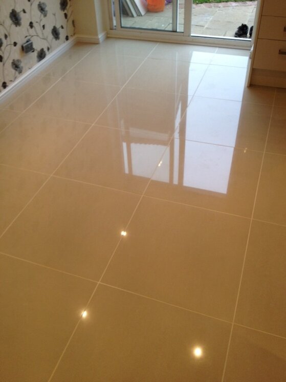

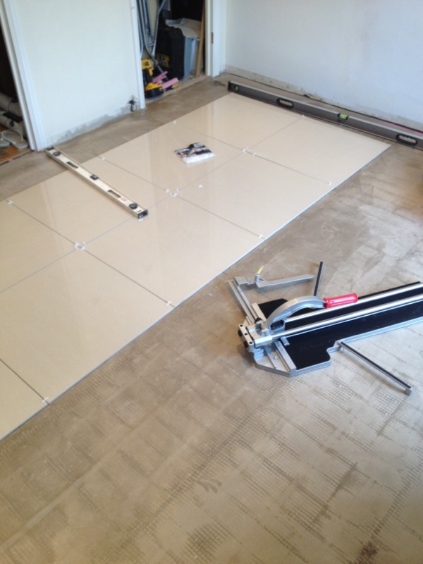

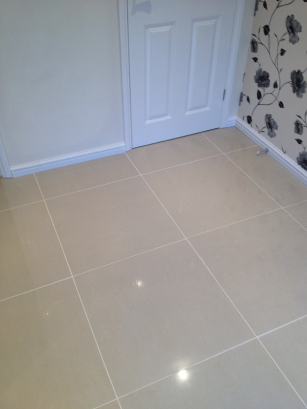

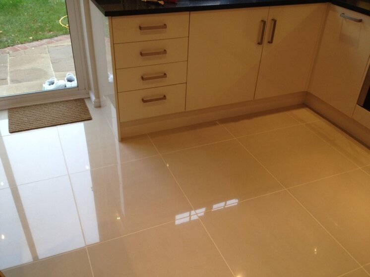

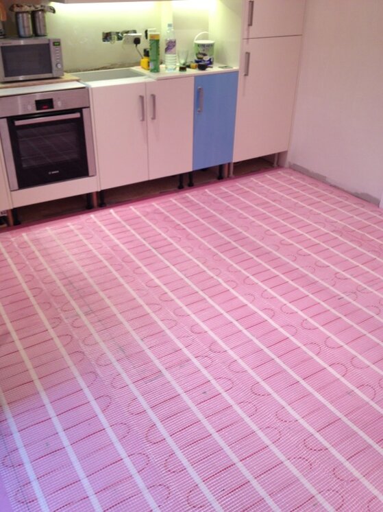

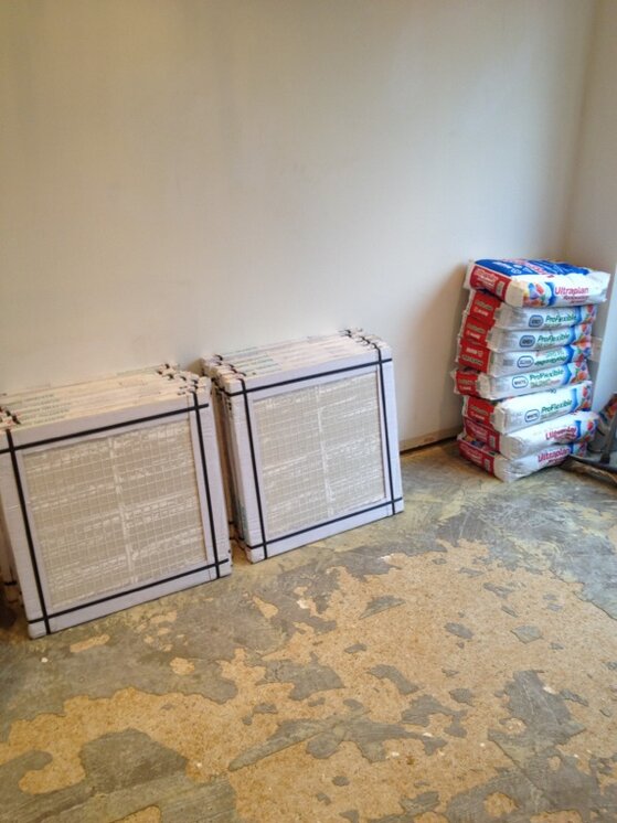

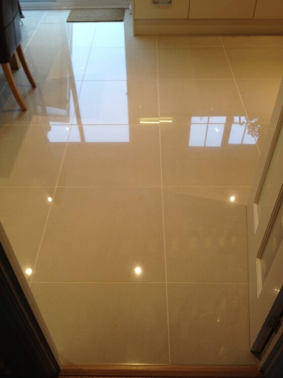

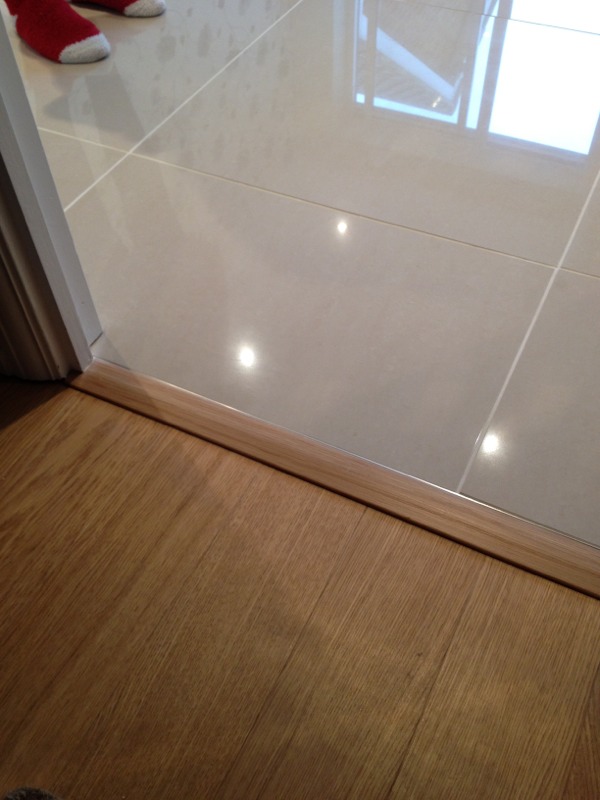

Cheers guys, never used Ultra colour, so thanks for the heads up, will get it done over the weekend and as soon as i'm done i'll stick a few pics up of before and after, well pleased with the tiles themselves, just need to get the new skirting on and jobs a goodun. . 😉
Here are a few pics guys, thanks for the help 😉
. . again sorry for the order . . god knows how to save them and upload them in an order.
