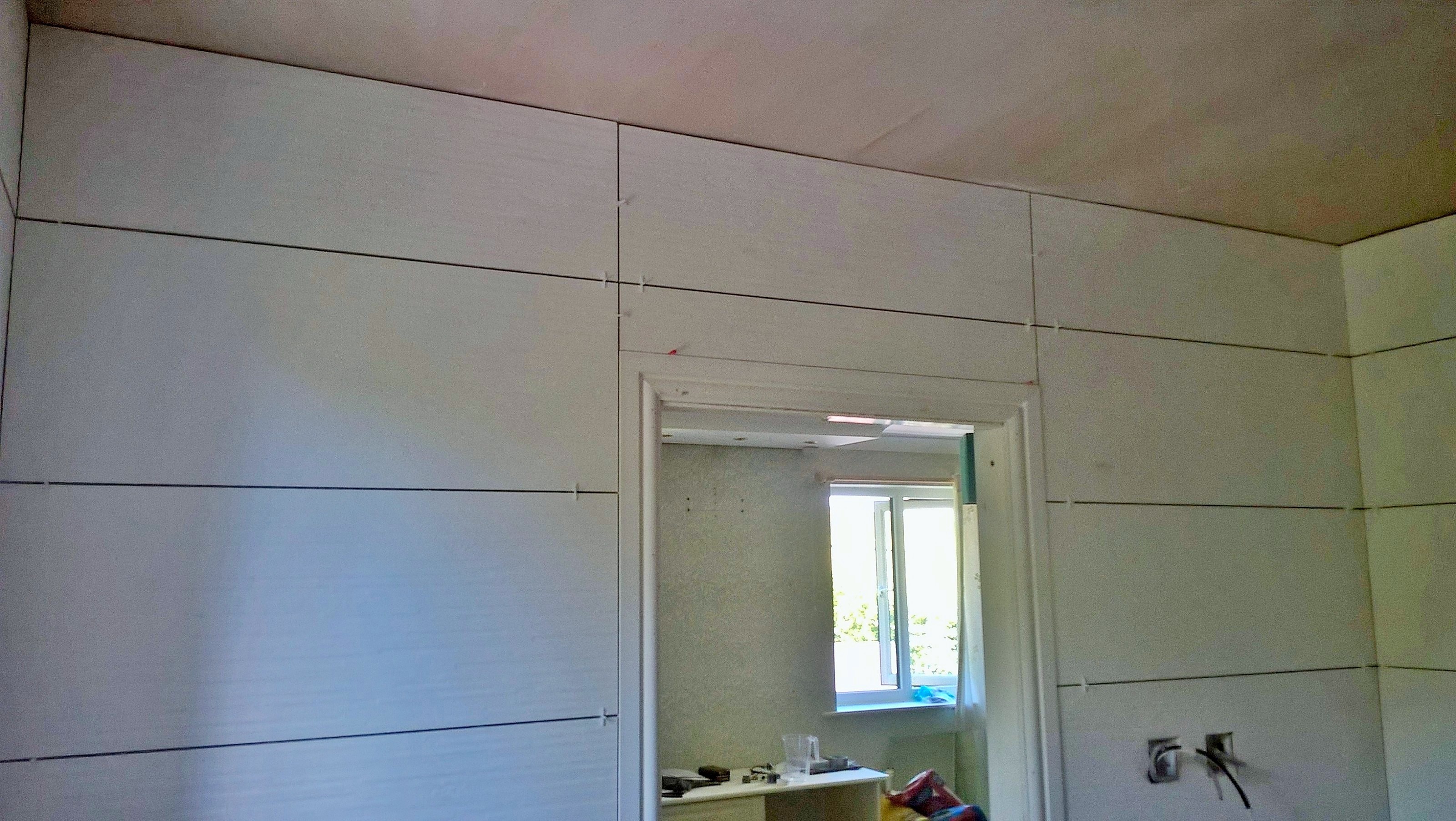

Did my first closer ever today, wouldn't even have even known about em if it'd hadn't been for this forum and a slight disagreement with Marc 😉..
Tiles 900, cut from door to corners each side 850, closer above door 820
I'm working for an ex tiler that was a bit dubious about my plan till he saw the result 🙂

Well this guy did, he more or less trained me and hasn't picked up a trowel for over two years, given the options the size of tiles and the wall threw at us think this was the best call 🙂

Architraves were infact plumb, I checked em with my new fangled laser thing 🙂 still doable though if they were out, just a bit more fannying about, first one I've had to do in ten years but will use one again if necessary.
Guy I'm working for really liked the fact they had a name 🙂
