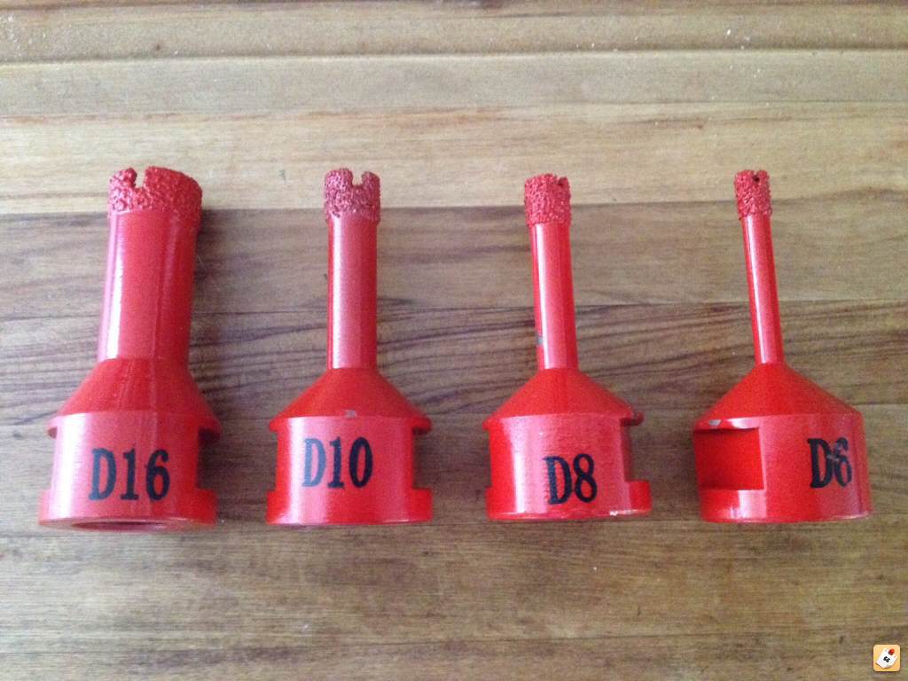

Purchased a 6, 8, 10 & 16mm diamond dry core drills the other day. They were delivered next day. I already have a Rubi 20mm core which I love, and to look at they are almost identical!
Got a whole porcelain wet room to drill. Will post pics as & when I use them next week :)

So here are the results ......
Used all 4 bits for shower, basin, cabinet & towel warmer holes.
They feel no different in use to the Rubi dry cores, if anything slightly better.
The trick I found was to rotate the angle grinder slightly as it initially cut into the face of the tile. This opens up the hole marginally and prevents chipping.
The 6mm was hard work but this was purely down to the internal hole not allowing debris/ dust to vacate the hole being cut. Fine to use , but just took longer. The others were a absolute dream to use and cut through the porcelain with relative ease.
An absolute pleasure to use and a credit to ATS for an excellent product.
Highly recommended!!! :)
Oh, before you ask.... the grout is wet where I wiped the area down & not discoloured!!!
