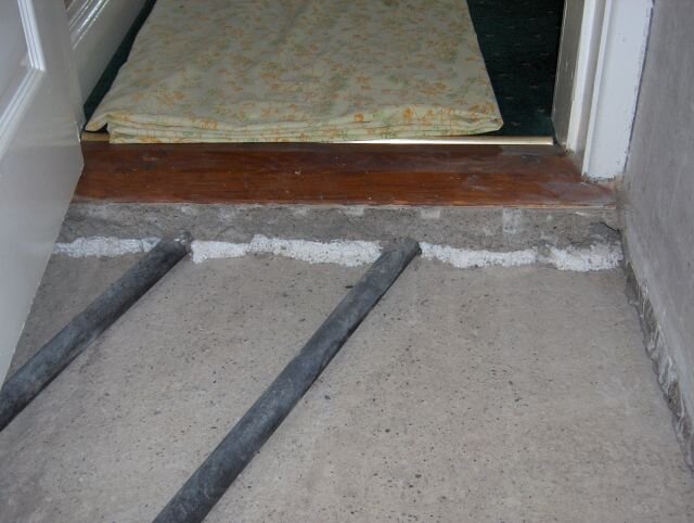

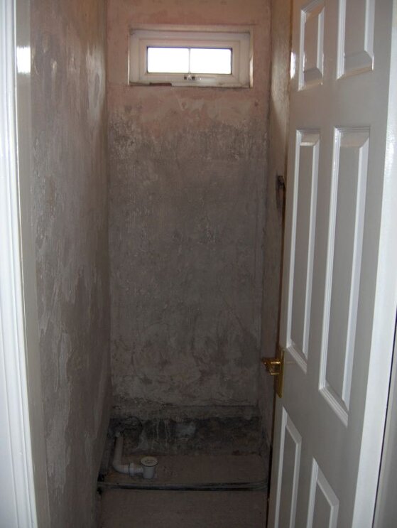

I have attached images of a former ground floor shower room that I would like to convert into a wet room. It has been stripped back to sub-floor level.
The dimensions (to the sub-floor) are:
H: 260cm
W: 77cm
L: 184cm
I have several queries I need advice on and would appreciate any replies.
I would like to use a Purus corner drain in the left corner of the room. Has anyone used Purus equipment or know of where I can locate it?
Do you think I could use the Bottom Outlet type with the existing waste pipe?
In the third picture you can see 25mm of insulation and 60mm of the previous floor. Will it be sufficient to get a new floor poured with a slope towards the left corner of the room? What depths should I be lookin at getting?
