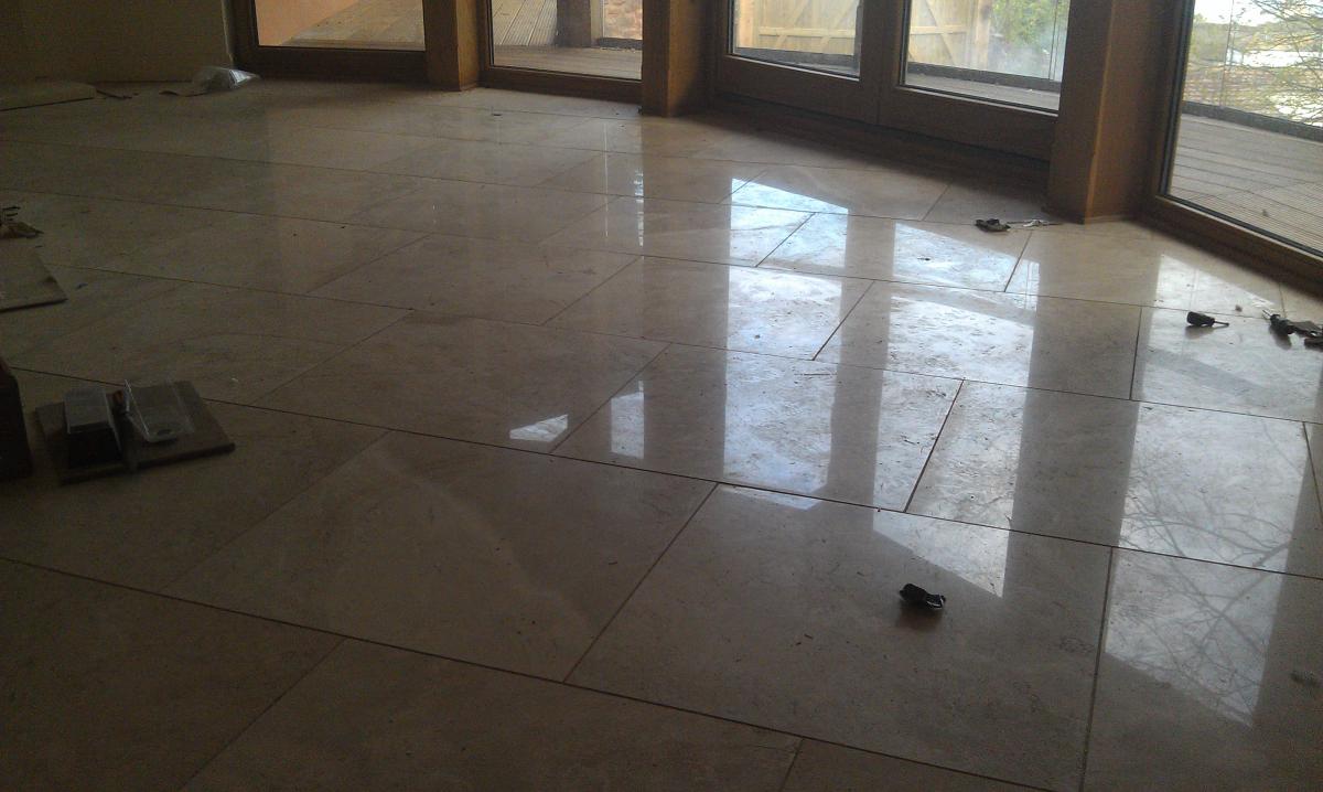

Sorry about the pic, its a bit rubbish. This is the worst effected and largest area. The customer wants it to have a nice clean shine throughout. The previous tiler says its been sealed but hes left a right mess behind. The sealent wants to be removed and the tiles cleaned up, then sealed again.
