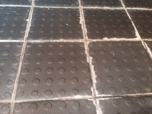

This might have been a bad choice of tiles and I don’t think they were installed and grouted very well but the lack of care and maintenance on my behalf has not worked out too well.
We live in London and the water is very hard, so lime scale deposits and build up is bad. I am going to install a water softener to try to help with this a bit.

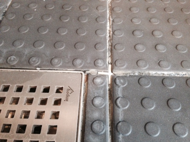

The grout on the floor is starting to break away and the tiler left the spacers in so it is all a mess. I am now getting the floor re-grouted by another tiler.
This was what it was/is like.
I have managed to get rid of the lime scale so the tiler can re-grout – this took patio cleaner, VERY stiff brushes, a grout saw and a lot of time.

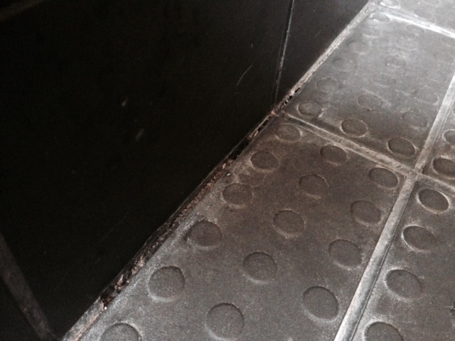

- Even though the tiles have been cleaned, some have a milky finish and stains on them (like this before I did the big clean up). If you wipe the tile with a damp towel, then finish is nice and dark, with a slight shine and the stains are gone. But as this dries it goes back to how it was. I have researched on this forum and there are many different products. I am just a bit confused as to what I could use for this type of staining? Maybe I need Deterdek?

- Last question... I promise. Should the previous tiler grouted the join between the walls and floor? The guys who is about to redo this has suggested not grounting this and sealing with silicon or similar instead as the grout might crack again due to the movement between the two?
