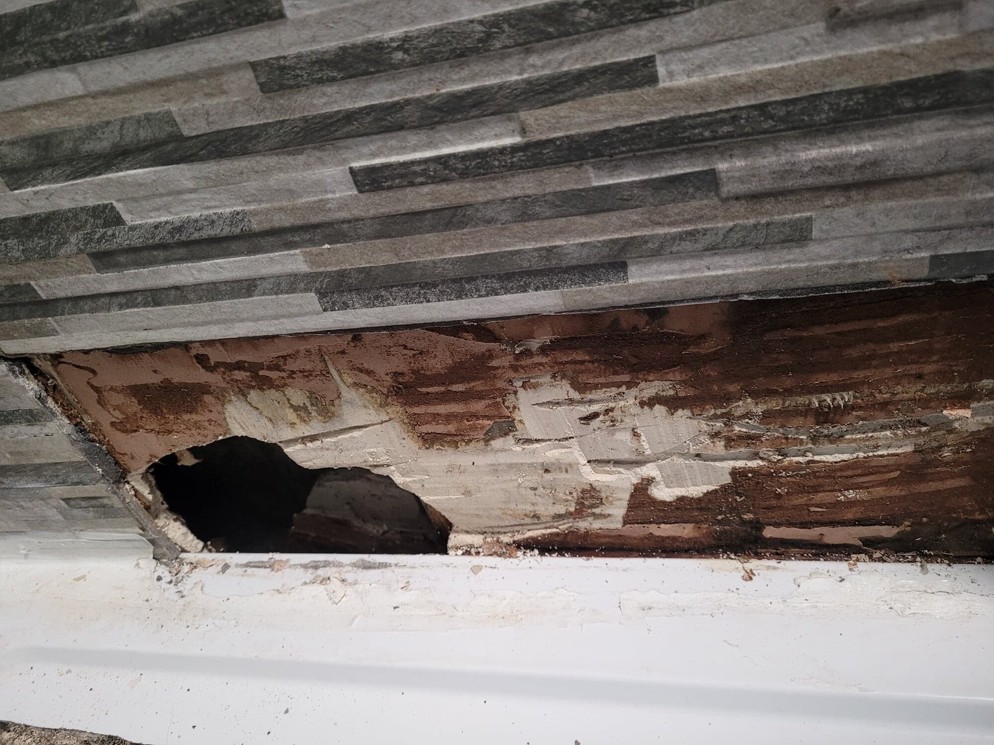

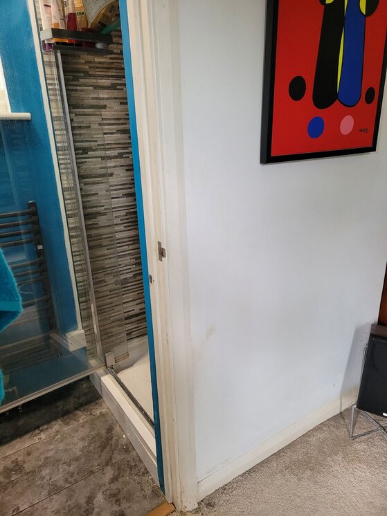

We paid to have a new shower room installed just over 2 years ago. They fitted a false plasterboard wall in order to make a smaller shower base fit more easily and then tiled straight over the plasterboard. Recently some of the tiles have fallen off the wall (600x300). I removed the front of the shower base and could see that the plasterboard was soaking wet. He clearly didn't treat the plasterboard before tiling straight onto it and it is now rotten and crumbles away in your hand.
