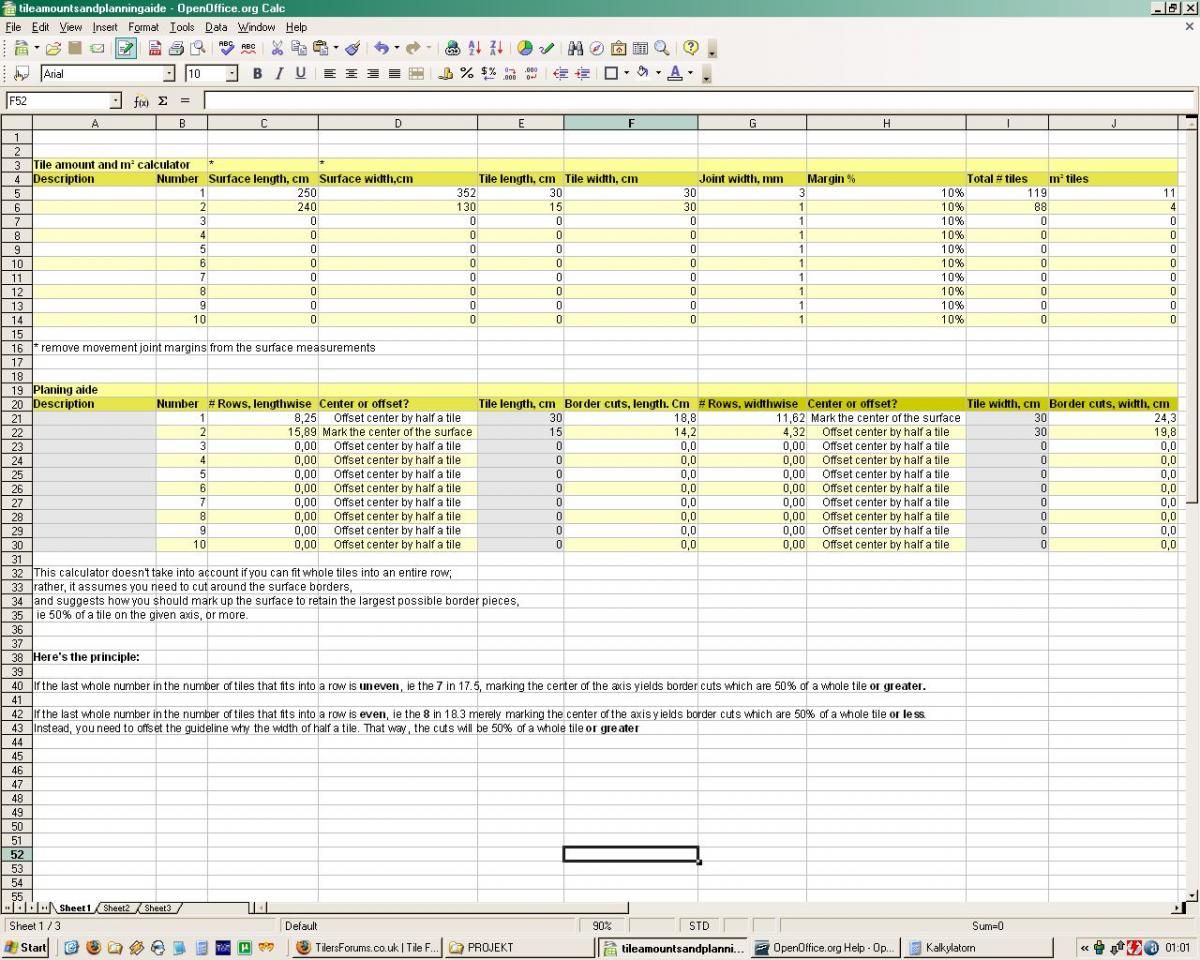

I had an hour to spare, and I was bored, so I sat down and did a tile amount calculator (number of tiles, m2s, margins, etc etc). While at it, I included a planing aide (for educational purposes), which suggests how you plan a generic surface given the details you enter into the calculator.
I can't guarantee that it's error free, cuz I couldn't be arsed to check twice :lol:
Making it kept me amused for an hour or so, but now I'm bored again :yawn: :grin:
Cheers.

I had 20 minutes to spare so i had a play with swe's tile calculator, great calc by the way swe.
The tile calculator will now give a price for the tiles and an idea of grout needed. Plus a couple of other bits to give a total price for the project.
The wife was happy to see just how much it was going to cost me to tile the utility!
