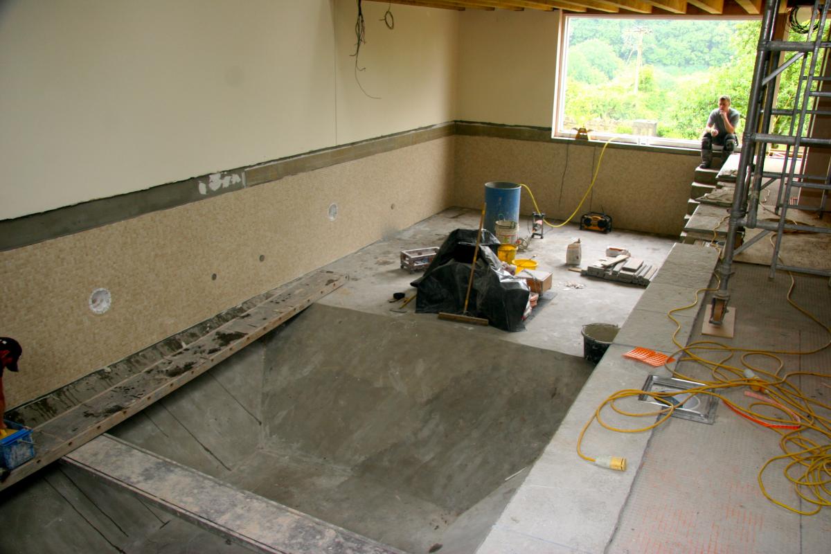

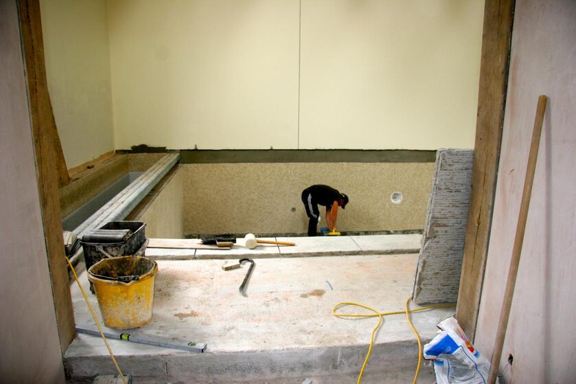

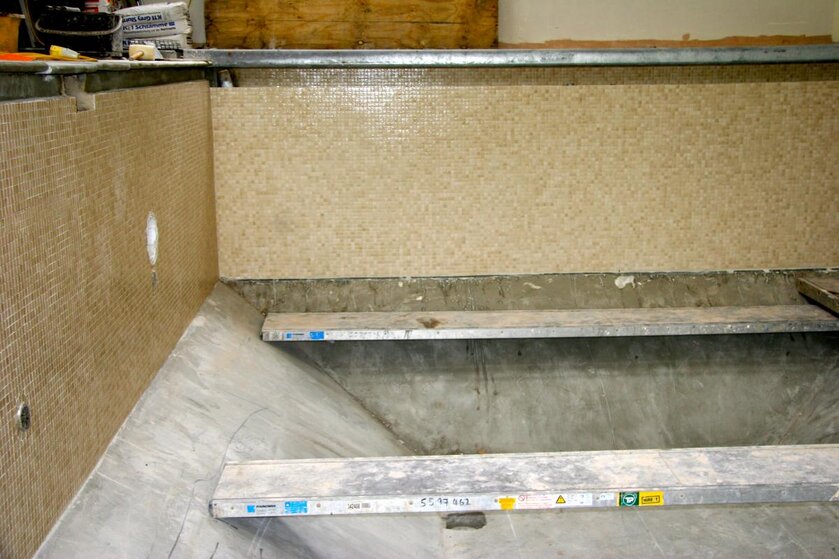

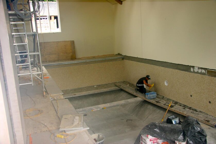

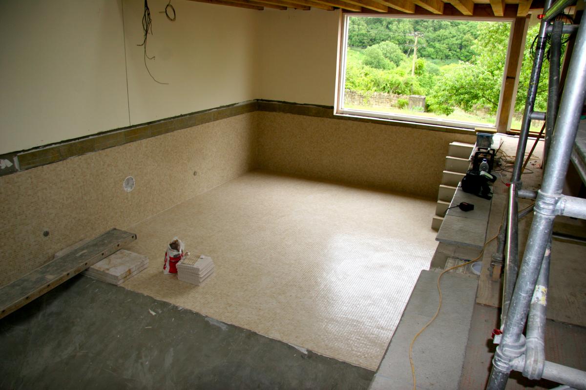

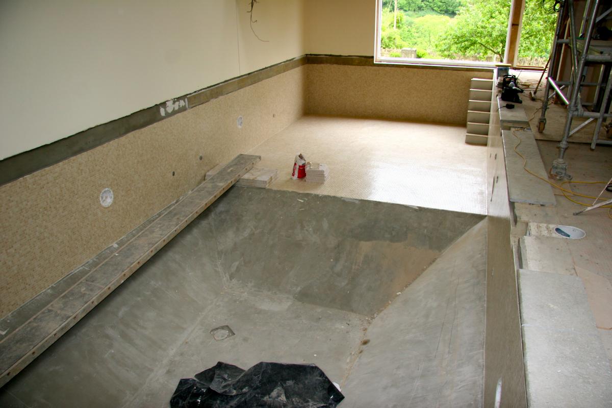

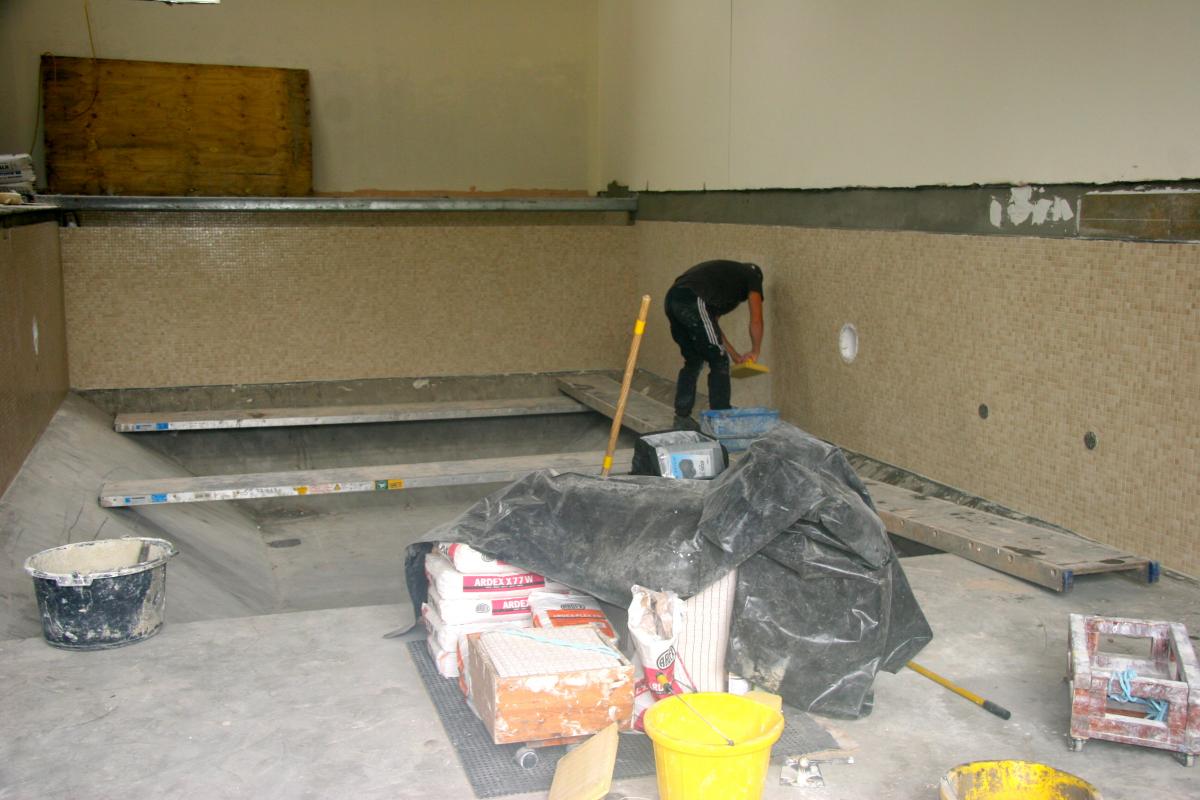

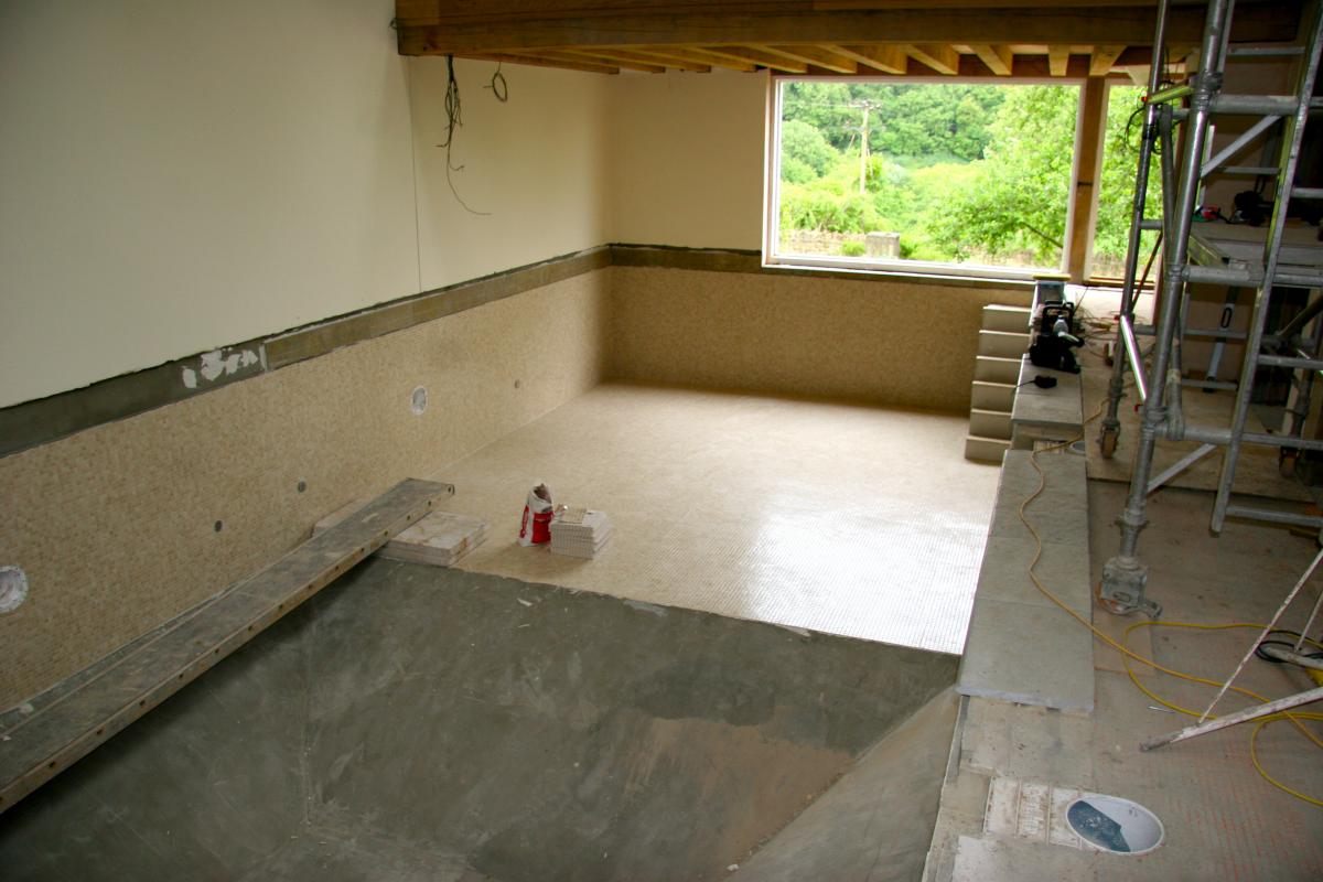

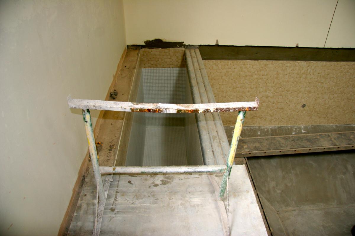

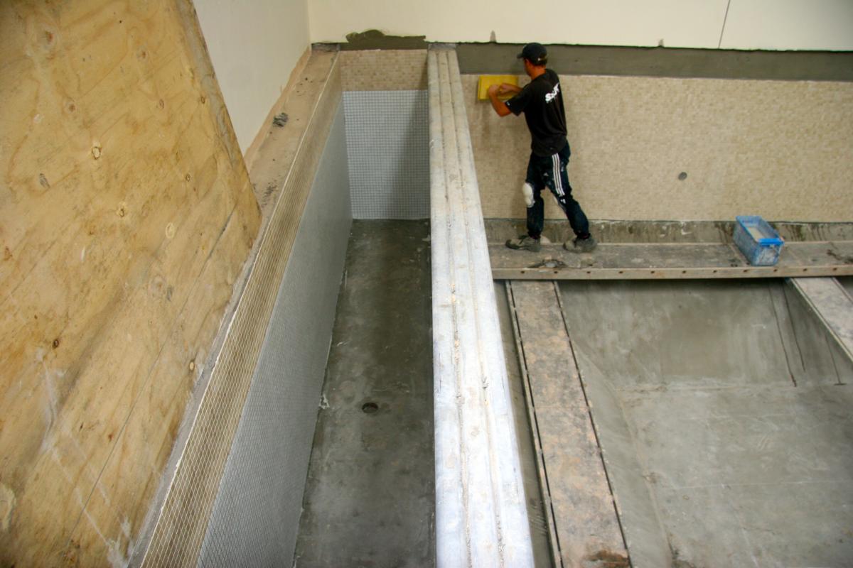

Sorry mate missed this post, well john it's called a roller-pit and as the name suggests its where the pool cover retracts to when the customers press a button to use the pool, it will have a few SS access panels that will all be filled with the same stone as the surround and form part of the surround as well, the front of the metal beam will have the stone across the face forming a letter-box that the pool cover will automatically go in and out of to cover the waters surface, the dividing wall between the pool and the pit is called the bund wall, most jobs just the top 30cm are mosaic tiled just in case anyone peers through the letter box, but on this job the whole interior has been done, once finished they are very seldom opened ....... hope this helps , if you want to know more just asknice work, look forward to see the finished pool. just as a matter of interest, what's the separate bit at the end for?
