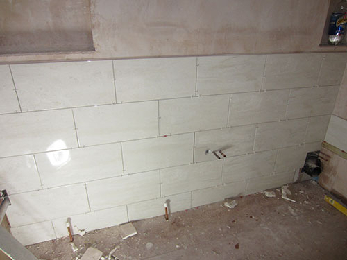

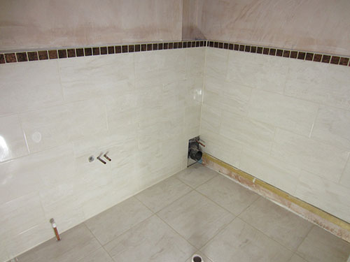

as usual the prep was "okay" ......but "okay" is not good on all new work!!!!!!!!!! bowed walls n'all........

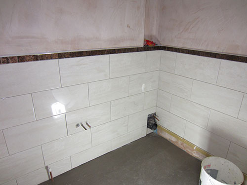

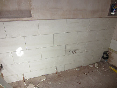

so in the afternoon (monday) I tiled this......battened up and went home.......

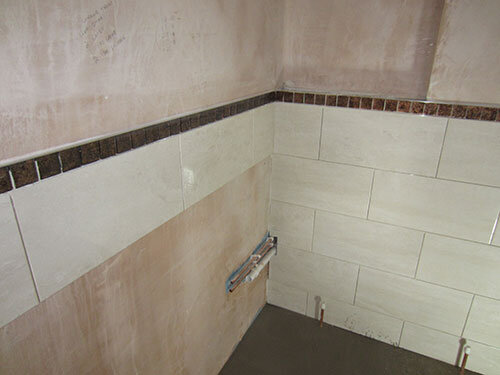

Now......because the walls were bowed the tiles were not dead flat against the wall at the top......and there is to be a mosaic datum...DOH!....
so i created a "dog eared float" and primed the wall with adhesive to take up the difference!!!! (wall is bowed and mosaics are thinner than the tiles):
that ends up like this:
then I continued fitting tiles:

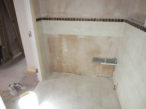

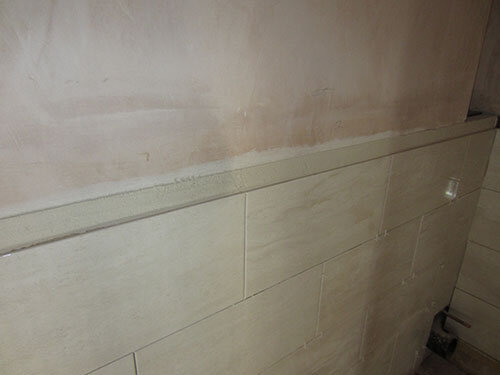

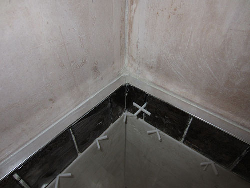

and ontop of all that nonsense........that mosaic datum had to be TRIMMED.........the client does not want to see the edge of the glasss!!!!.........OMG......
so there you go..............mitred trim ontop of mosaic...on a doddgy wall..........

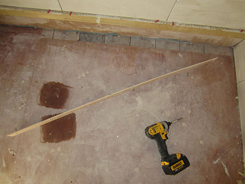

this Disabled toilet I am working on has a 6mm ply overlay.......like this:
when I refused to tile over it....the site manager went mental........but I have recently noticed he is a bit mental, uneducated and worst of all GINGER!!!!!.......hehehehehehehee...just kidding...

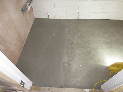

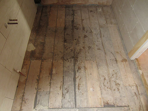

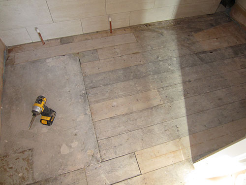

so I pulled it all out.....and exposed the floorboards.....SOME OF THEM WERE NOT EVEN FIXED DOWN........AT ALL!.......so I got out my impact and went to work...
After fixing them down I put Silicon between the floorboards..........

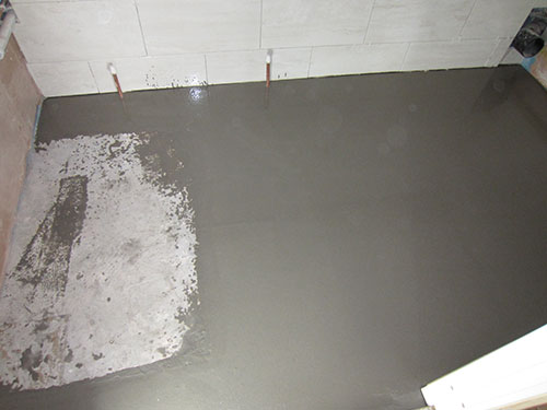

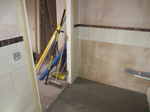

then I screeded the floor....avoiding the concrete part........its a disabled toilet......so I need minimum height issues......
after checking I needed to screed back to get flat and level...................wonderful......
as I left today it looked like this:

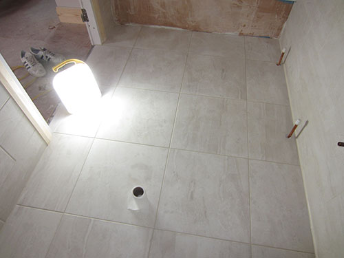

in amonst all the other stuff I have been upto.......I finished that disabled toilet last week.....here are the piccy's:

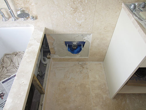

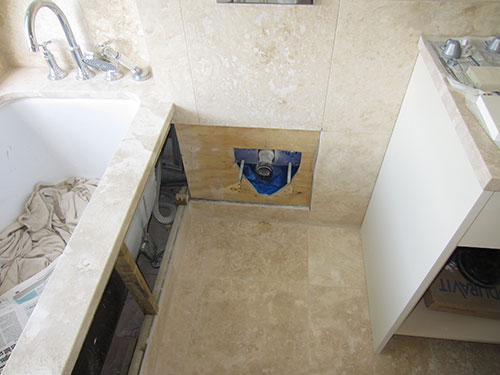

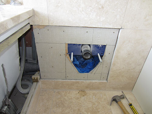

anyway.....first thing monday morning (this week).....the plumbers have left me this:
they smashed off the corner tile and broke the one behind the toilet (but could not get it off!!!!!!)......
so a fix is needed:
tile removed...
hardibacker removed....
new hardi in......best biut I had lying around!
fixed...........whhhhoooooo....I love mondays!!!!!
