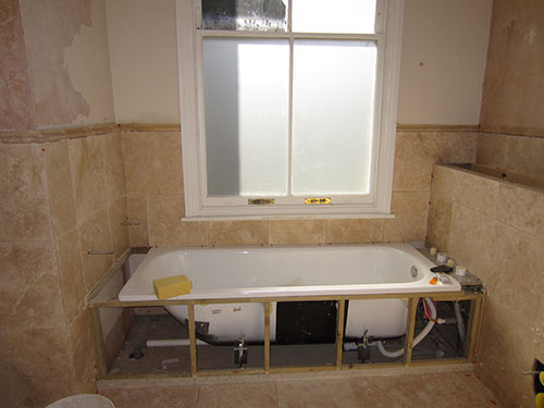

Because of Deano's post.....I will make the effort.....here is the latest:
Evening all.....

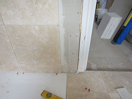

this wall has been a real pain.....I have had to float hardibacker....and then..in the last 300mm i have had to "bob" out the hardi with adhesive to get it flat....and I know that you cant stick hardi with adhesive!
so once it was "bobbed in place" I have screwed it also.......

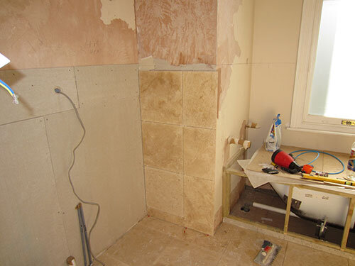

while that was drying I tiled this part:
Then to stay flat on the "problem wall"...I had to screw hardi to hardi..........Like this.....
Sorted!

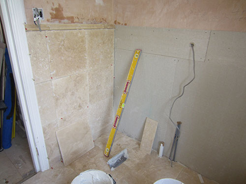

Last thing I did today was this mitred corner.....

Why mitre the corners? Is the stone not good enough to take a polished edge?
Hi, well agree, no need for mitre corners some times( for steps, bath tops, vanity tops etc) but bathroom walls, to me -must be mitred all external corners, it looks so much better. It's only my opinion :thumbsup:
I completely agree if it means you can do away with tile trim, ceramics, porcelain etc. But on a sedimentary or metamorphic stone of any variety the finished edge of the mitre would be so fragile I think you're asking for trouble long term. A polished edge would be harder wearing and far easier to repair of damaged at a later date.
All very personal though as you say.
I agree polished edges are "stronger" than mitres......but the trav I have been working with over the last couple of years comes from Turkey and is really weak.....loads of holes..it breaks in your hand...
getting a mitre off without chipping is hard work....polishing is not worth my time or the contractors money IMO.....

here is what happened today:

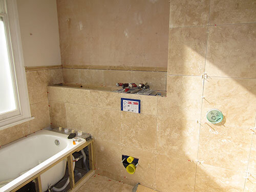

first thing this morn a bit more stone turned up......here it is installed........:

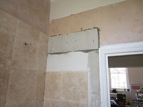

then I needed to deal with the PU foam wall......here is how that ended up:
you can see the problem......where I reboarded the wall I have ended up proud of the architrave.....not to mention the wall is leaning away from plumb.......
I need to adapt and overcome here.........
so I cut up some dados and made an edge!

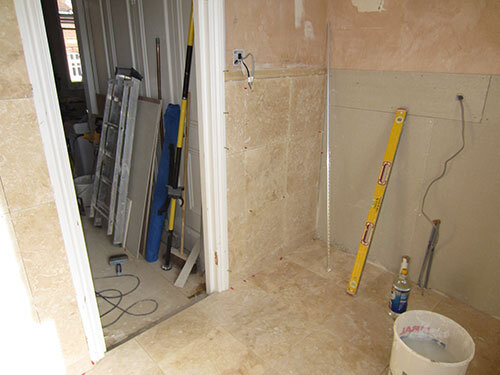

other than that this bathroom is tiled:
