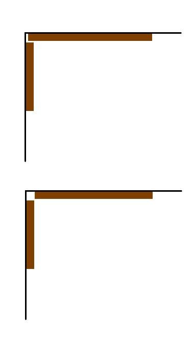

Oh I kinda understand what RichieHall means... say you have a tile of 9mm thick and lay it just 3mm off from the wall. When you lay tiles on the other wall they will overlap slightly. You will still have a 3mm gap but overlapping edges. So you need to leave a gap of the tile thickness first plus the 3mm
hang on, ill do a dodgy MS paint picture :idea3:..... am I being a tit / teaching you to suck eggs? sorry of so, its not intentional just making sure i've got it right as if i never read this thread, I would have grouted! :44::dunce:
I see what he means, but if a tile is, say, 10mm, you would leave that tile 2-3mm from the wall and then the tile that butts into that one will be left 2-3mm away from that one not the thickness of a tile plus 2-3mm. Basically, you want a 2-3mm gap between tile and anything else.

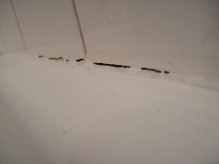

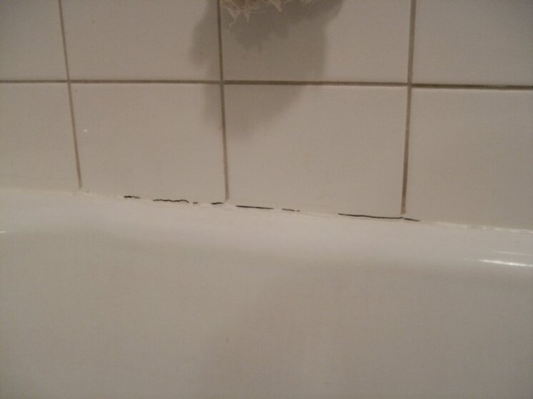

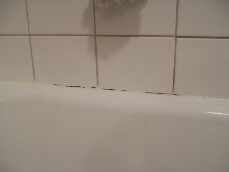

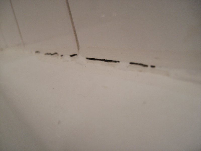

Here are some pics of the Silicon in my mothers bathroom, the joint between the bath and the tiles was grouted and then siliconed over the top. You can see in the pics that the grout has cracked and lifted the Silicon away with it, leaving a gap for water to get through.
Thats a great advert for never grouting then laying silicon on top!
