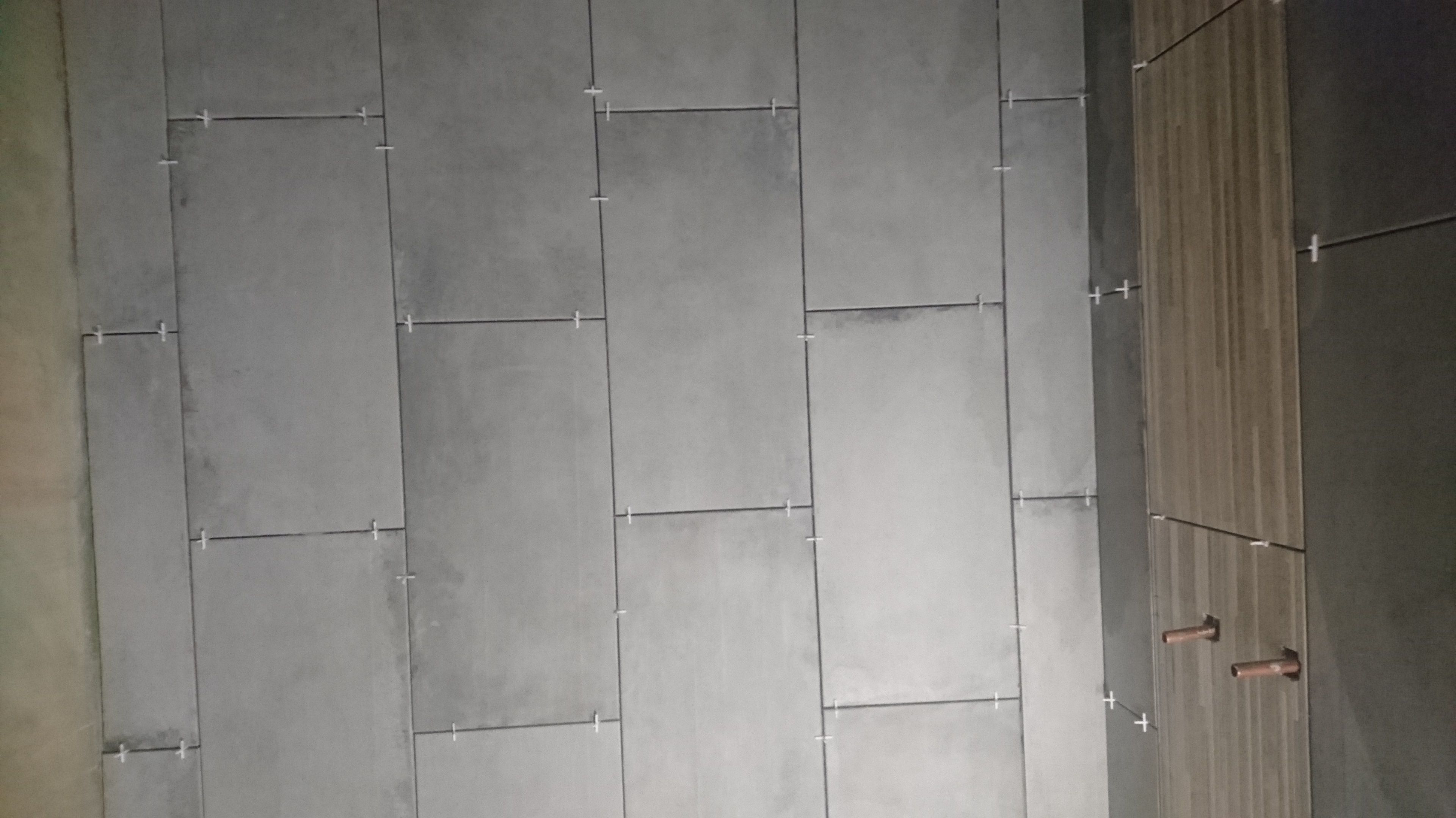

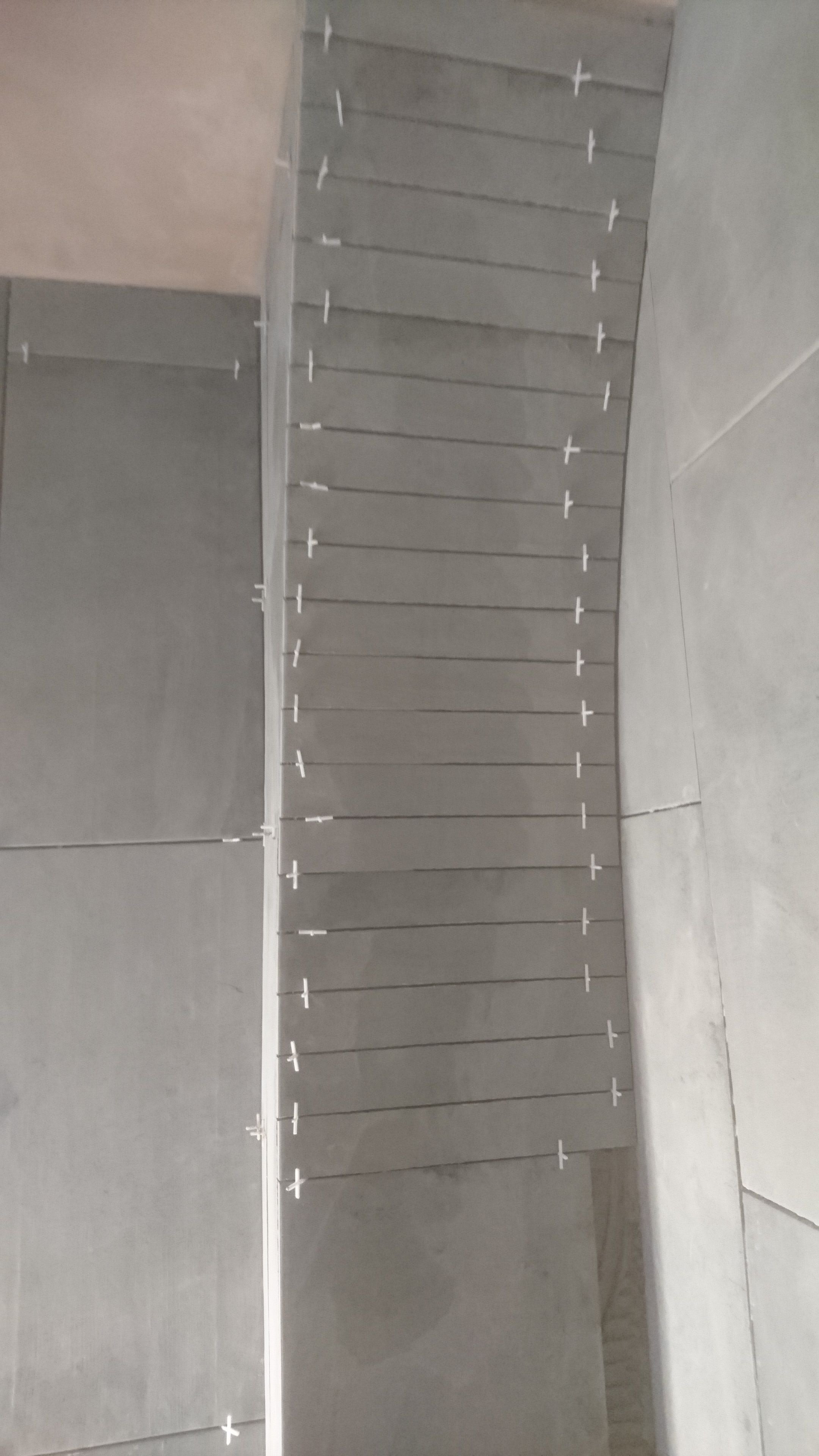

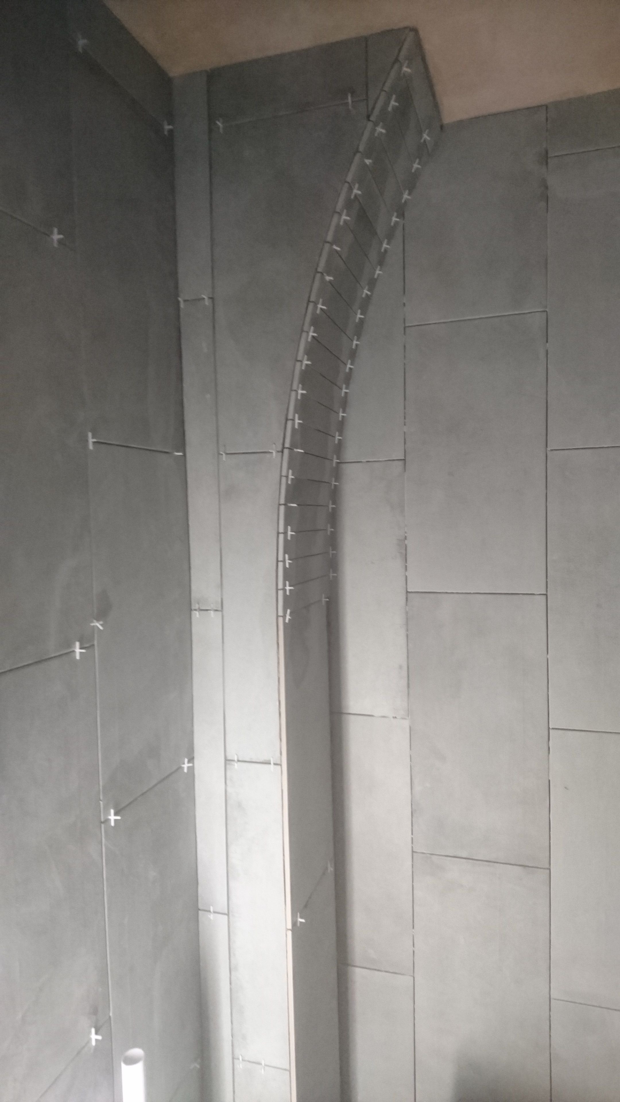

yes that's the method, pointing gun into joint and clean of with a trowel, will have to leave fairly flush as slips are only 20mm at best.
had to us rapid set adhesive, customer supplied TM slow set which I could use. Had to mix thick to hold the weight and adjust as they set, would of been all night with slow set.
fixed hardie board to the wall, glued ans screw, as it was paint plaster.

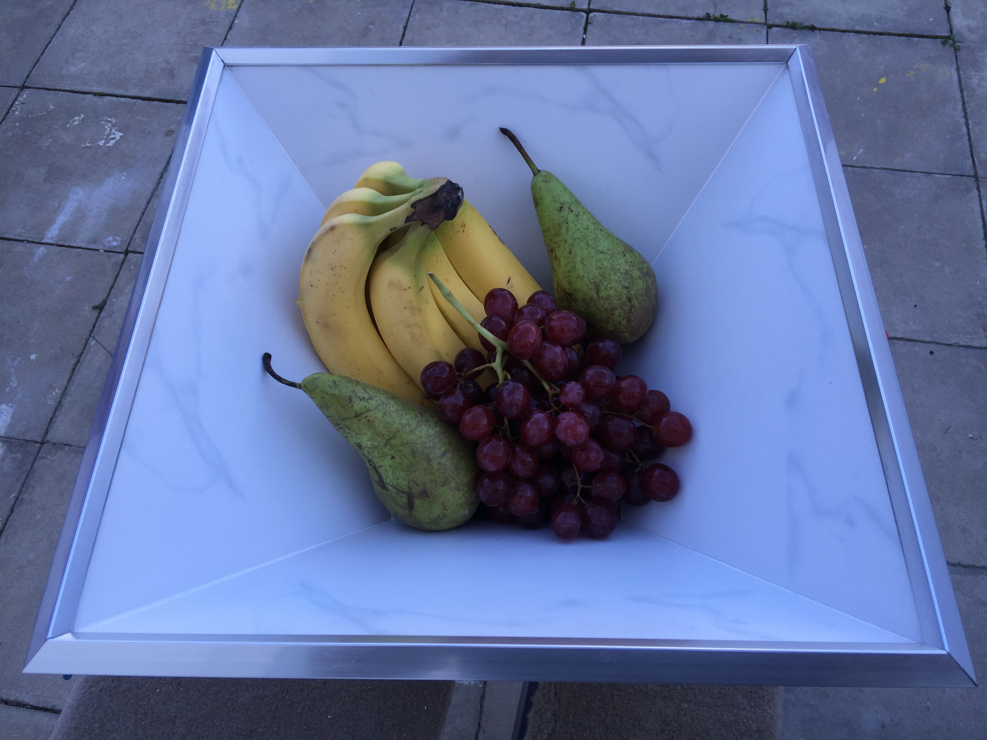

Limestone pathway finished todayView attachment 82059 View attachment 82059

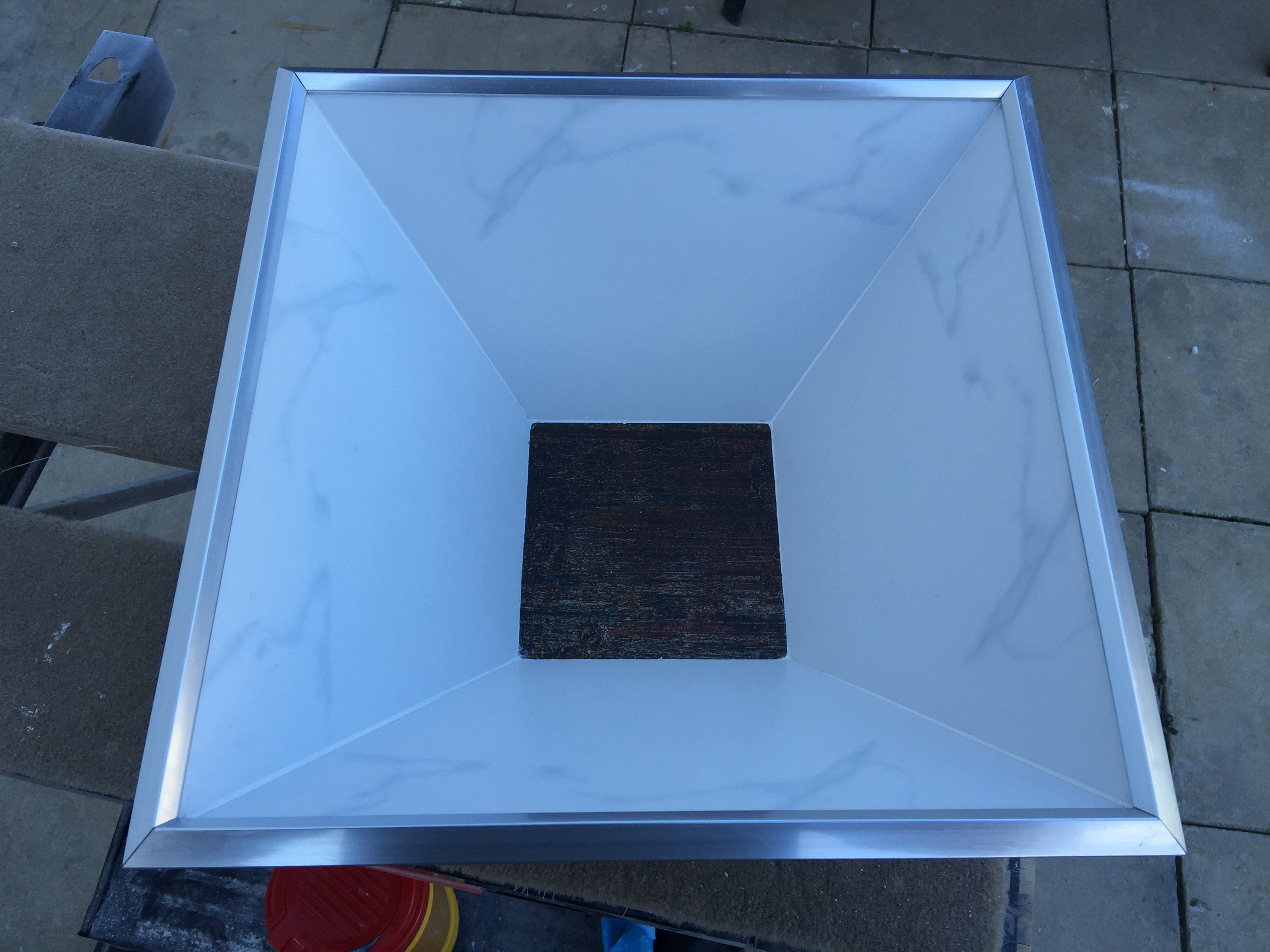

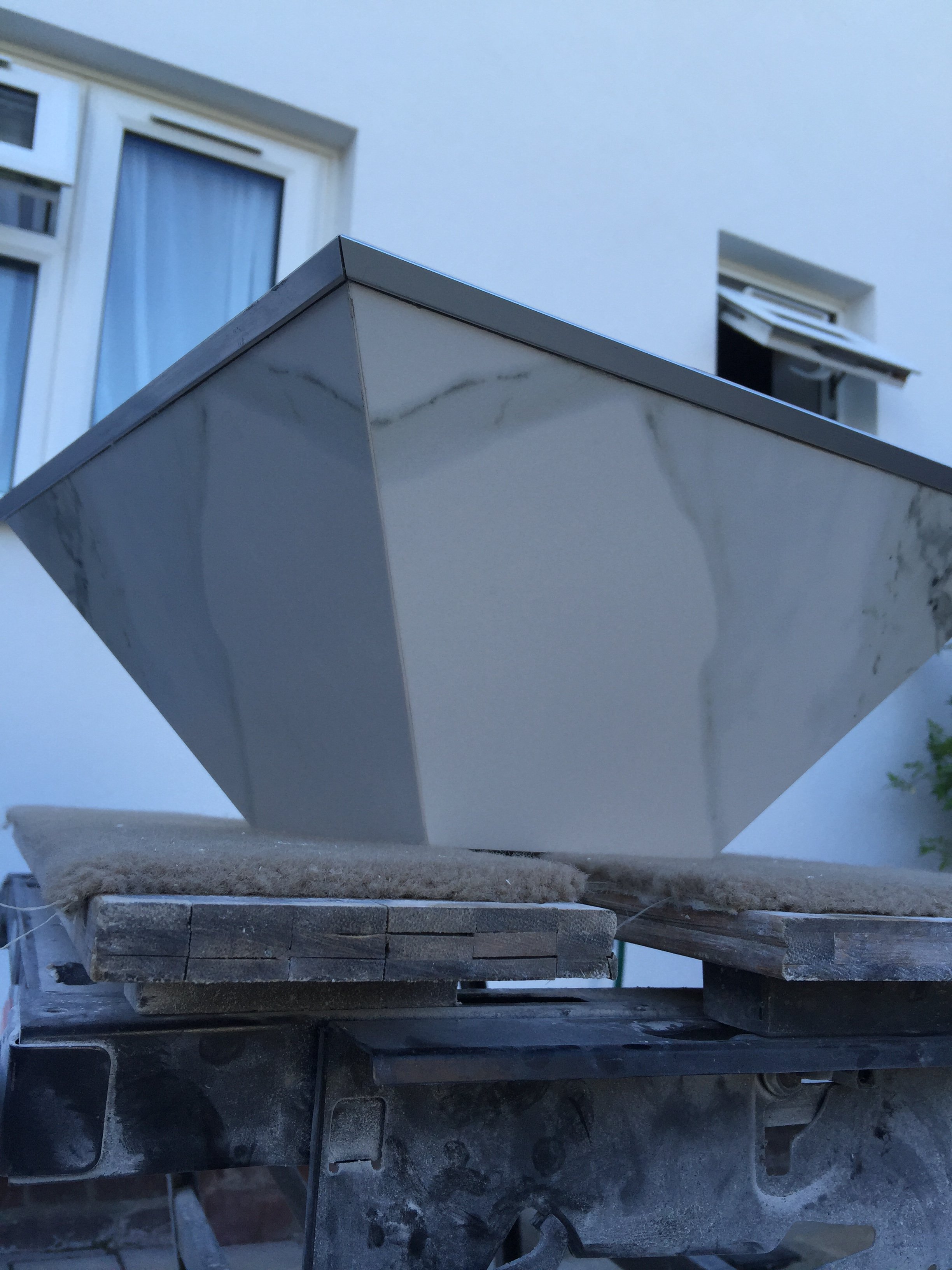

I had some spare triangle pieces spare from bookmatch job as as I can't bare to see waste......
Put this together, with the suggestion of u channel from Gary.
8 triangles back to back, with 3 mitred sides on each.
Glued with Akemi.
Hardest part was rebating the top edge by hand to accept trim as it was just a tad too tight to fit over top.

Very nice, don't let ray see it, he'll be branching out 😉

good marc

very nice marc🙂
but come on, you get a day off and you just can't leave them bloody tiles alone, your poor Mrs 🙁
