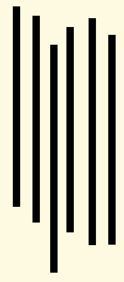

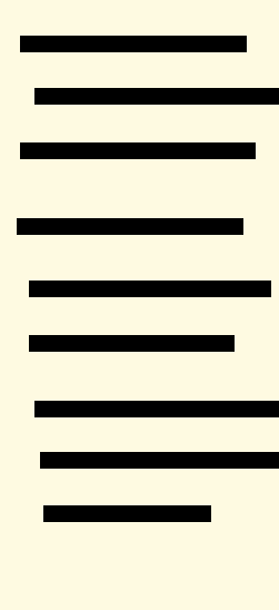

Just so I Understand, should the trowel serrations on the tile run the same direction as in image one? or like in image two? (serrations on back of long tile)
Concrete floor is 25 years old so it better be cured! Thanks!
Trowel in the direction of image 1 on both the floor and the tile. A flat skim is when you use the flat side of the trowel where there are no notch’s to spread a thin coat of adhesive to the tile to insure good adhesion, if the floor is relatively good this way is sufficient but if you notch skim the back of the tile it would allow for more discrepancies.
