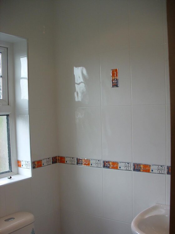

If you want a perfect edge, I use a makita tile/glass cutter, the blade is 80mm so will cut the short side too from the face, I used it here to insert one of the borders as a decor tile,invaluable for certain jobs Tiles 040.jpg
