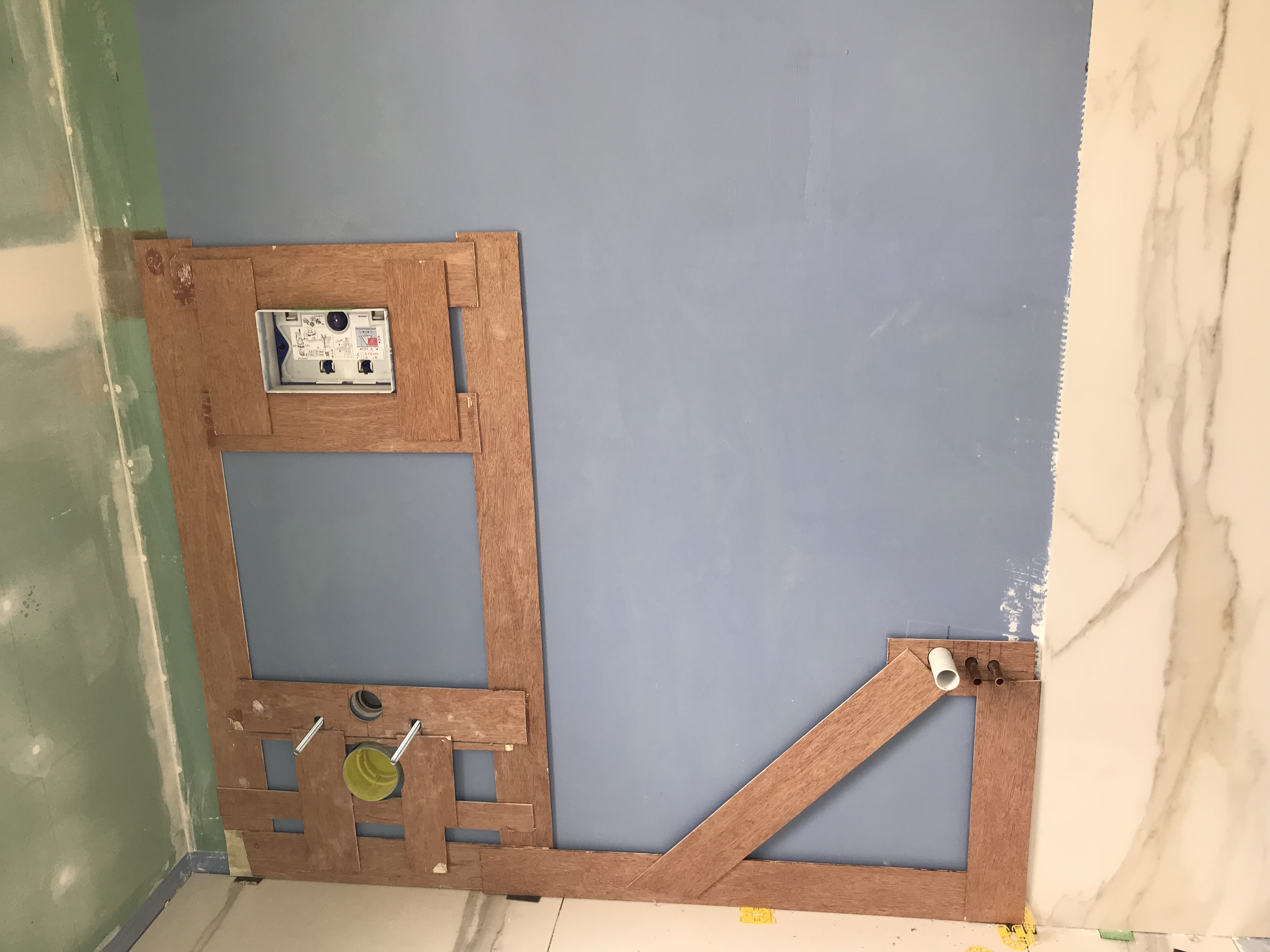

Hi Guys
Needed some advice on cutting in my Grohe Raipdo rough in smart box which essentially is the back box for the front end shower valve controls that sits on the finished tiled surface.
The box is actually circular with a 138mm radius and it sits behind the tiles and when laying the tiles you need to cut in a hole between 138-142mm, trim the box so it’s flush with the tiles and then lay the Grohe smart control plate on top.
The problem I’m having is sourcing a 140mm tile hole saw to cut into tiles. I have found one one amazon but it needs a tile guide and cannot find tile guides that accept 140mm hole saws. I also found another hole saw on a web site called Starrett which is a Diamond Ceramic and Abrasive Material Hole Saw but is around £140 when you buy the arbour.
Has anyone installed these type of rough in boxes and can advise best approach with marking where to cut and where to source large hole saws for porcelain.
